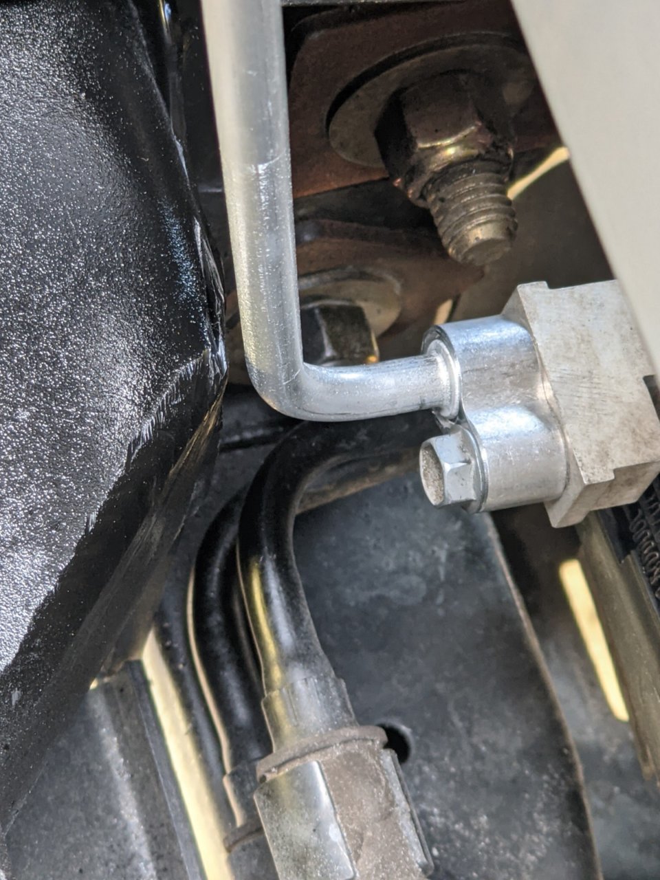

    I installed my Demello offroad bumper about a year ago. I recently lost my AC. I didn't put 2 + 2 together, so I took the truck to the dealer assuming it would be warrantied work. $165 later, they noted that an AC line was damaged from the front bumper and that it was my responsibility. They wanted $900 to replace the AC line (hahahaha).
    I ordered the replacement line myself for $65 online, but I digress.

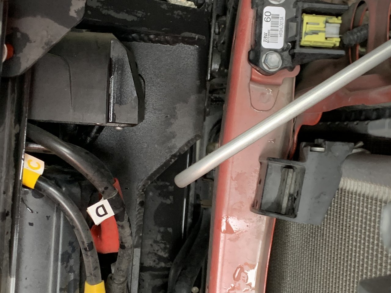

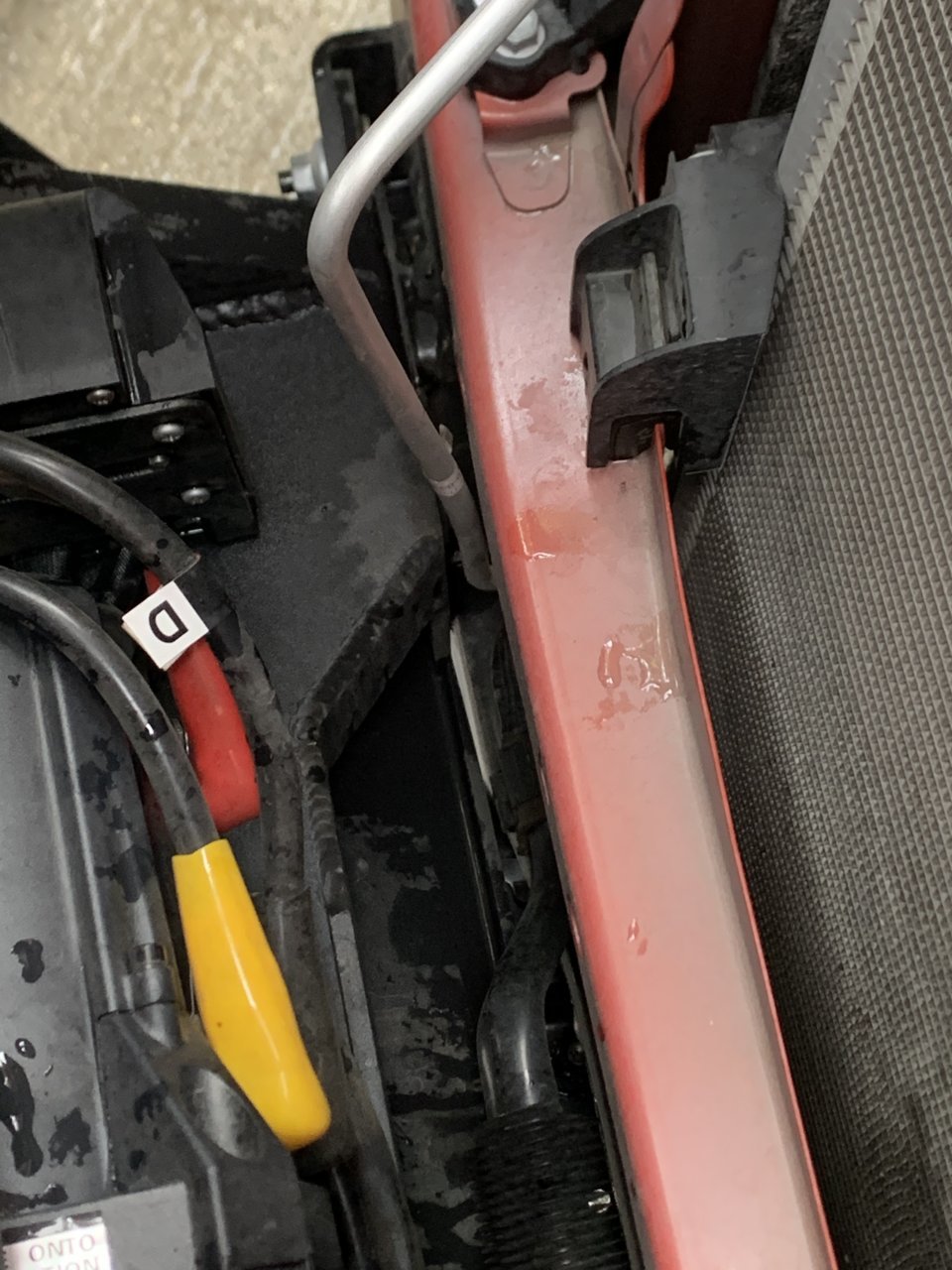

    As soon as I pulled the grille, the problem was right there in my face. Even though I bent the AC line initially during install, it had enough give to settle right against the bumper. Oh no. Oh no. Oh no no no no. It took a year to wear the pipe down and cause a tiny leak.

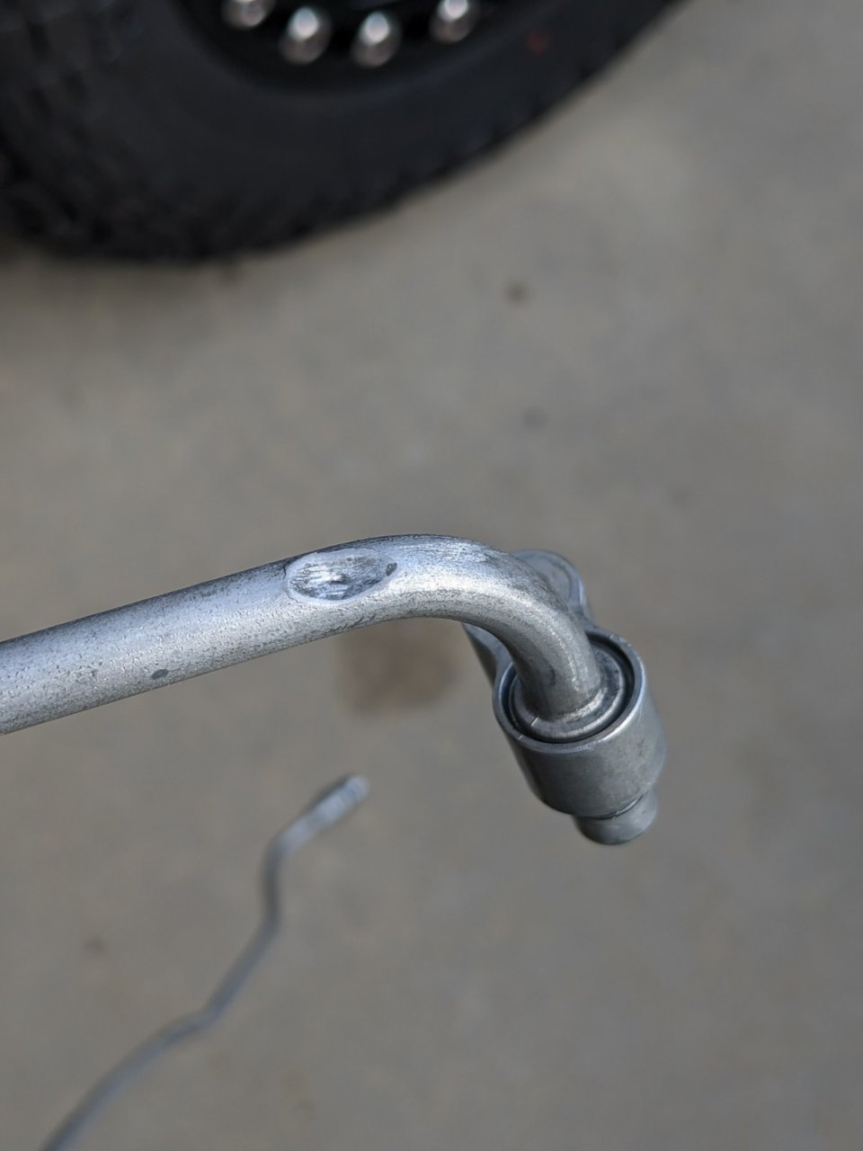

    I pulled the line and cleaned it up, and sure enough after close inspection there is the tiniest of tiny pinholes dead in the center of the line where it rubbed the bumper. It doesn't take a big hole at 200psi.

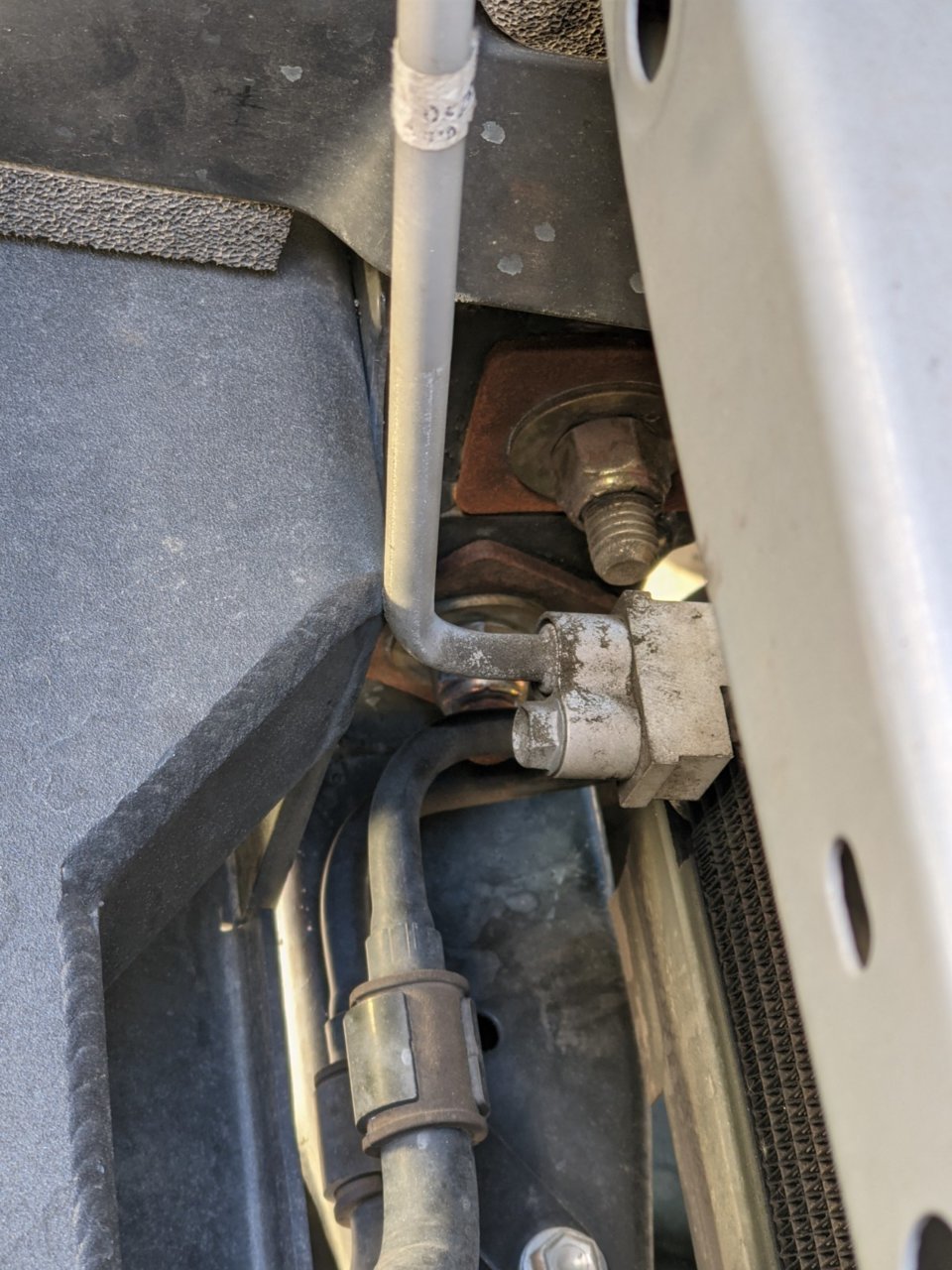

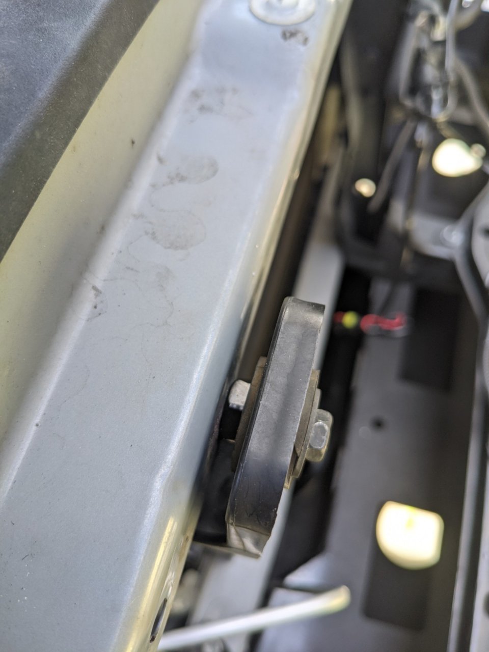

    I did a few things. I ground the bumper down in that area with a dremel, and I used some nuts (maybe 8mm wide) behind the evaporator mounts to tilt it forward and away from the bumper. These changes afforded about 2-3mm in clearance to the new tube. To their credit, Demello's instructions do say to be very careful of the AC lines and to gently bend them during install. I highly recommend doing what I did- there's really no easy way to bend the line away from the bumper because of the prebend there already near the connector. The bumper would ideally just have more clearance in that corner.
    Here's the nuts behind the evap mounts.
    Here's the new AC line also showing the bumper ground down in that area (and hastily painted so no raw metal). There's a good 3mm of clearance now without bending the AC line from stock. I would very highly recommend grinding a few mm of the bumper away in that corner prior to install.

    For anyone with this bumper, you can look down from behind the grille and check your line clearance here. If it's touching, I recommend you do something before it leaks out like mine. For anyone installing one in the future, take the precautions to get clearance.
