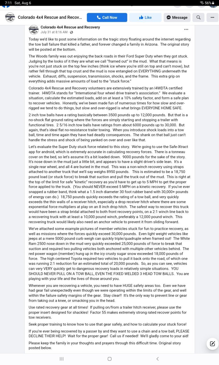

    I know that many of us don't do Facebook. I don't do FB myself either. But I logged in with my wife's FB to read the article that @eurowner linked. Here is a screen print...

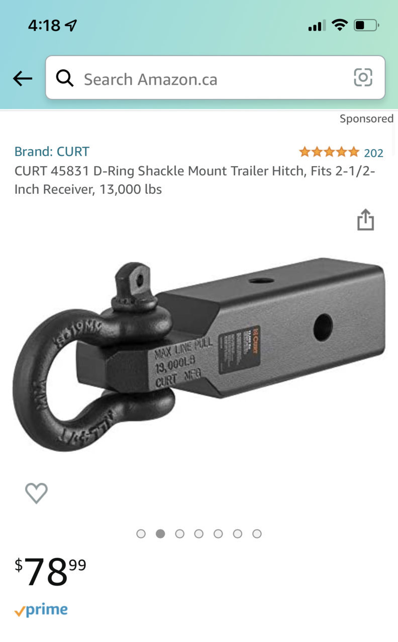

    I'm certainly no expert, but I look at the pictures and think; shovel, exhaust/air jack, waffle boards, kinetic rope, bridle with soft shackles around the rear axle or rated shackle hitch/D-ring of the stuck vehicle, rated shackle hitch/D-ring on the pull vehicle, safety blankets...
    The shovel and exhaust/air jack would have helped immensely; that's a lot of mire force to overcome.
    I've read the pull vehicle was about 5' above the stuck vehicle and that is not a particularly long strap...they have charts online to calculate mire forces at an angle.
    Like I said, I'm no expert, but have enough metacognition to ask and learn.
