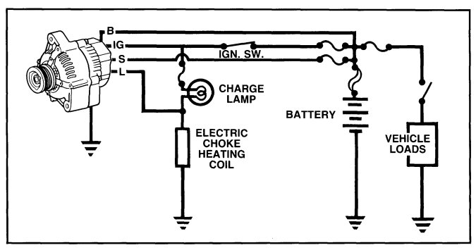

    That's why it depends on how the alternator died.
    If the alternator output drops low enough or goes high enough, the voltage on the sensor circuit will sag to meet the battery's voltage under load, which will trigger the light if there is enough of a difference. You just got particularly unlucky and had it fail in such a way that the sensor didn't hit the threshhold before the battery could no longer run the car.
