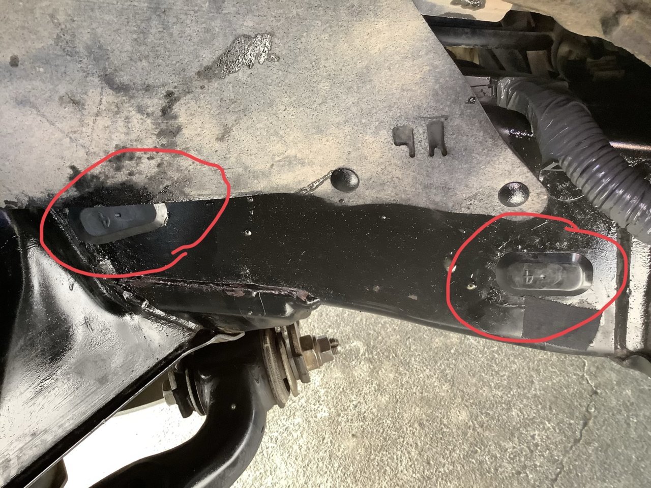

    I was covered in water and dirt at the time so wasn’t inspired to take photos. Here are some “after the fact”
    This first photo shows the two plugs I removed to access the front boxed section. They are “one time” plugs and broke on removal. My dealer had them in stock and I think they were a couple bucks each. They are a #4 size plug as per their exploded diagram.
    Note: Ignore the rust on the weld. I will get to that ( :annoyed:Toyota!)

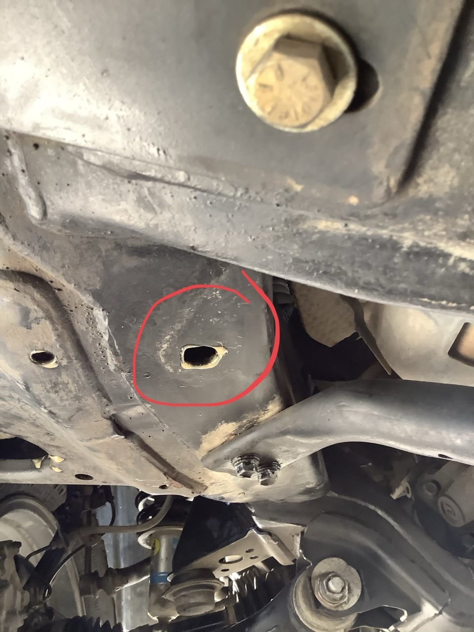

    This photo below shows the frame drain holes with the grey drain fitting removed. These are the last drain point in the frame. On level ground, your frame will drain out the grey plastic fitting that sticks into this square hole. In my case, my driveway is at an angle, the puts the lowest point of the frame ahead of these drain holes, so my boxes were filling with water and silt, due to me pointing nose-down whenever I parked my truck. When I removed the two bolts holding the Catalytic converter guard (the round tube) water poured out the holes and the bolts were rusted. That was my first clue something was amiss.

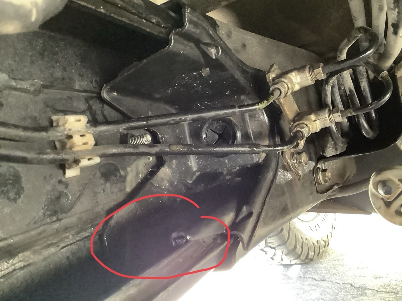

    This next picture shows the plastic guard that Toyota installed during my “frame rust campaign” service. The plastic guard has a foam gasket on the bottom edge that would attempt to prevent water running forward along the C-channel into the boxed section. The red circle shows where the foam gasket is. The part is pretty loose fitting, attached with only one screw, so I’m not going to put my faith in it. My dealer did not spray that white snot in my boxed section. If your dealer does apply the snot, it will be ahead of this guard. I have no idea what people with 2018 and newer trucks will find. Please chime in here if there’s anything to know.
    In conclusion:
    A problem with these C-channel frames is the bottom is folded back upwards, so the frame acts like a gutter. If you park nose-down, any water, salt and silt will run forward into the box section. If it makes it way past the drain, it will collect in the front box section, like it did for me (yes my drains were clear.....it just runs past on either side). Toyota has identified this issue, hence the plastic guard with the foam gasket, and the white snot injection into the front boxes on certain trucks.
    What is total bullshit:
    I went to my dealer at the request of Toyota Canada, to have my frame inspected. My dealer told me the service was complete and my frame did not require the CRC (white snot) application. They told me they installed the plastic frame guards. What they really did was encase a pound or two of mud, silt, and pebbles in my front boxes behind their plastic guard. Super lame. I haven’t spoken with the about this yet. I’m on the fence as to wether it’s worth it.
