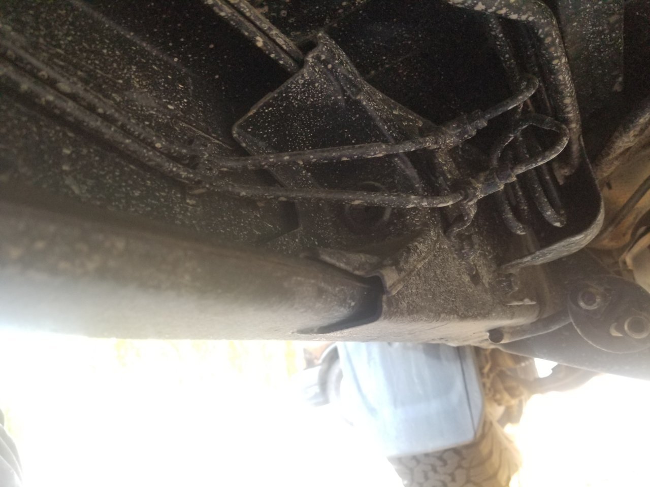

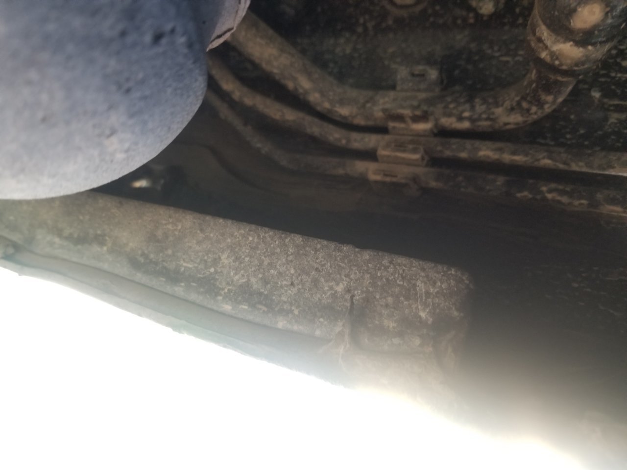

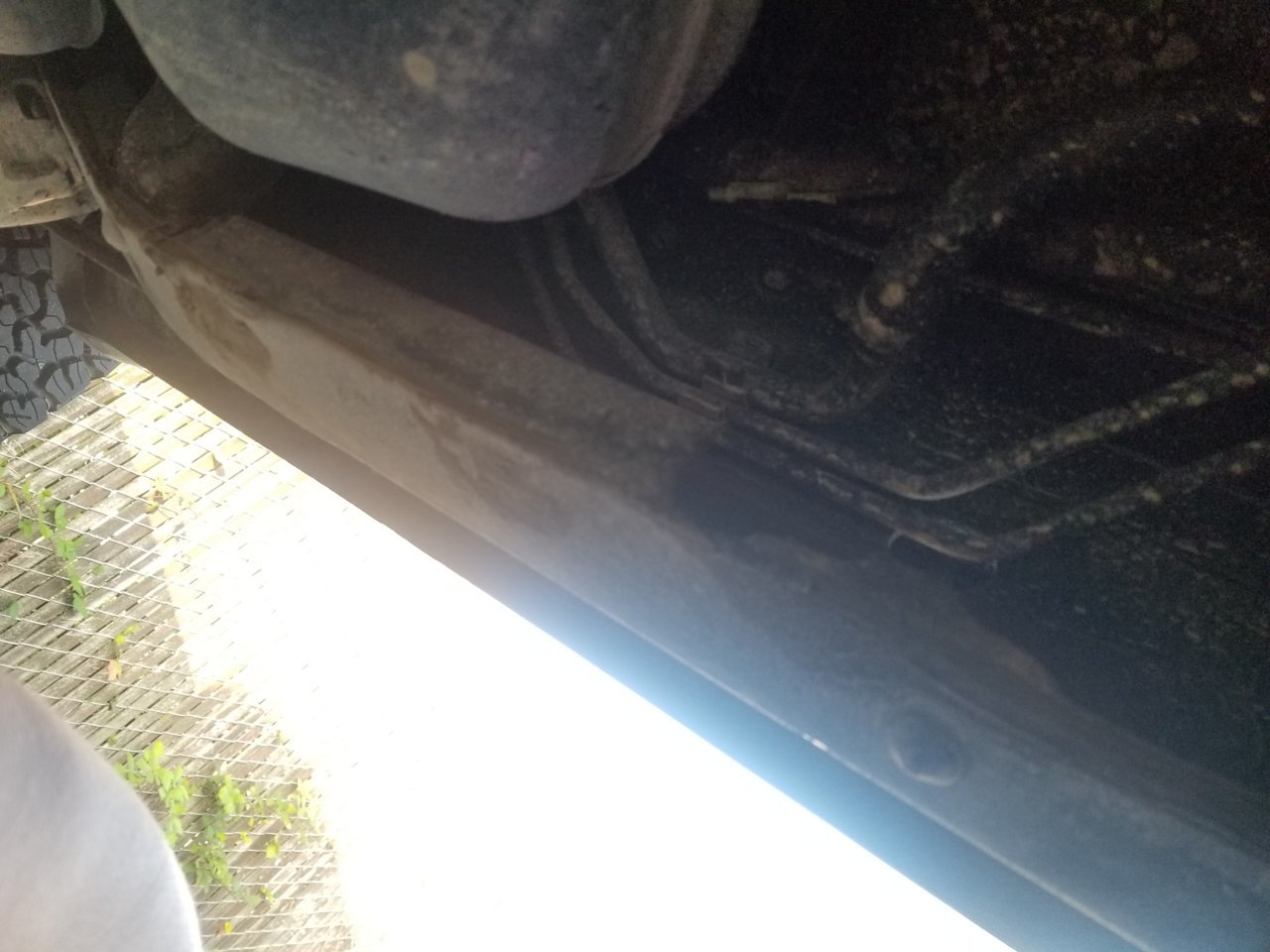

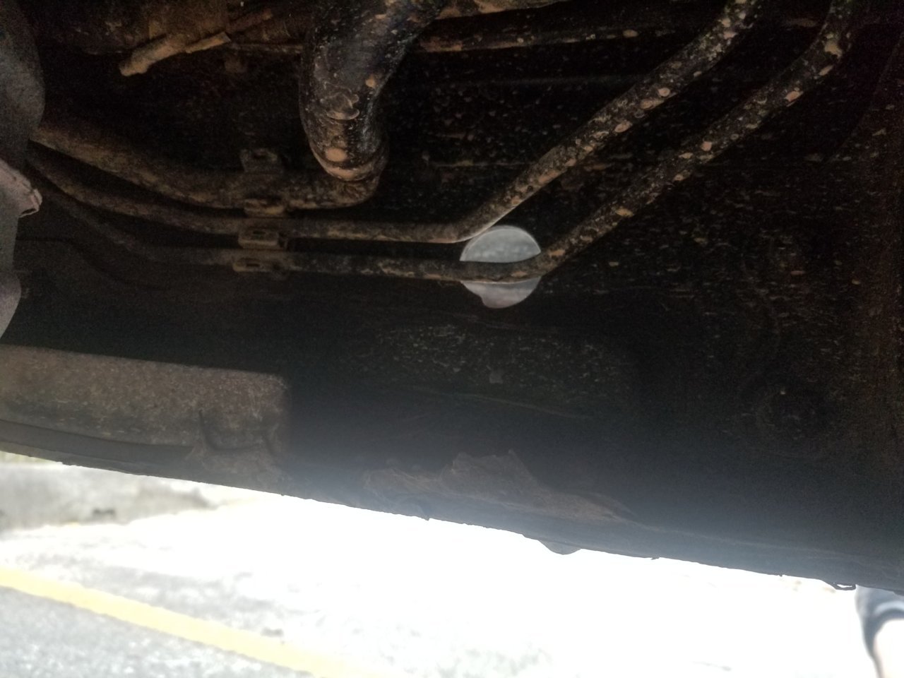

    So i have the plastic covers in the same spot as you and the goop is on both sides on the inside the frame by the gas tank and exhaust. Its mostly behind those brake lines. Its in between where the metal is sandwiched as well.
    Not the best pics but here you go. Ill get better ones later on.
    Stocklocker[OP] likes this.

    My truck has the black sealant between the two layers of the frame rails like yours show. I wonder if you have that white snot injected into the front box sections?
    The passenger side plastic cover is super easy to remove. I wonder what it looks like ahead of the plastic cover on your truck?
    Junkhead[QUOTED] likes this.

    I was told the reason I didn’t need the CRC treatment is my truck has that black sealant even though it’s a 2017. Still doesn’t make up for the the overall poor design and the dealer putting in the plastic guards without cleaning the boxed sections out first.
    On your truck, with the plastic guards installed from factory, it might be a totally different story. It would depend on how well those guards seal.
