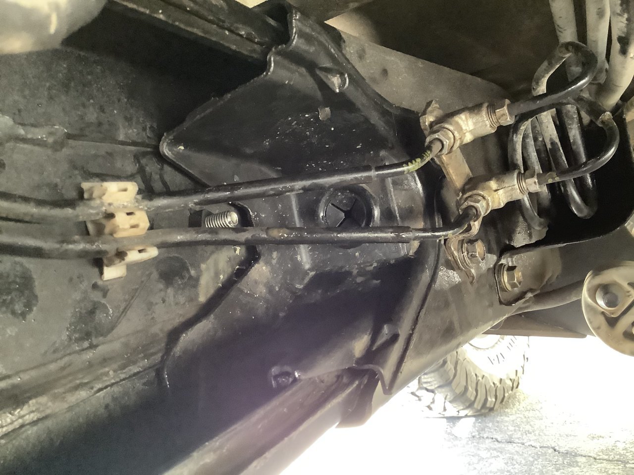

    Well, that mirrors my experience, but I had no guards from factory. I guess it confirms my suspicion that the guards are mostly useless.

    So there is no confusion, it’s the large plastic guards that block off the front box sections we are discussing. Not the rectangle plugs.
    These guards we retrofitted by my Toyota Dealer under the frame rust campaign. All they did was seal all the crap inside my boxed sections that they did not wash out before fitting these guards.

    It’s the large plastic guards that I was talking about, my 2017 came with them already installed, I was just wondering if others don’t have them. Surprised not all did, I wonder if they did away with them for any reason or just forgot to install them at the factory.

    I’m still a bit chived my dealer “swept the dust under the rug”.
    Anyways.......Toyota seems to want to address at least some of their problems with rusty frames, and the dealers are just playing games to get paid by Toyota for campaign services they didn’t do.
    At the end of the day, it’s always up to us to maintain our own stuff, if you plan on keeping the vehicle long term.

    I was asking a few weeks ago about what those plastic guards were and no one answered at the time. I’m happy that I decided to shoot Woolwax deep into that area via the convenient X opening now.

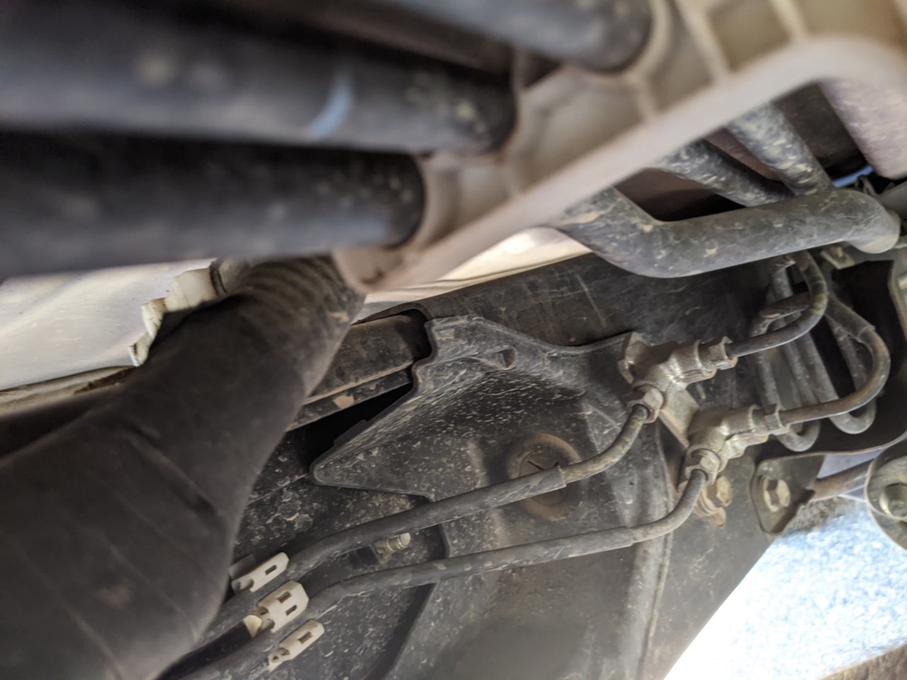

    I got the shields on each side. No idea how long they've been there, but only ToyotaCare stuff for me.

    At a point inside the box, ahead of the plastic guard, there is a steel baffle. If you really want to coat the inside of the front box sections with wool wax, you need to pull the rectangle plugs located behind your front wheels. I don’t know if this is required in your case, but something to consider.
