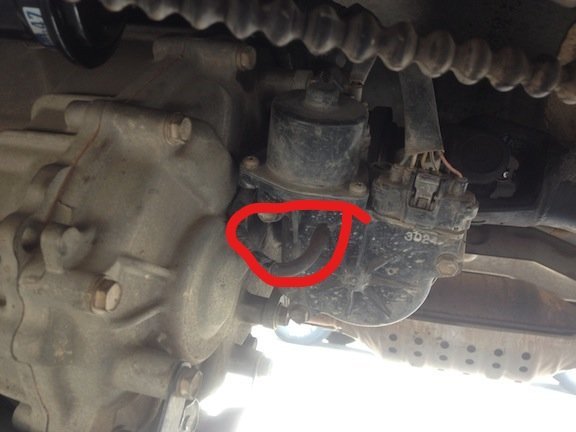

    This is just a friendly reminder to crawl/roll/slide under your 4X4 Taco and check that your transfer case vent tube is not split or falling off.
    If it is, trim the end and reinstall!!!!!

    My actuator was acting up a few years ago, water got inside and corroded the contacts through a split hose. My truck would partially go into 4wd and grind the gears in the transfer case. Took it apart, cleaned it, trimmed the hose and reattached. Problem solved!
