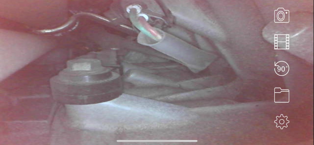

    scleaf
    scleaf Well-Known Member
    Jan 6, 2014
    #120062
    1,019
    Torrance, California. USA
    2013 Silver Tacoma TRD 4x4
    SaBellCo's Tailgate Lock :), Cable mod
    eherlihy, kgarrett11 and CMD-KY like this.

    Just updated my post with a picture. If a mouse gets in there I am taking it in as a pet
