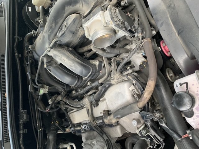

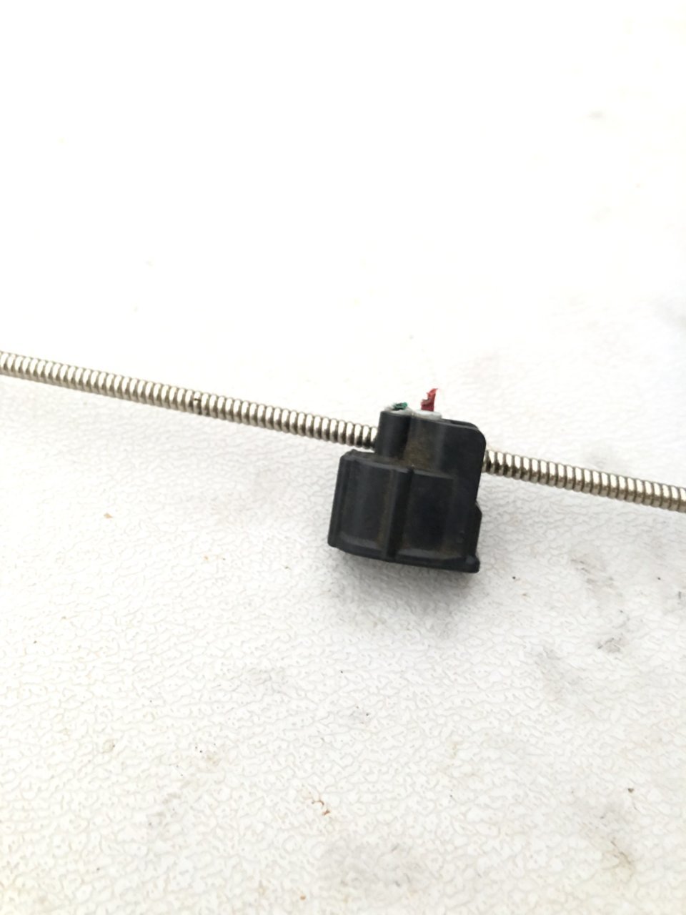

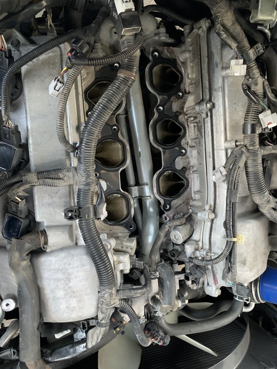

    My mechanic told me it was the knock sensor code and said it was 15-20 hours to fix this the right way, by replacing the harness. My 2010 Tacoma has 249k miles on it and they cautioned me about getting this fixed because of the high cost to fix and the age of my engine. They wanted me to just wait it out until I blew a head gasket. That was some b.s.
    I decided to give this repair a go and it was surprising easy, given it was all on the intake side. After about 6-8 hours, I was able to successfully fix my knock sensor connector (chewed off at the connector) after following this write up! This post saved me a lot of money doing this myself! Plus I got to add a few sockets to my collection (torx set and Allen key set).
    One thing that really came in handy was a skinny flexible claw grabber tool. My rats nest was pretty big, so cleaning it out with my fingers was pretty tough. It was crazy how big some of the sticks were that those little suckers were able to smuggle up there. Using a grabber and a vacuum, the rats nest was gone pretty easily, plus the grabber was great for fishing out and holding the chewed off wire while I soldered the new connector pigtail.
    Make sure you spray the crap out of your engine with that rodent deterrent!

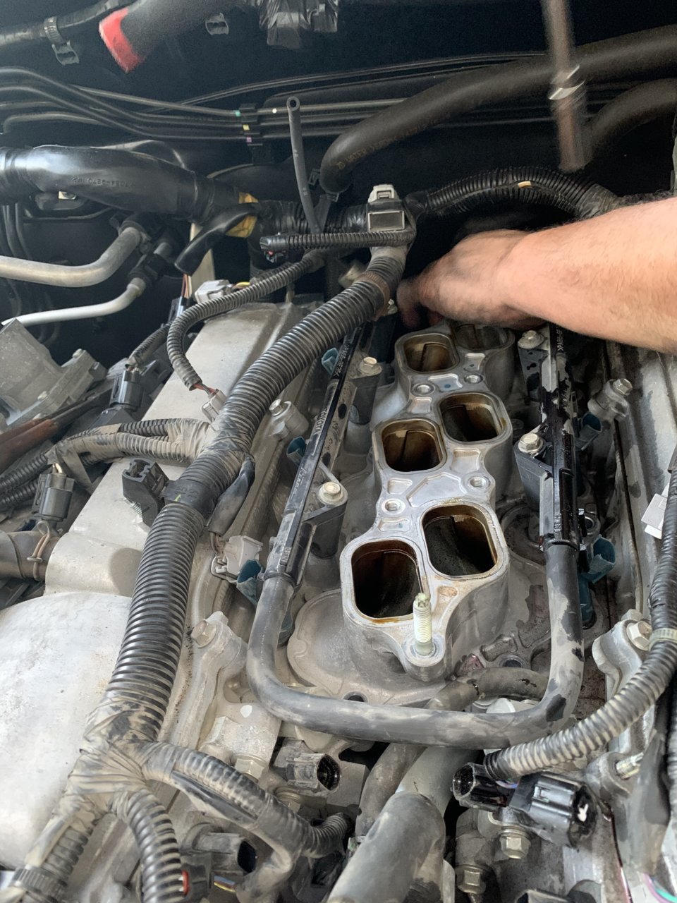

    Thanks for the great write-up. Got the code Wednesday this week. I'm going to tear into it tomorrow. Thanks to these little bastards.
  16. Jun 28, 2020 at 6:55 PM
    #76
    Tour991
    Tour991 Supplier of used parts
    Nov 24, 2011
    #67616
    10,861
    James
    South Reno/Tahoe
    97 2/4wd, 2014 DCLB 4x4, 99 T4R Limited (sold) 2024 4runner TRD Pro
    Just finished fixing my 2014. Took about 6 hours not rushing. This thread made it extremely straight forward. I got lucky with where the creature chewed the wire. Was pretty easy to fix the wires (white and black) the red and green on the passanger side are untouched. Thanks again for the great write-up.
