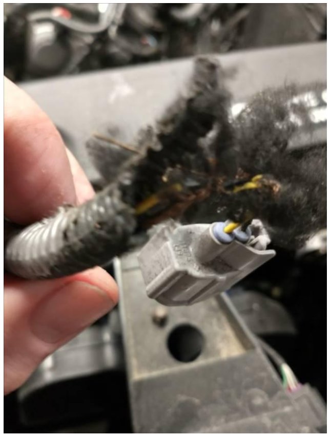

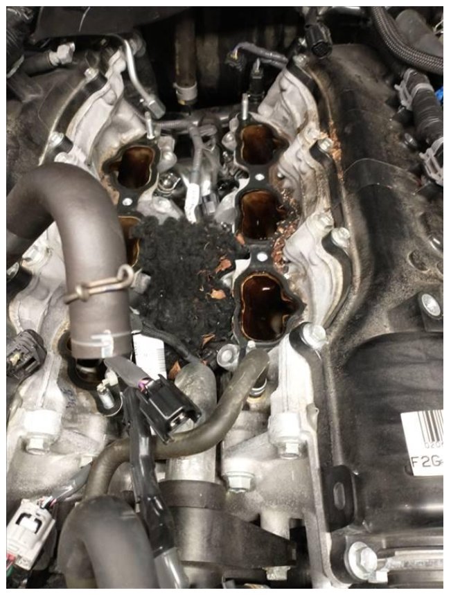

    This just happened to me, 1700$ dollars later now I'm on a crusade to prevent this from ever happening again. Mouse nest found under the intake manifold.

    Holy crap! Guess there's no question on your's what the culprit is.
