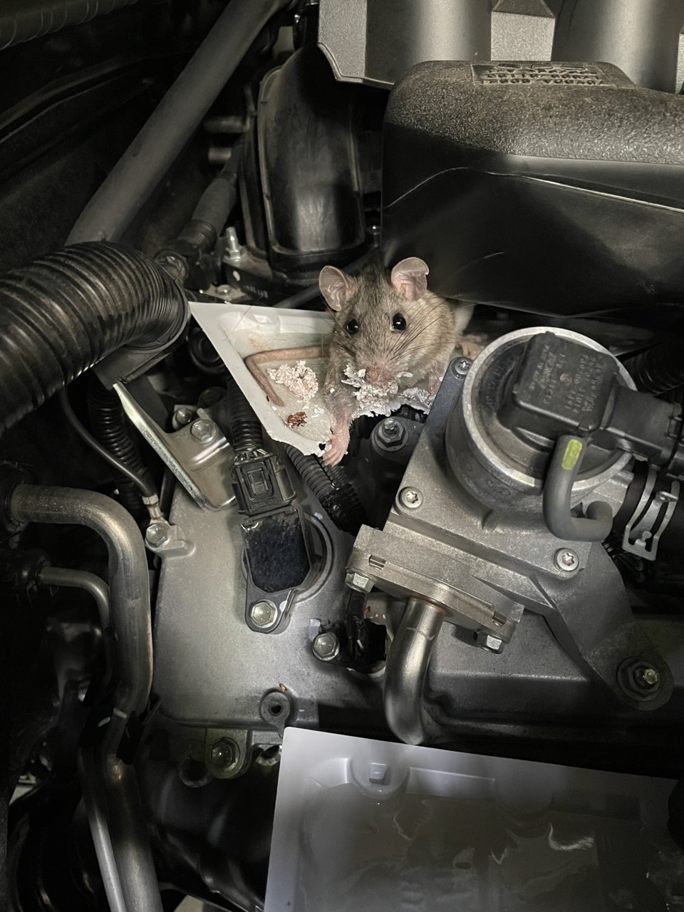

    Gotcha MF’er

    new fear unlocked..
