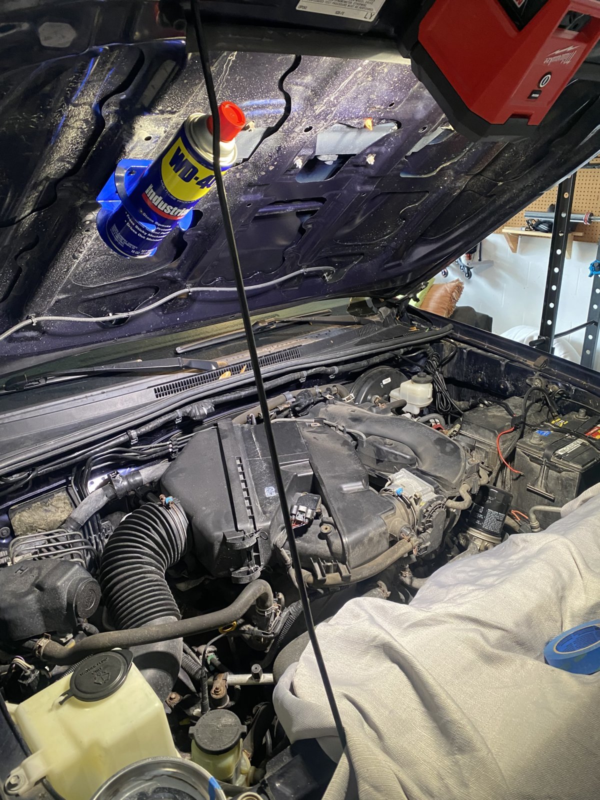

    I did this last week, took about 8 hours but I took my time and did some PM work while I was there….
    added two altoids cans with moth balls! Mounted on fender wells.

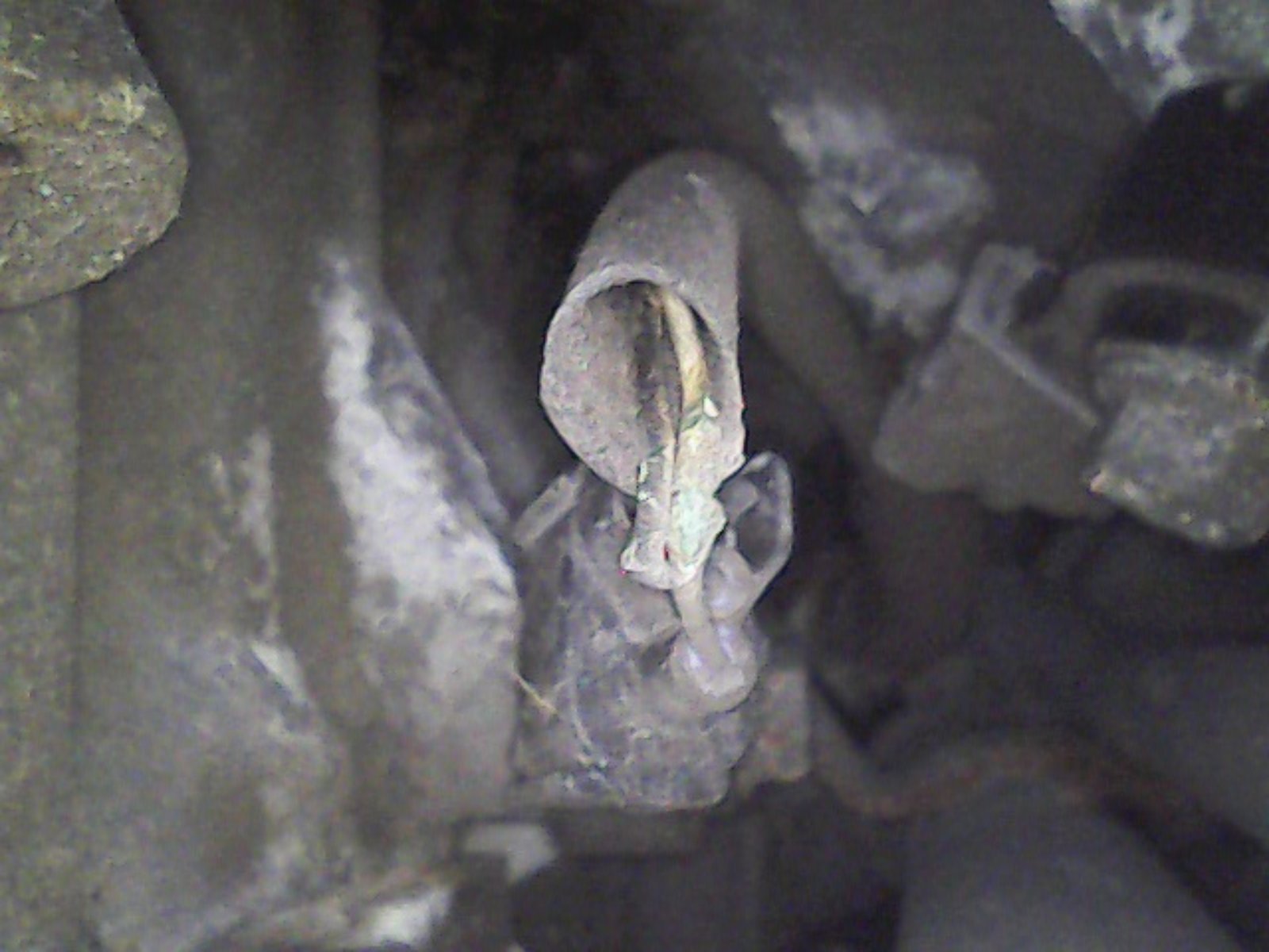

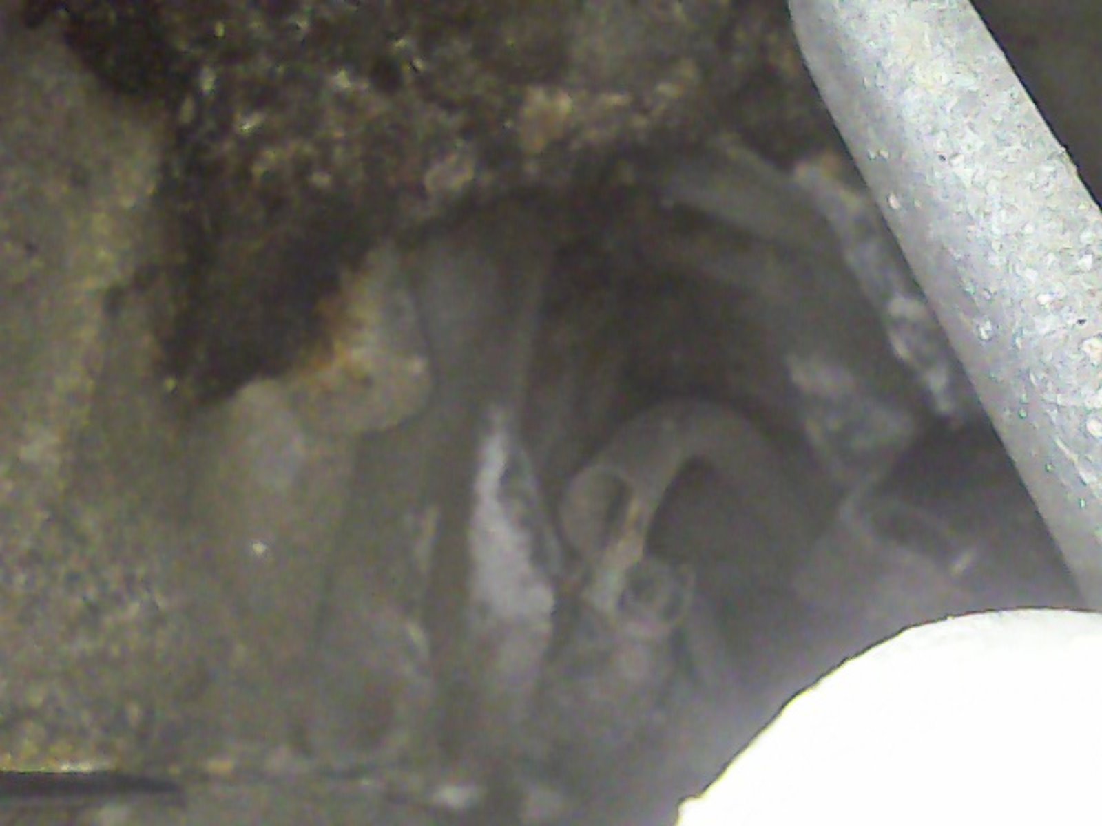

    I appreciate the sympathy. I have wiring harness and rodent repellent on the way and I’m ready to dive in!
    Used a cheap borescope. Check out the photos !
    Gross ! Hope this is the correct harness.

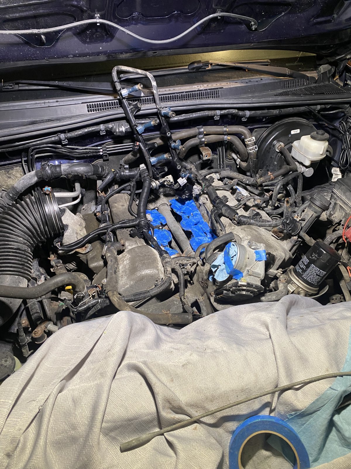

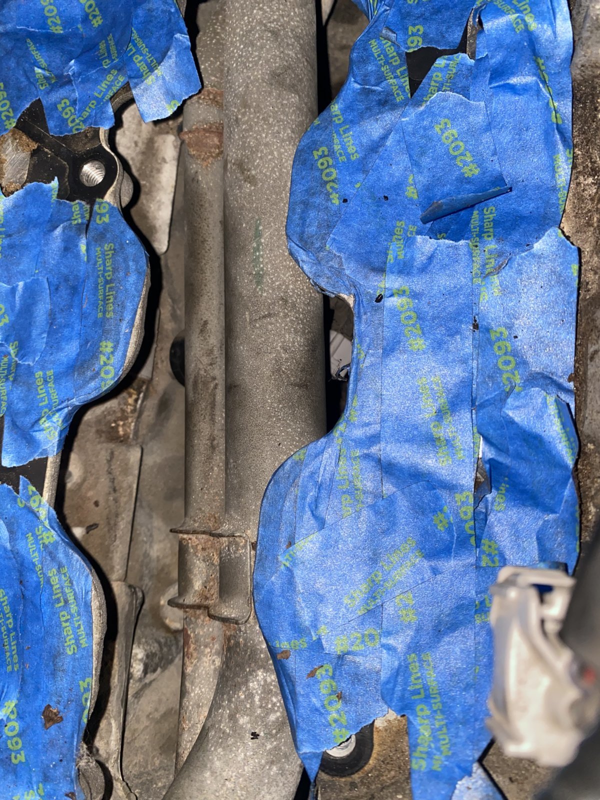

    Okay!
    I was able to complete the repair this weekend by replacing the damaged wire. I’ve replaced my brake calipers, but this was my first time tackling something like this and I’m super glad I did. Code has vanished and truck is driving normally again.
    I spent $50 on the replacement harness. And about $45 on a set of replacement manifold gaskets.
    I then spent about $150 on essential tools, but you know I had to get good lighting and gold plated ratchets for Black Friday!
    some thoughts:
    Have a variety of ratchets and extensions. There is a very difficult to reach 10mm bolt in a recessed bracket on the rear of the plenum. I was able to use a 1/4” flex head with a wobble extension.
    A shop vac with appropriate attachments really helped me clean around the air intakes to remove debris
    Start early and you can be done in a day assuming you are prepared. Which was not the case for me.
    There is nothing overly technical if you are fortunate enough to connect a new plug . If this was not possible for me, I very likely would’ve had to proceed with cutting the coolant pipe and all that.
    Big thanks to everyone who has left wisdom here in these threads because it made this possible for me !

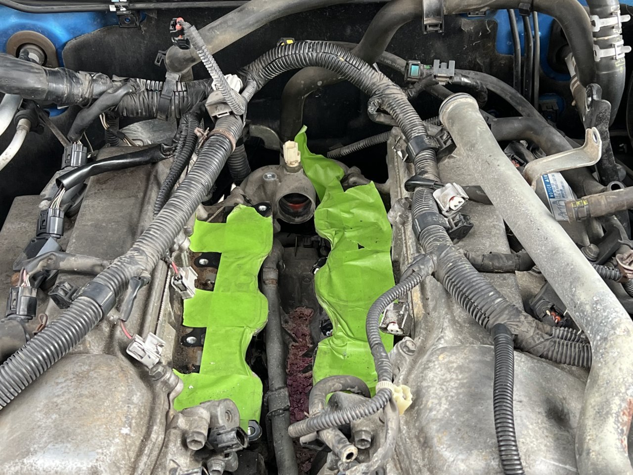

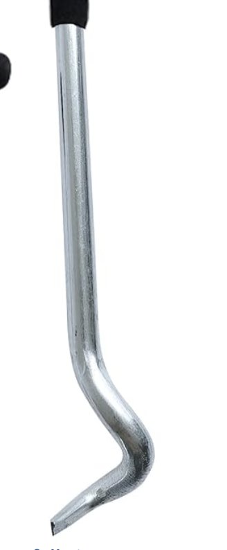

    So it was quite challenging to work around that pipe which indeed does stay. Here's what is did/needed. I went to Ace hardware and looked for tools like hand picks etc - the regular hand picks didnt work but I found this odd tool that looked a it like a screw driver - I think its an O ring/seal puller. I cannot find it online but I am adding a pic of the tip - that pic comes from something on Amazon that has a T handle which is not it but if you go to Ace and imagine that tip with a black screwdriver handle it is the one. That tool was essential!
    You will also want a small flat screwdriver or pointy awl (the one that comes with the four pack of picks at Ace does the trick - little orange handle).
    Get a good light!
    Next Id recommend you use genuine toyota replacement harness so you dont fiight more than needed.
    There are 2 plugs under the pipe for each side and one all the way in the back. The one on the right when facing the engine is easy enough, use the pointy pick to slide into the tab to spread the tap open. You can then push the plug off with your fingers.
    The left side... oh boy. Same concept but you cant get your fingers in there to push the thing off once the tab is spread so that O ring tool was super essential as it has curves that let you get in there.
    Once that is off you can then pull the harness out back and disconnect - there are about 3/4 plastic clips along the way that are clipped in a metal tab if I recall - I think I had to break one way in the back but was able to undo the others without too much of a hassle.
    Then to put the new one back. I used electrical tape to wrap around parts of harness to help it in the right shape and direction as you wont be able to do so once its in there. You essentially want the harness to "stand" just like it would be once clipped. Use some small 6-8" length of thin wire to wrap between the electrical wires near each plug - you will use that to create a "handle" to pull the plugs onto their respective counterparts once they are positioned - if you use the tape correctly you will have the harness plugs pointing up in the correct angle/direction so that its relatively easy to get them started on the plugs just by moving the harness as a whole. Use the wire puller you added to then pull until it clicks - the o ring puller us super helpful there too.
    It took me 3 hours to undo and redo the harness. But a lot of it was, besides drying my tears, figuring out the tricks. Knowing the above I can probably take the harness on and off those front plugs in 30 min. So pay heed and good luck. And I cannot over stress the importance of that o ring puller and the tape to maintain the shape. I dont think I could have done it without those two tricks
