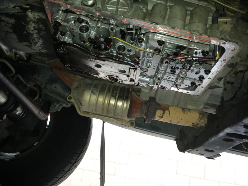

    IT IS NOT! Look at the pic, it has one large outlet, one tiny one. (the port with the cork gasket)
    http://www.amazon.com/ATP-B-101-Aut...7114&sr=8-1&keywords=transmission+filter+a340

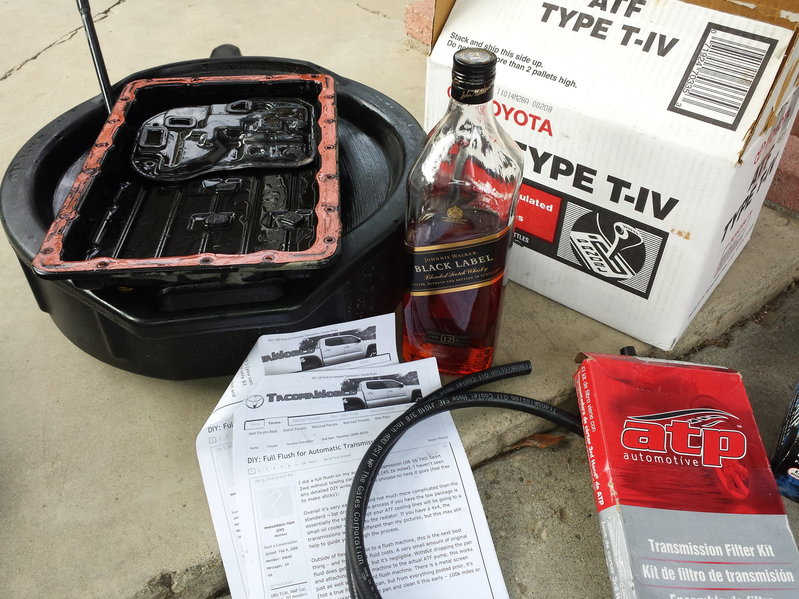

    The proper kit has three outlet ports as seen here removed in the pan.
    Ignore the Johnnie Walker, thats for me.
    The proper kit is ATP B-168 or Beck Arnley 044-0293. It will say its for a Aisin A341E, or/not a A340E, at least on Amazon it says this. It will not mention anything about a 30-40LE A/T.
    http://www.amazon.com/ATP-B-168-Aut...33&sr=1-29&keywords=transmission+tacoma+a340e
    http://www.amazon.com/Beck-Arnley-0...=1-9&keywords=transmission+tacoma+beck+arnley
