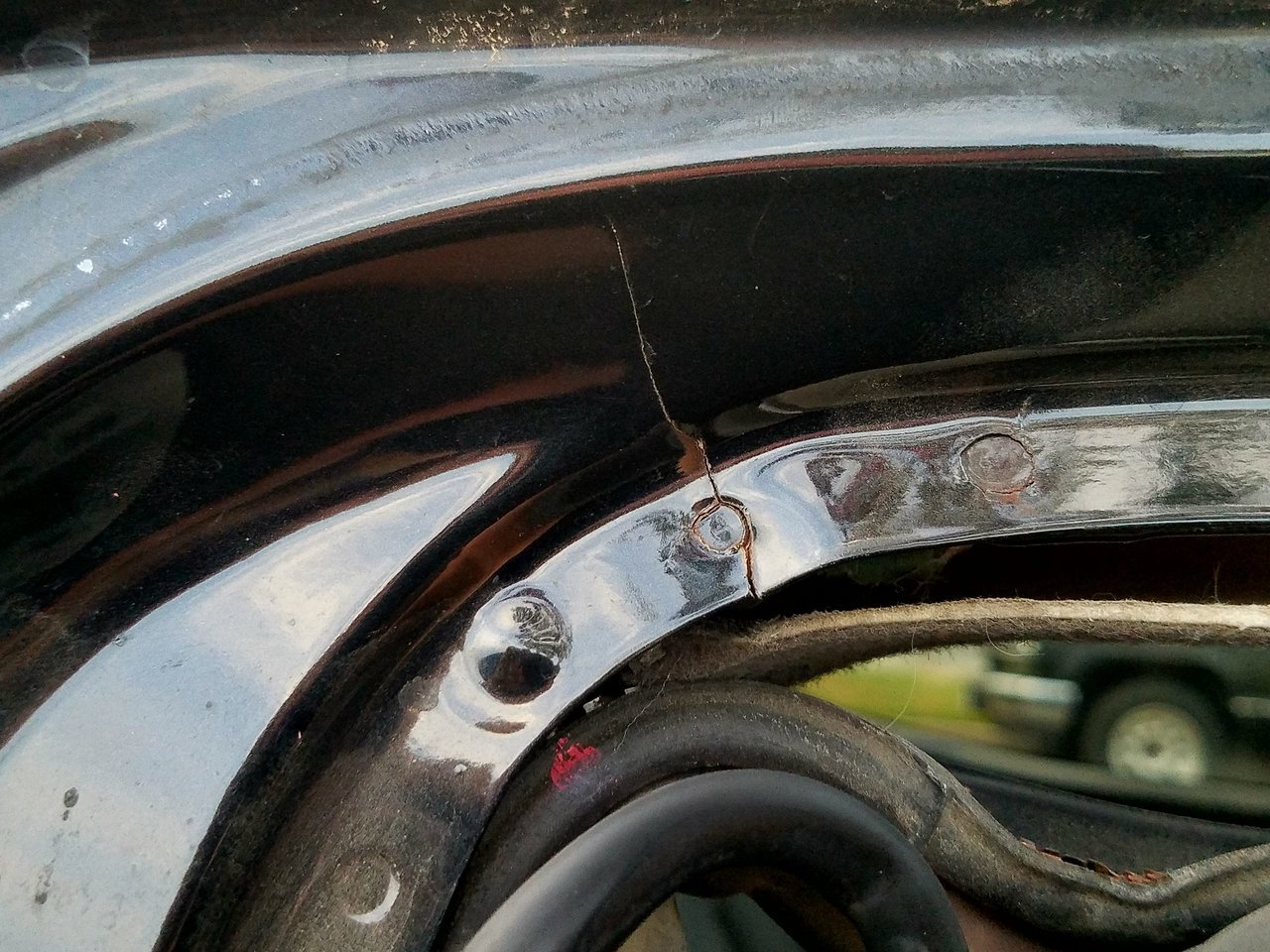

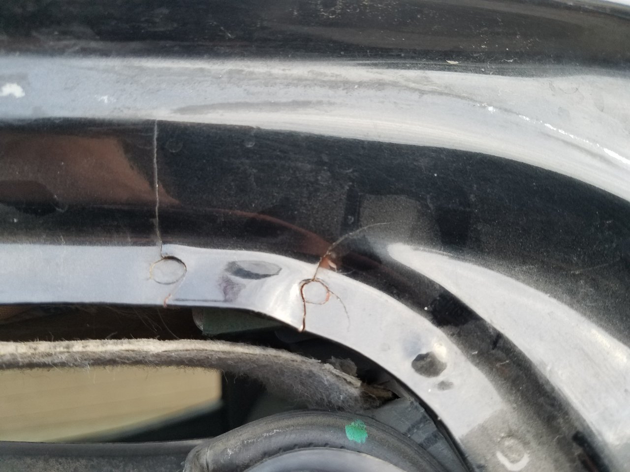

    Do you have these cracks in the cab yet?
    Passenger side:
    Driver side:
    mynewtoy, tetten[OP] and Whitecloud like this.

    What year is yours again? Those look bad. When did you notice those? And those are off the C pillar right?

    2008, noticed a few years ago after someone else mentioned having the same cracks.
    Whitecloud[QUOTED] and Coot83 like this.
