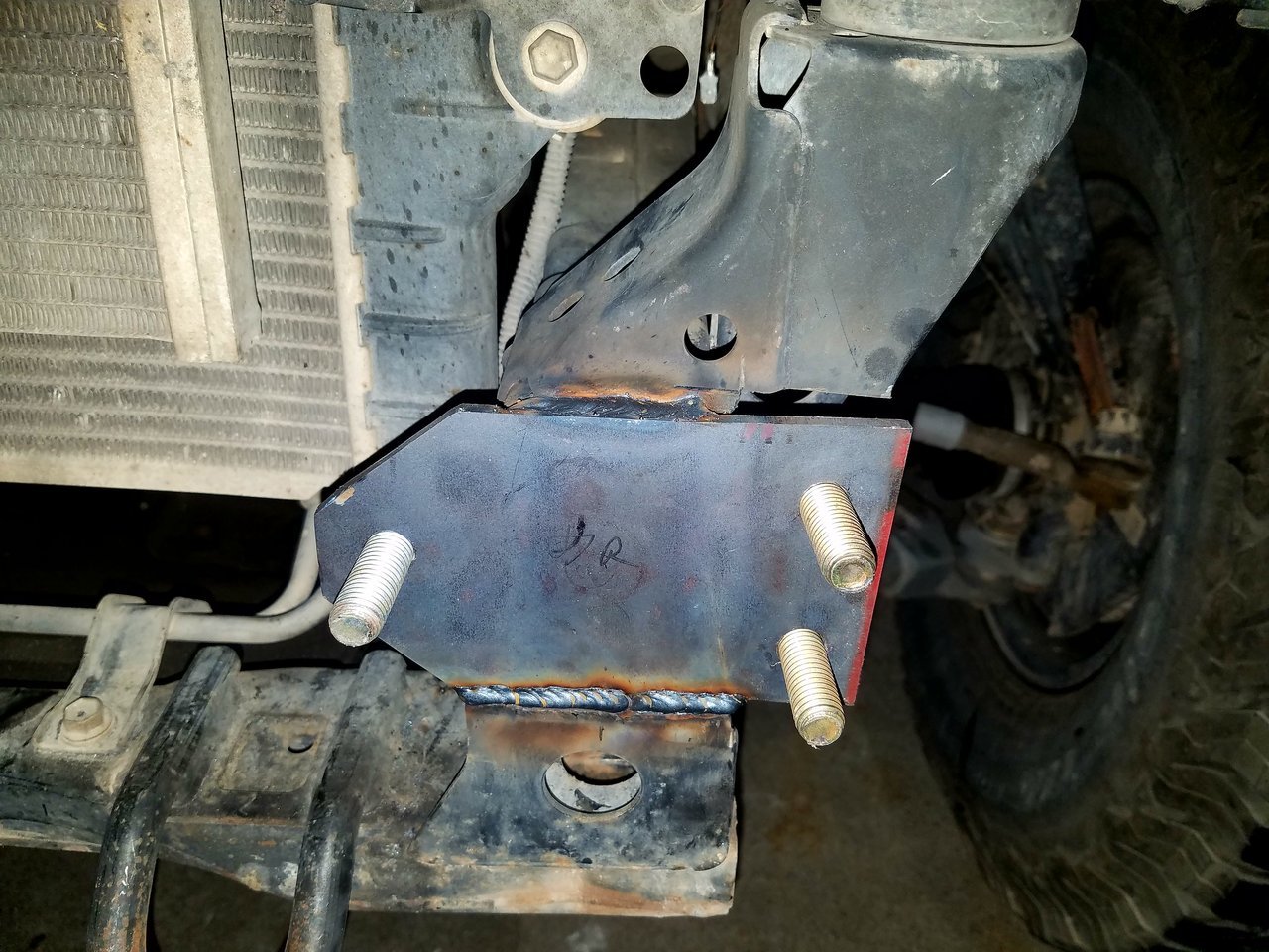

    You beefed yours up a little more than some of the others I've seen. Gives me a couple different ideas, thanks for the photos of your work.

    I cut the factory bolts off on the outside. They are tack welded on the back. Welded a 5/8 plate to the back of the factory mounts and frame then added a third hole on the outside. Then used 7/16 grade 8 bolts.
    I don't have pics. It's still a work in progress. I have to take the bumper off one more time to bed line it. And finish welding the mounts

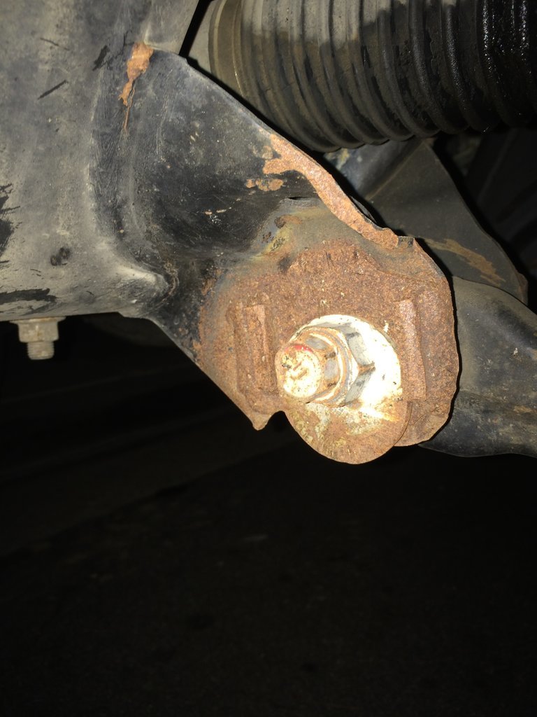

    jakebray
    jakebray Well-Known Member
    Apr 6, 2015
    #152649
    1,045
    jake
    SoCal
    13 PreRunner
    Locked DCLB with Kings and crap

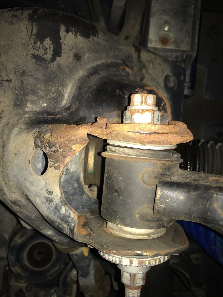

    At least yours doesn't look like this:( IMG_1091.jpgIMG_1093.jpg
    tetten[OP] and Whitecloud like this.
