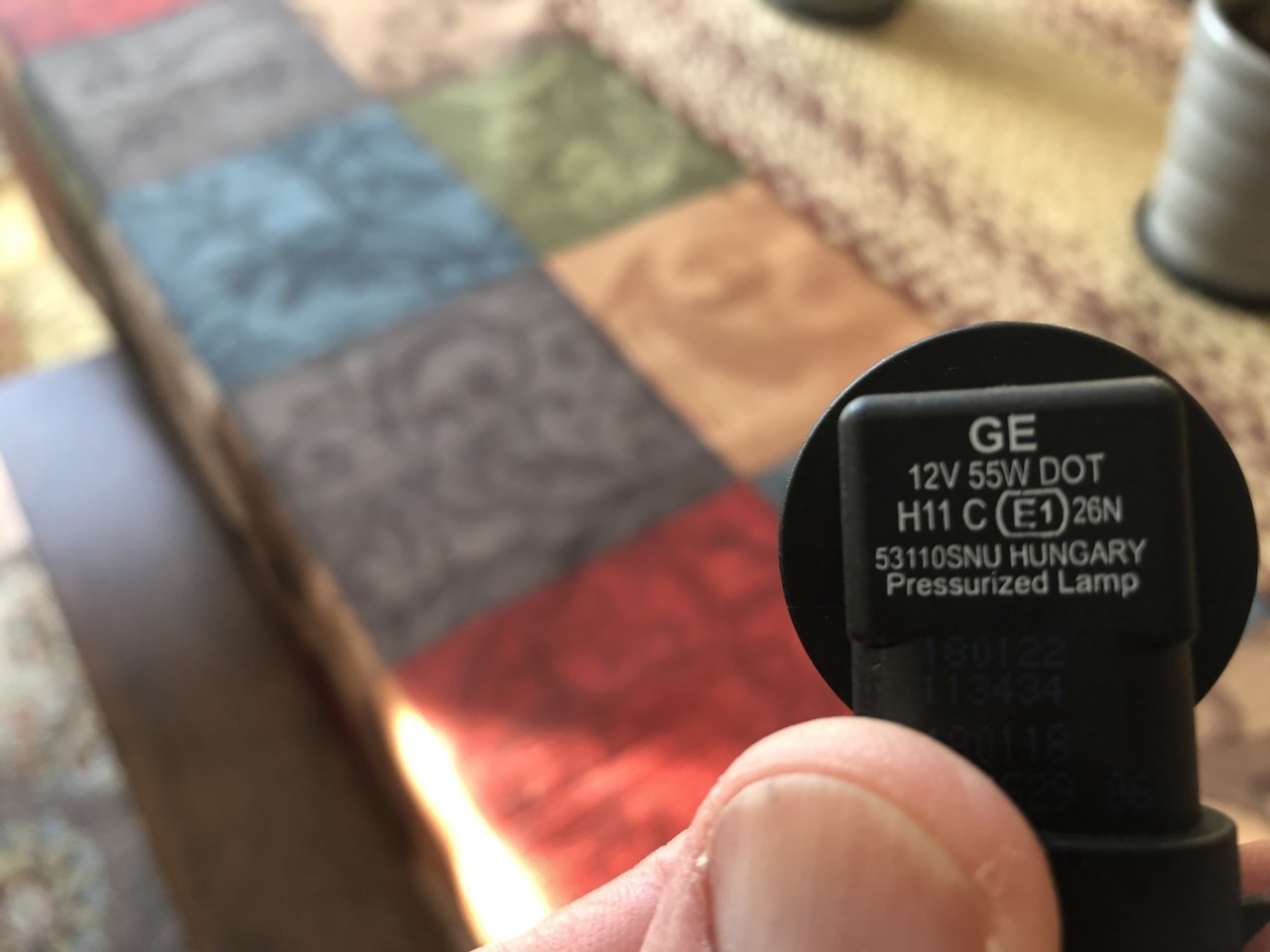

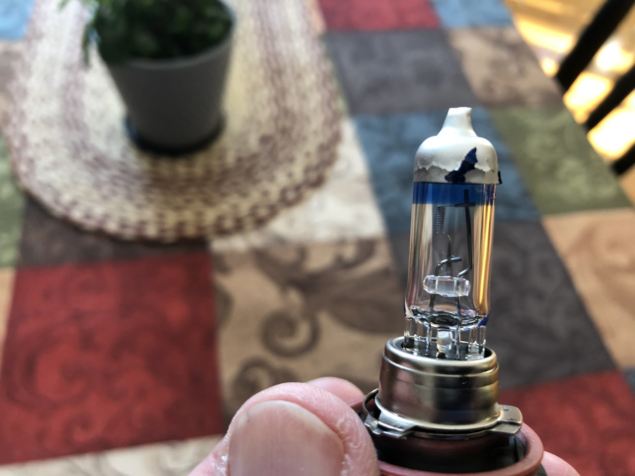

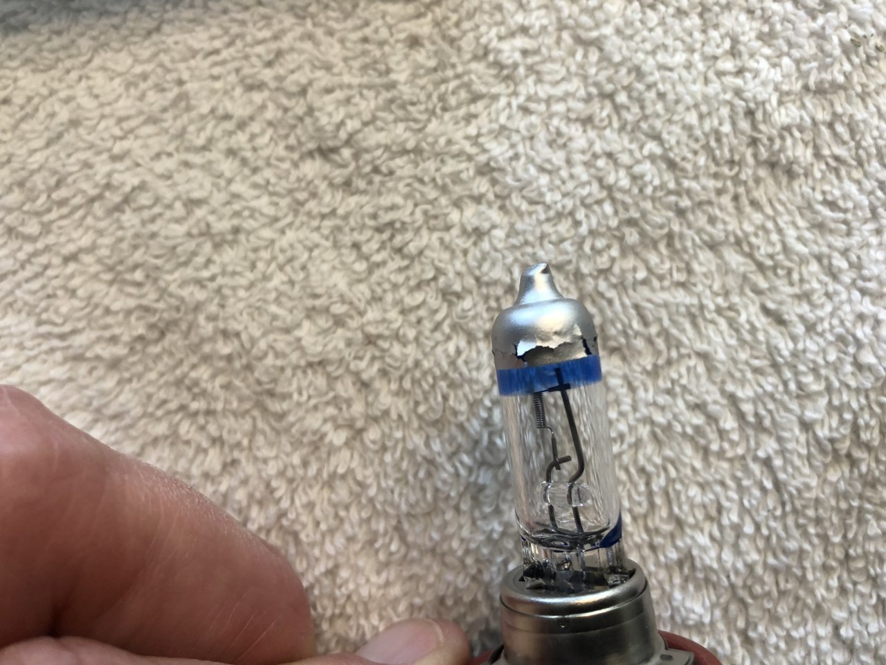

    Guys I’ll do a more in depth story later tonight in the headlight sticky but to keep things short please if you’re running these bulbs pull and check them.
    I replaced my stock bulbs with these several weeks ago and only ran them for 10-15 minutes to see how they performed. They were ok but I wanted to try the H-9 trick which I did today. Here’s the Tungsram Xenon Nighthawks that I pulled from the passenger side. Lucky for me none of this went into the light housing and I wouldn’t have even known that this was happening if I didn’t pull the bulb to put in the H-9. I’d have to say that these were either defective and/or were running pretty hot.
    10-15 minutes of use and here’s the result. These were purchased via Walmart online. D37709BF-CA0B-48CE-B546-E8781229325F.jpg81F2004F-376B-4FDE-896D-D8DF8920B3B7.jpg
