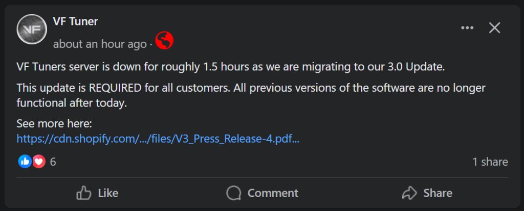

    Apparently even legacy (wired) customers will need to update the software to use it any more. When I went to the download page on their website it shows two different versions but both links are the same, so it seems they were lazy and instead of updating the webpage images/text to explain that everything is in one version now they simply just made both links the same. I guess.
    From their fb post:
    Full PDF URL here:
    https://cdn.shopify.com/s/files/1/0885/5830/files/V3_Press_Release-4.pdf?v=1725750153
