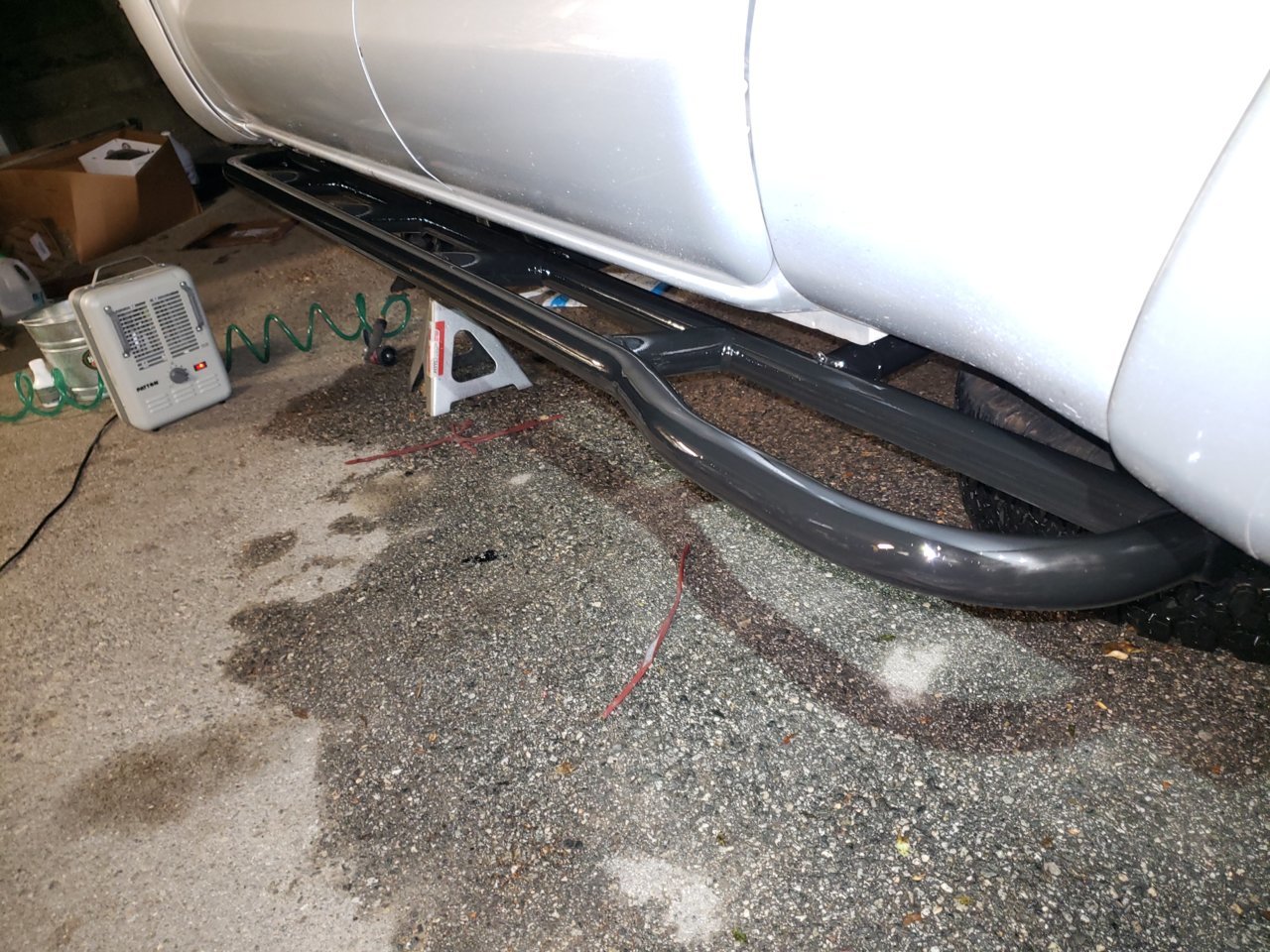

    Well timed thread revival... I just ordered some raptor liner and here's why:

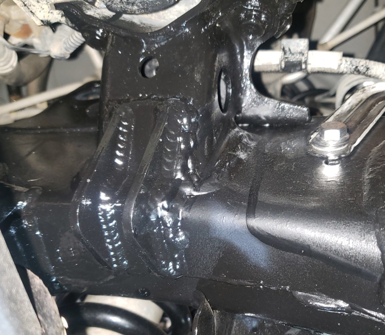

    So last year I wound up painting essentially my whole frame with POR15 and a spray overcoat. Didn't actually remove the cab, but jacked it up enough to do the top edges too. Needed new new cab bushings anyway. Also gusseted my motor mounts while I was in there. And regeared while I had the driveline removed. About the only thing I didn't get to was the inside frame behind the fuel tank. Gotta save something for someday.

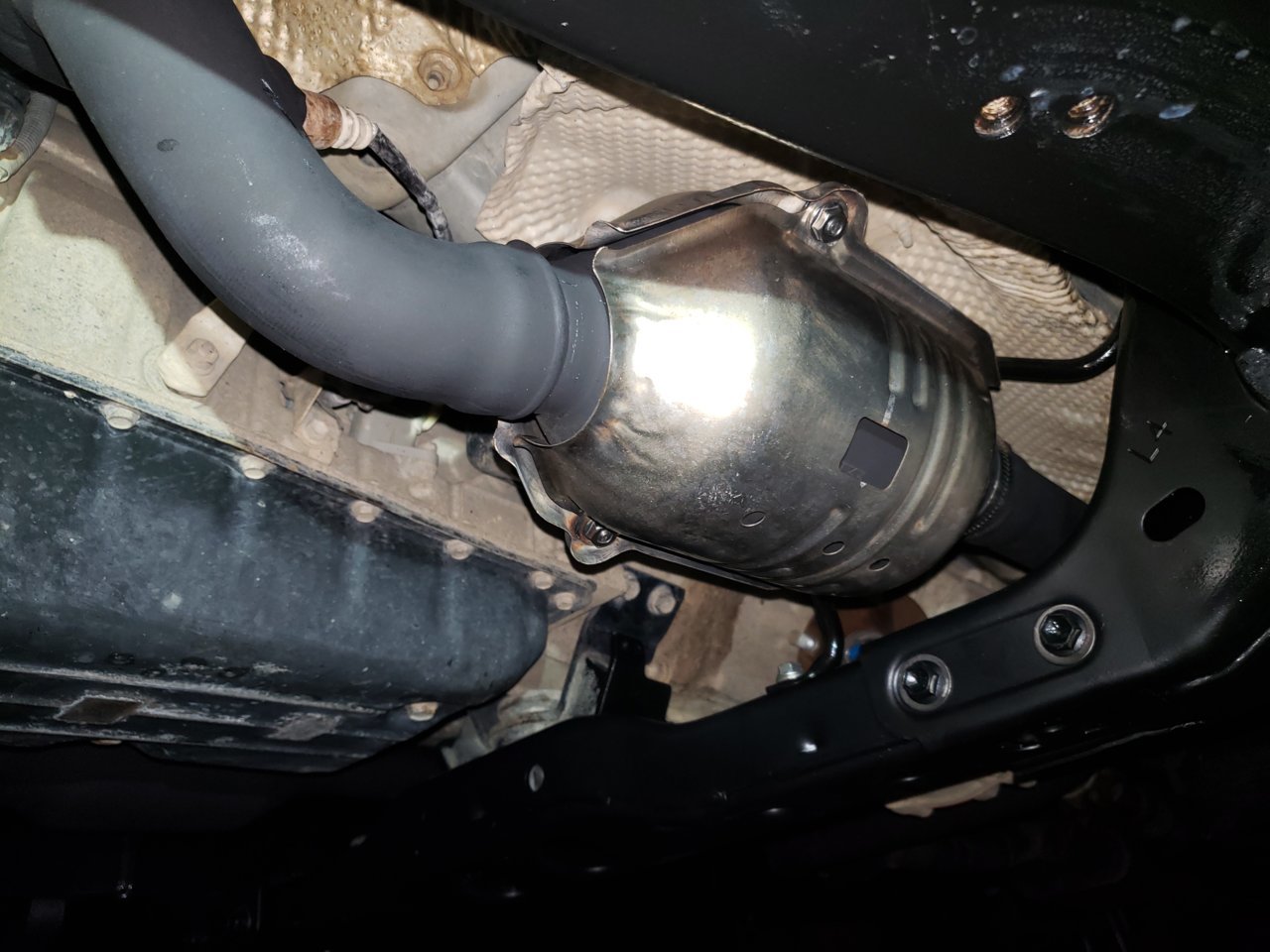

    Ceramic painted the exhaust...

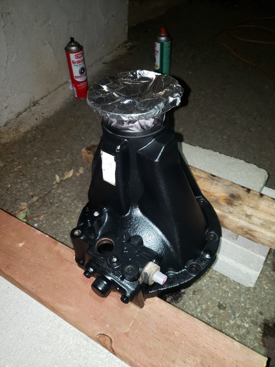

    Rear axle... also replaced the shoes and drums.
    Lol this was too heavy for me to lift, had to raise it with slings and a jack...
    Motor mounts...
    Sliders...
    Oh and I replaced most of the screws, nuts, and washers with stainless steel along the way. Downside is that the stainless screws take a different wrench size, 1mm larger, but I'm used to it now.

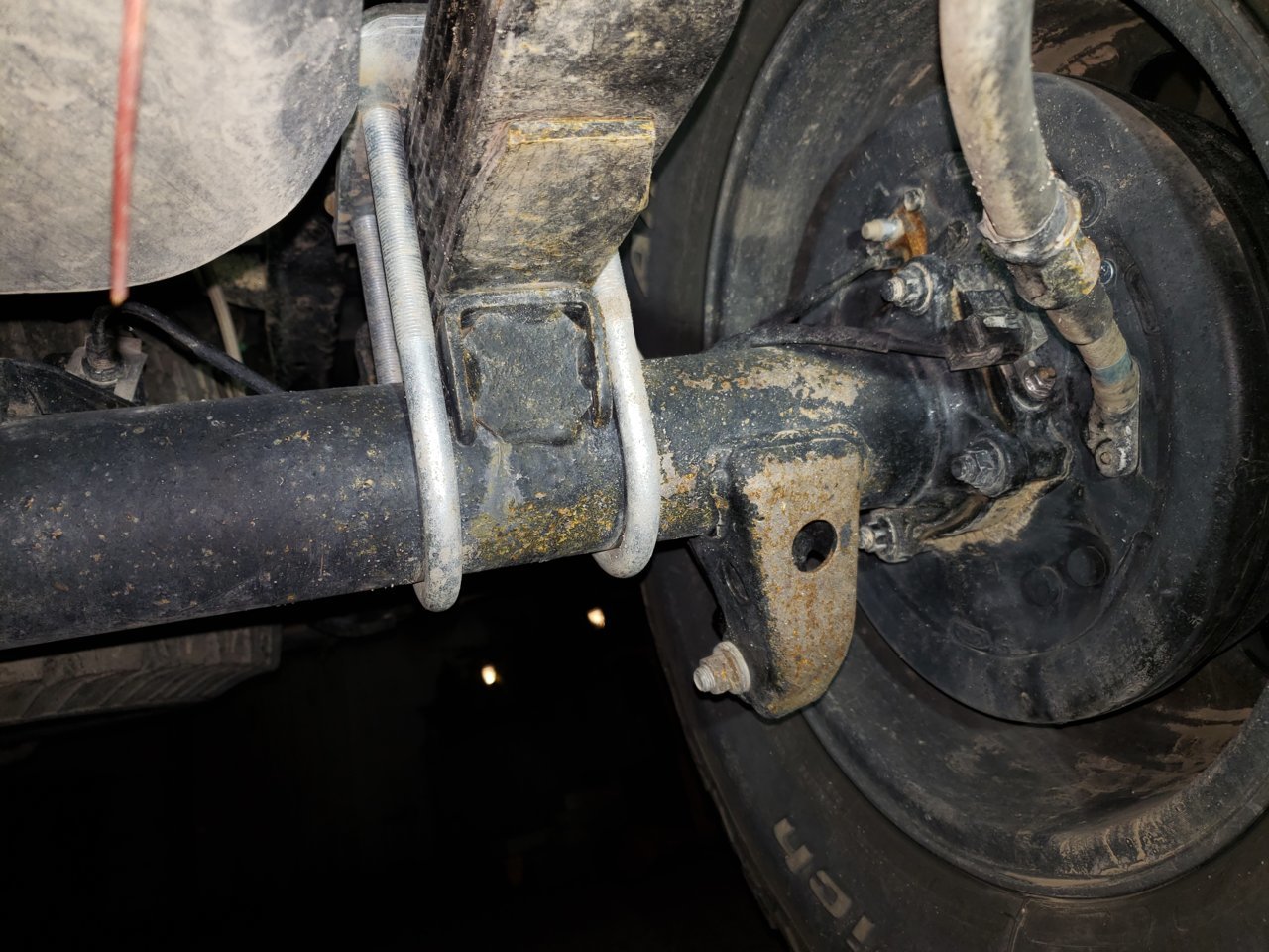

    So a year later, how do things look?
    Mostly brand new. This is great!
    BUT... the POR15 doesn't stand up to being blasted with gravel at 80 MPH. Every forward facing surface down there is back to bare metal! Luckily it isn't a problem because things don't really rust here in socal, but I'll definitely have to touch it up before driving through another salt mine! I'm thinking I'll try the brush-on Raptor Liner on these surfaces.
    They were immaculate... until the first trip back to the desert!
    Just surface rust... but obviously I chose the wrong paint for the gravel-blasted areas. Or maybe it's just hopeless in the first place.
    It was a ton of work but I'm glad to be free of the scary rust from the salt mine!

    Can't tell if you're asking for an update or just trolling. I'm going to assume the former.
    I haven't yet come up with a good way to deal with the fact that driving fast in the deserts sandblast the paint from forward facing areas. But the surface rust is no problem here in socal, so I have made no effort to repaint these areas. If I lived somewhere where they salt the roads I would be trying a lot harder, or at least spraying cosmoline or something. Yuck.
    Did some suspension work the other day and boroscoped inside the front of the frame where rust usually kills these trucks. Still looks immaculately painted in there, as well as everywhere else not exposed to debris from the tires.
    Not particularly impressed with POR15 for this type of repair though; the adhesion has been abysmal, and I did a ton of surface prep and followed the instructions very carefully. But still glad to have done this... My 2005 frame is probably in better shape today than the majority of 2020 Tacomas north of the Mason Dixon line, and I did a lot of other useful repairs and upgrades as part of project.
