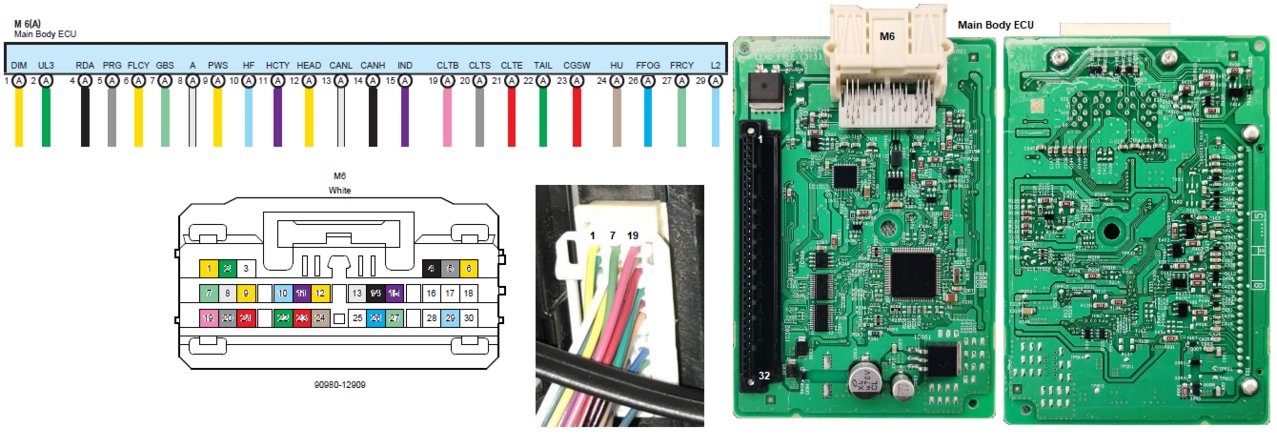

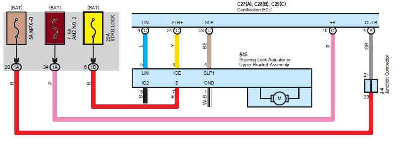

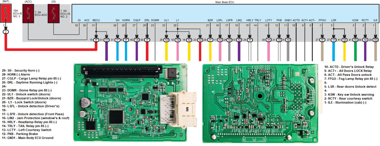

    The 3rd Gen is more prone to misbehaving electrically than the 2nd Gen. It has more systems with power taps to the battery, thus making any electrical work susceptible to gremlins/failure. A few members have already experienced systems failure by just changing from incandescent bulbs to LED's. Others have removed and replaced items while vehicle is "OFF" and also have gremlins appear.
    My point is, remove the ground terminal and wait no less than 15 min before doing any electrical work. The SRS system is one system that has its own capacitors that hold charge for a long time, and that's just one system.
    These are a few of the systems that are tied directly to the battery even when the IGN is "OFF". Disconnecting harnesses without knowing you are handling a "hot" system is an invite to expensive failure.

    86827FE7-0266-4340-99C4-1E53E1A1982B.jpg Don’t forget some of the issues reported on this forum come from tapping accessories into the engine management systems.

    That /\ /\ /\ is probably the biggest problem.

    Jest all you like, the Main Body ECU is a $400.00 item. And the stealership adds more to diagnostics, remove and replace.

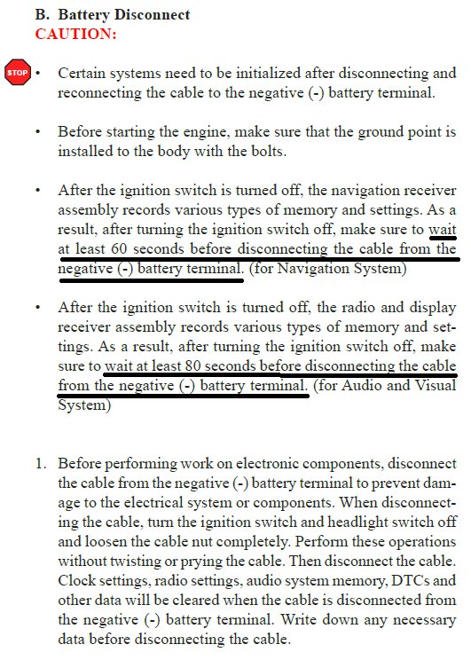

    From a Toyota electrical part instruction:
    davidstacoma likes this.
