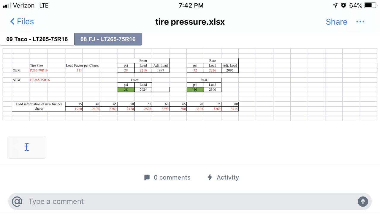

    I run 35 PSI with my LT265-75R16

    I ran 265/75R16 KO2s for a while and Discount Tire also inflated them to 55 PSI when I left.
    The ride was crap, so I ran them at 35 PSI, all four corners.
