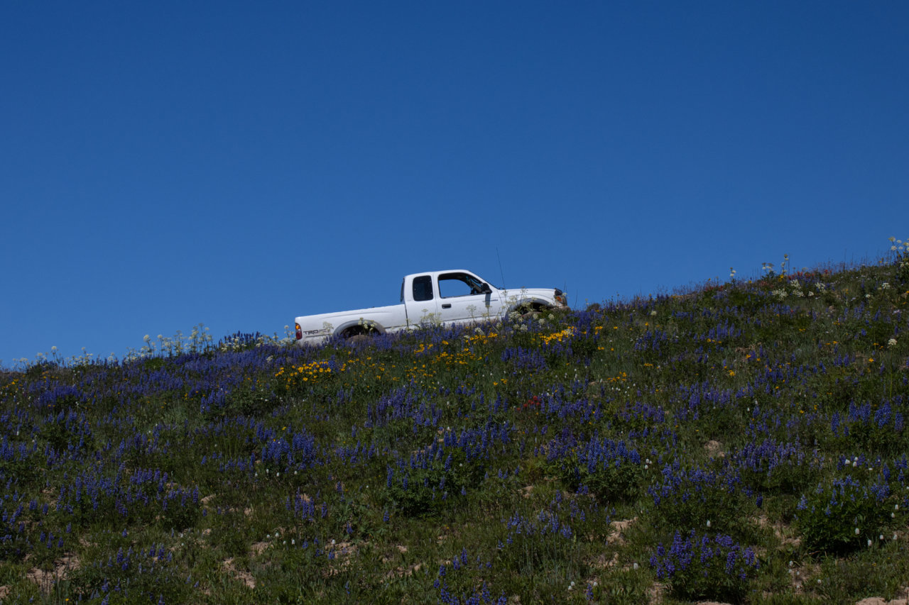

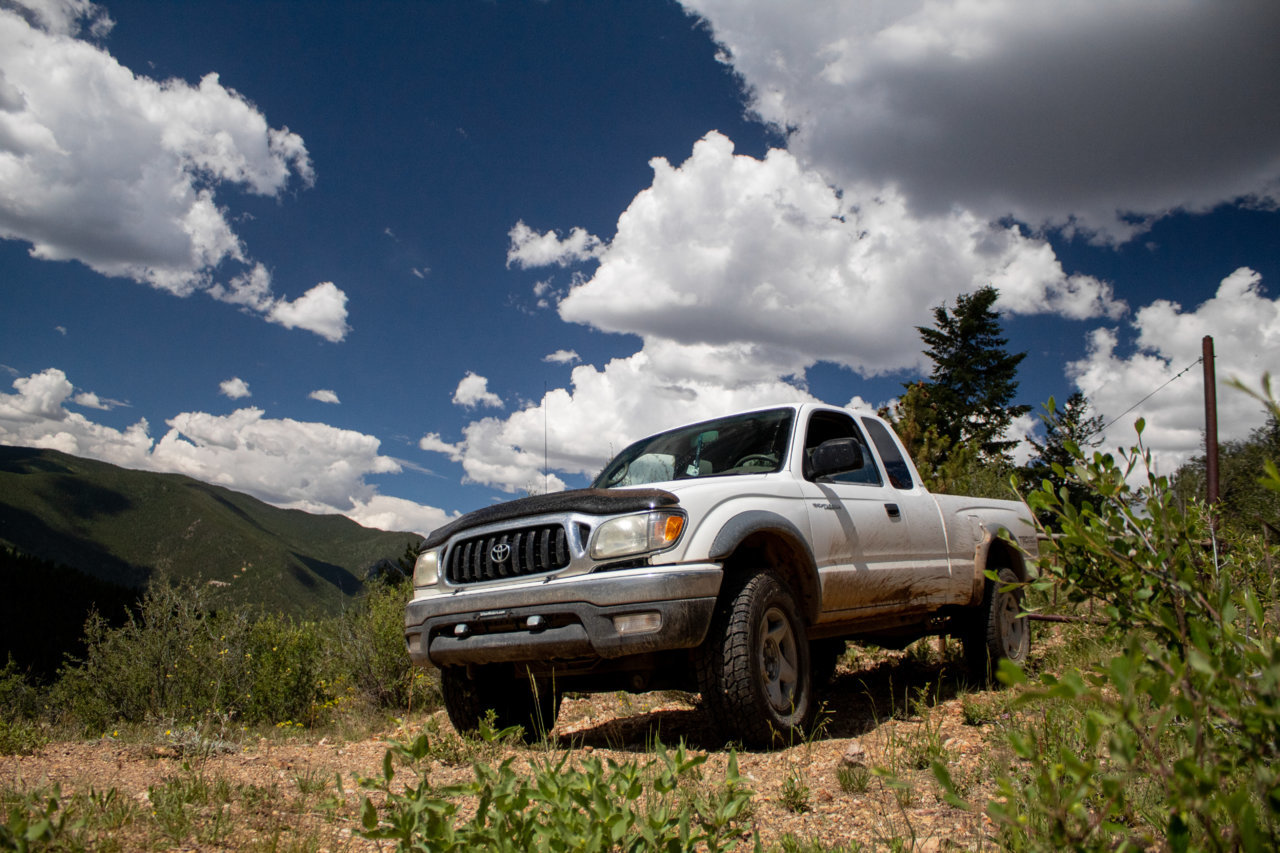

    2002 White Tacoma TRD
    Hi! I bought my 1st-gen last May and since then I've done a little trail running and some maintenance and dreamed and planned about what I want to do, but I have very little money to actually do any of the things I want to. So, I'm making this to write down what I've done to her and the problems I'm having and what I want to do in the future. This might be me soliloquizing, so be warned.
