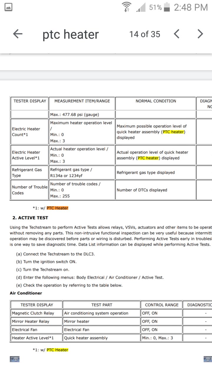

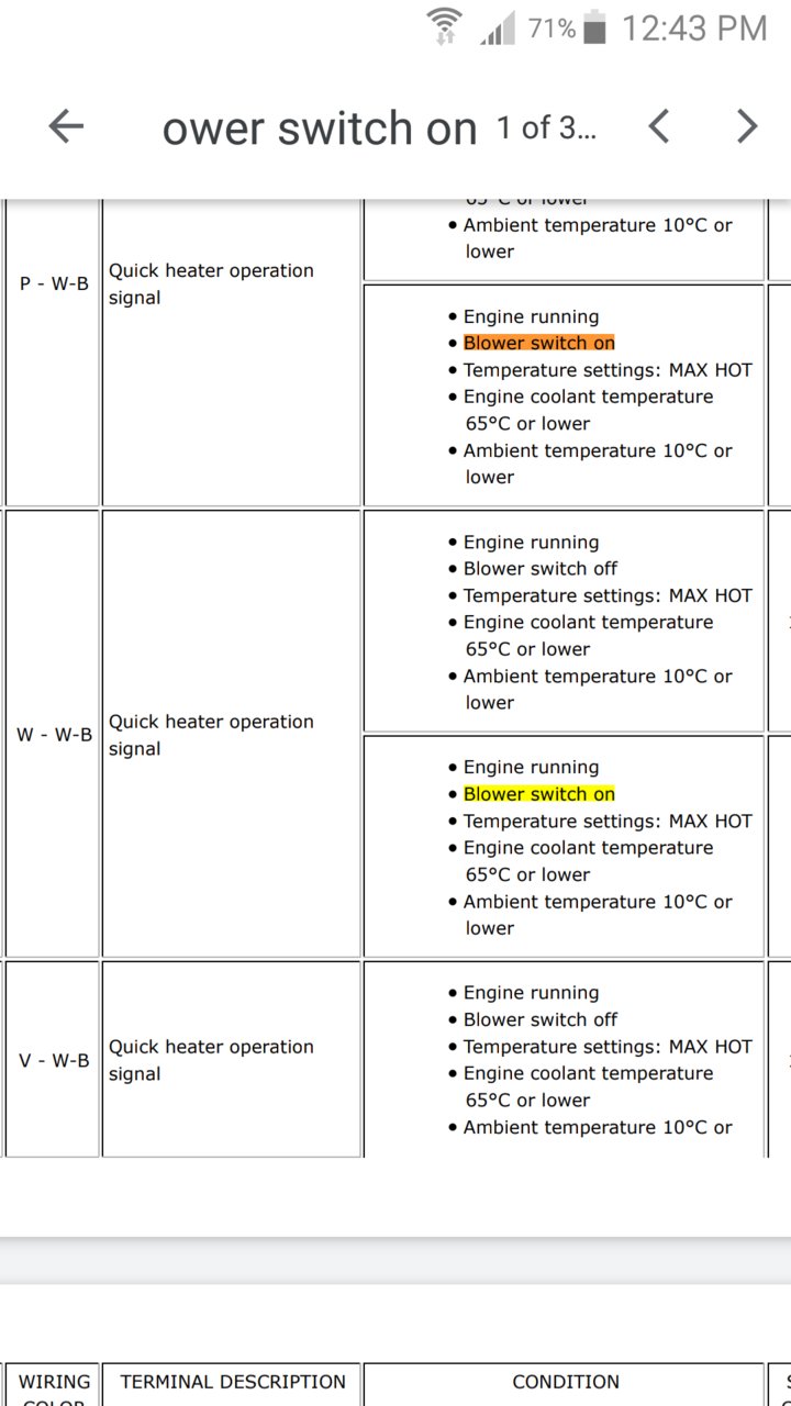

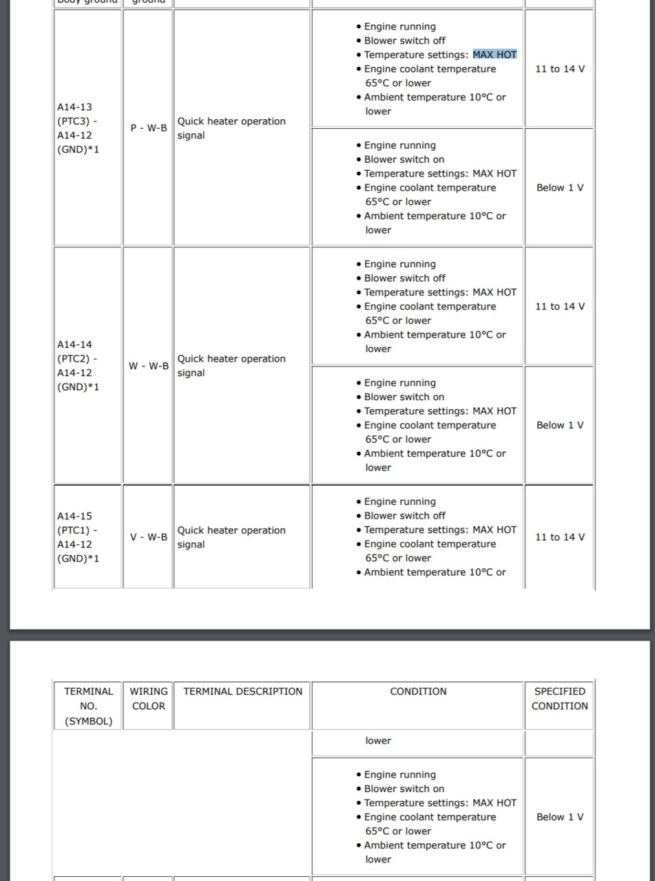

    No...it's in the service manual.
    That link you posted is some kind of abbreviated online version of it.
    I've been posting the conditions necessary to enable the PTC heater, from it, for a while now. Pobably the first.
    https://www.tacomaworld.com/threads/electric-heater-element.523097/#post-16622392
    Here's a link to the complete 2016 fsm. Search, "quick heater" and/or "PTC heater".
    https://drive.google.com/file/d/1mxxtpbUP_3mJSCP8SuvKHp9_ldml-YST/view?usp=drivesdk
    Bob K[QUOTED], shakerhood and tonered like this.

  15. Aug 15, 2021 at 11:59 AM
    #35
    Bob K
    Bob K Well-Known Member
    Jan 1, 2020
    #314882
    73
    Bob
    2017 TRD Off Road
    Thank you. That did it. Also nice to have the service manual in pdf format.
    How odd that a very important feature requires specific settings but isn't described in the owner's manual. The curious side of me still wonders if these steps are merely troubleshooting steps for quickly checking operation of the PTC versus instructions for how to activate the system. In other words, these steps might be a way for techs to quickly get the system turned on versus being manual steps that have to be met in order to turn the PTC on. I'll do some testing come wintertime to see if "Auto" or a temp other than MAX HOT activates the PTC.

    Just a fyi, if you didn't already notice...
    There are three levels to the PTC heater; four if you count "off". This, to me, would infer at least ambient temp is used as a parameter for activation of the different levels.
    If you wanted to get real nerdy, monitor the levels(available & actual heat) to see if it does correspond to ambient temp.
    shakerhood and Bob K[QUOTED] like this.
