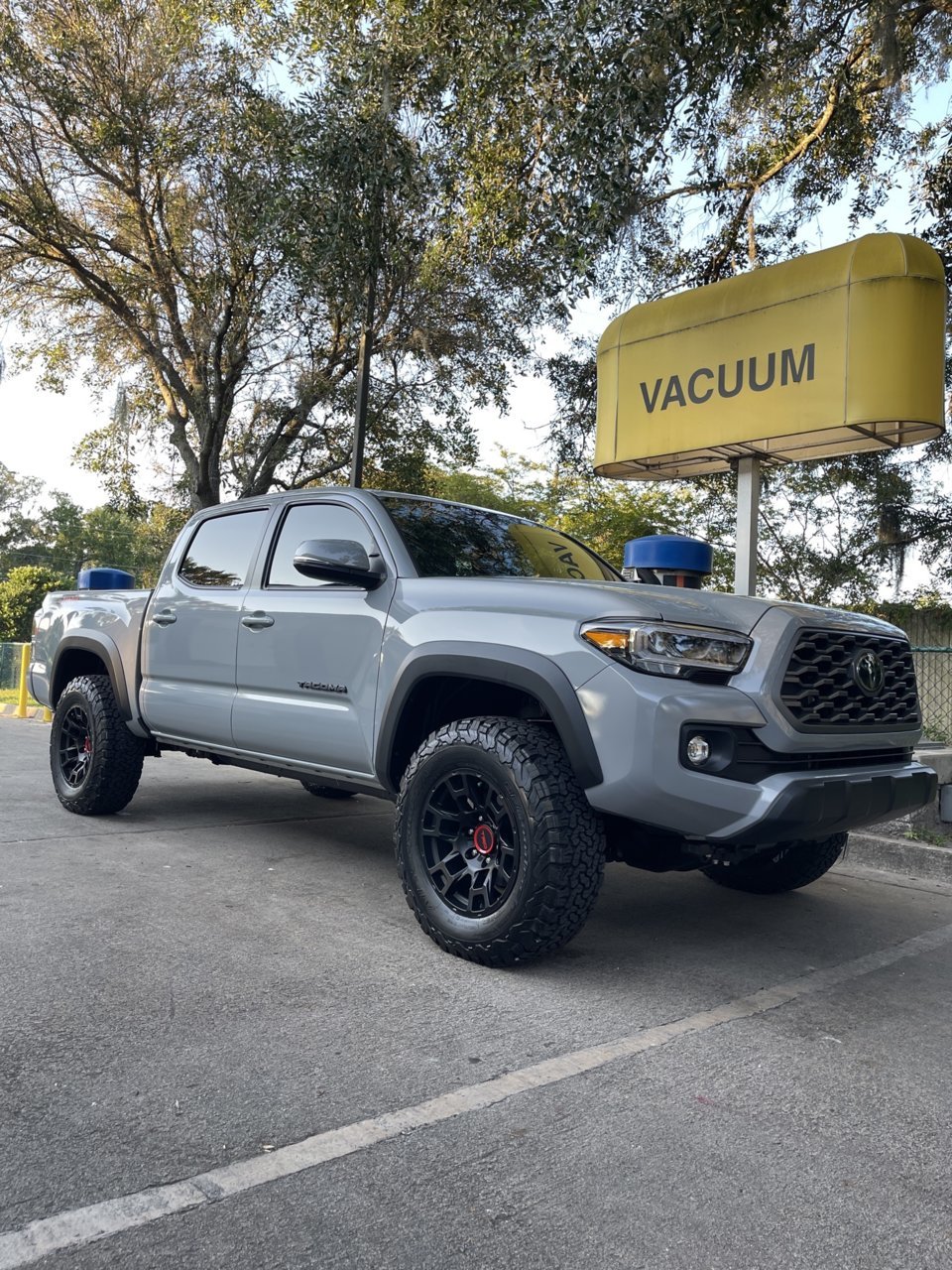

    The replicas from Factory Style Wheels fit perfectly. Doesn’t have any interference with the hub unlike the OEM 4Runner wheels.001D03F7-A3E6-4486-A674-7D763FA6167F.jpg

    Those look rad. What are the center caps? Factory ones fit?

    Fantastic looking!! What offset are they? Thx
