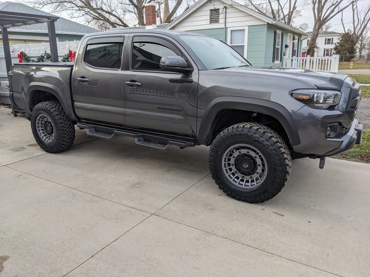

  6. Apr 18, 2021 at 8:27 PM
    ryan20021982
    ryan20021982 Monochrome Tacoma
    Apr 28, 2020
    #326191
    173
    Illinois
    2020 Tacoma TRD Off Road
    Icon Stage 3 Fuel D726 17x9 -12 Falcon Wildpeak M/T's 285/70/17 Pro style headlights Auxbeam high and low beams Morimoto xb fogs Pro grill Smoked raptor grill lights w/ drl harness from r4t Hidden grill lightbar Anytime camera kit w/ front camera AVS bug deflector AVS window visors Meso ultimate turn signals Winjet smoked tail lights OEM tailgate lock kit Tinted windows APS iArmor Side steps Taco tunes 4ch and subwoofer amp All Kicker speakers Fox acoustics dual 10" box w/ Kicker subs All Meso interior lights Meso chrome interior delete kit Meso door handle covers Meso Stealth Pro shift knob Trd black exhaust tip Demon front hook mounts with hooks Spotter mirror glass Wheelers superbumbs w/ ubolt flip kit Durobumps in the front
    So you lifted the front 2" with a 1" block, if that's the case then yes a common spacer lift is 2" front 1" rear
    Noswar5[OP] and waltuo like this.

    This is a 2/1 spacer lift I had on to fit my tires while waiting for my Icon setup to come in
