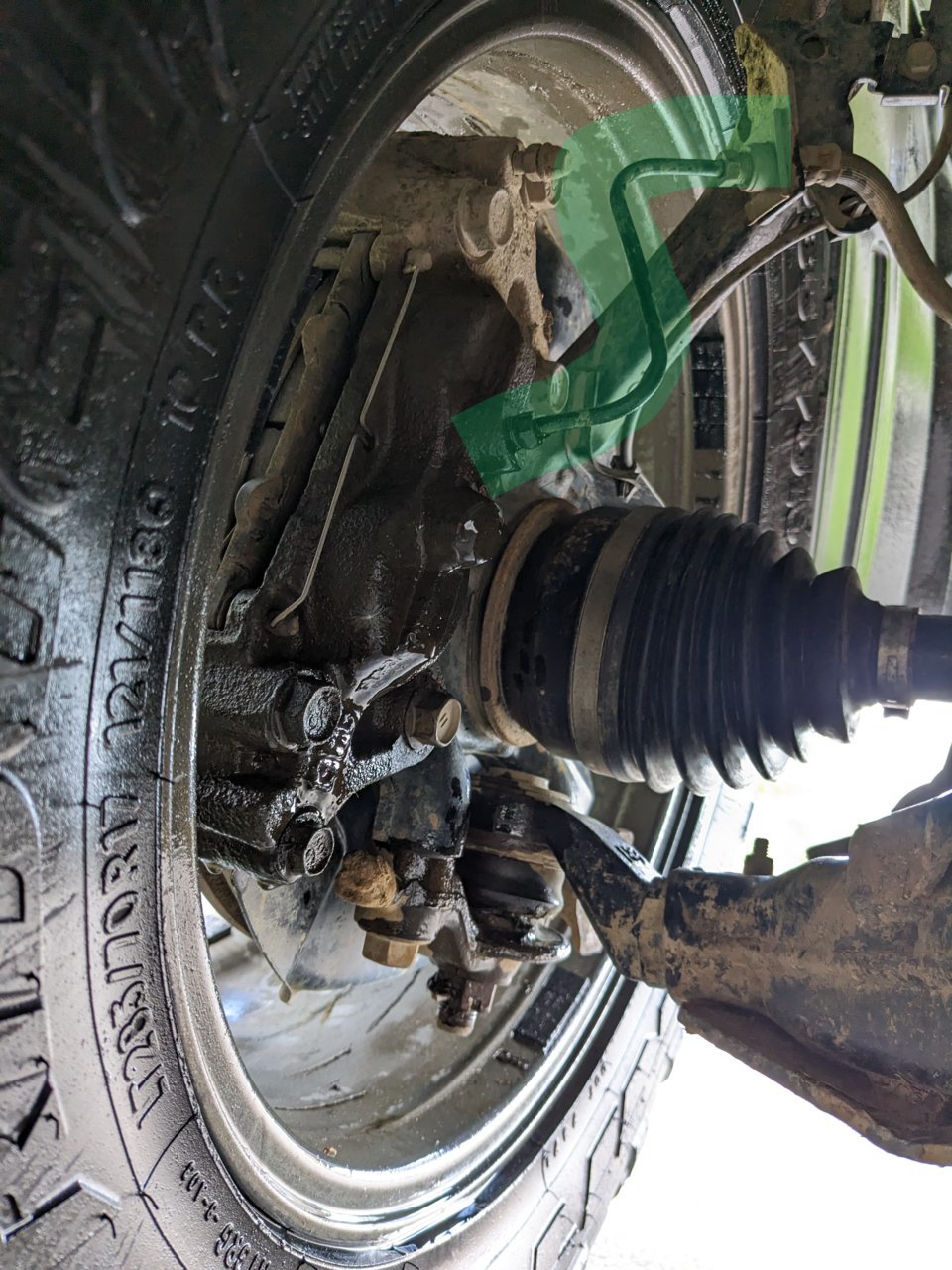

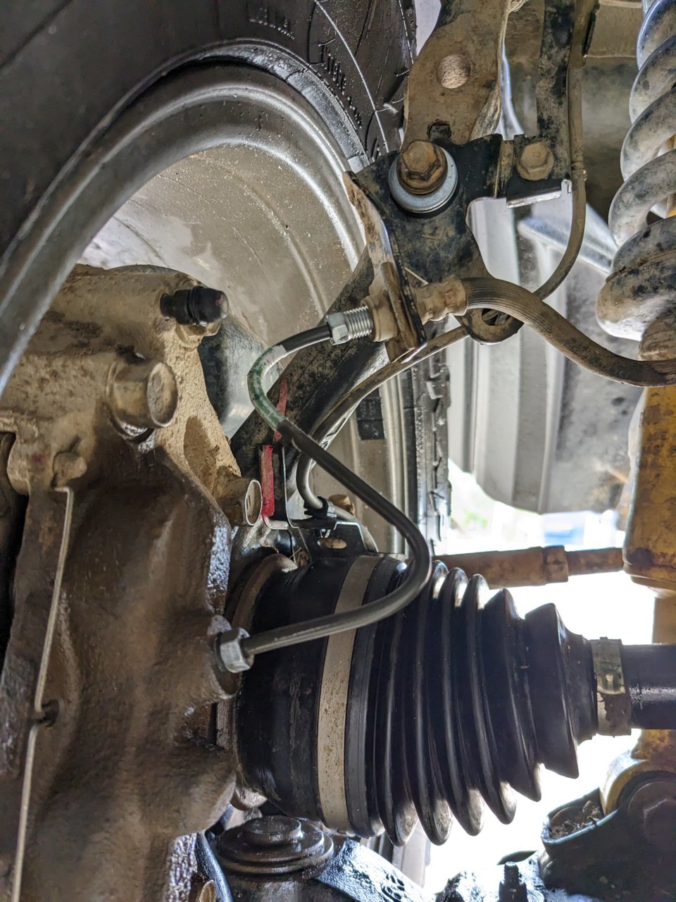

    Brake fluid just pouring out of this mf'r.
    Had to walk 3.2 miles (after running club lol) to get parts.
    Parking lot fix, booya. Gona do some OEM hardware replacement this week on both sides to make sure she's in tip top shape

    https://absolute-wits-end.com/emergency-brake-line-plug-m10-x-1-0/
    Every offroad Toyota should have at least one on board.

    The screw holding the plate that stabilizes the ABS sensors had worked its way out and disappeared sometime ago. My guess is that between corrosion and that bracket flapping around the steel brake line had worked itself loose and developed the leak. That morning. I felt like my brakes were slightly spongy but when I got into the truck later I had no brake pedal at all. Anytime I pressed it fluid would just jet out of the break in that line.

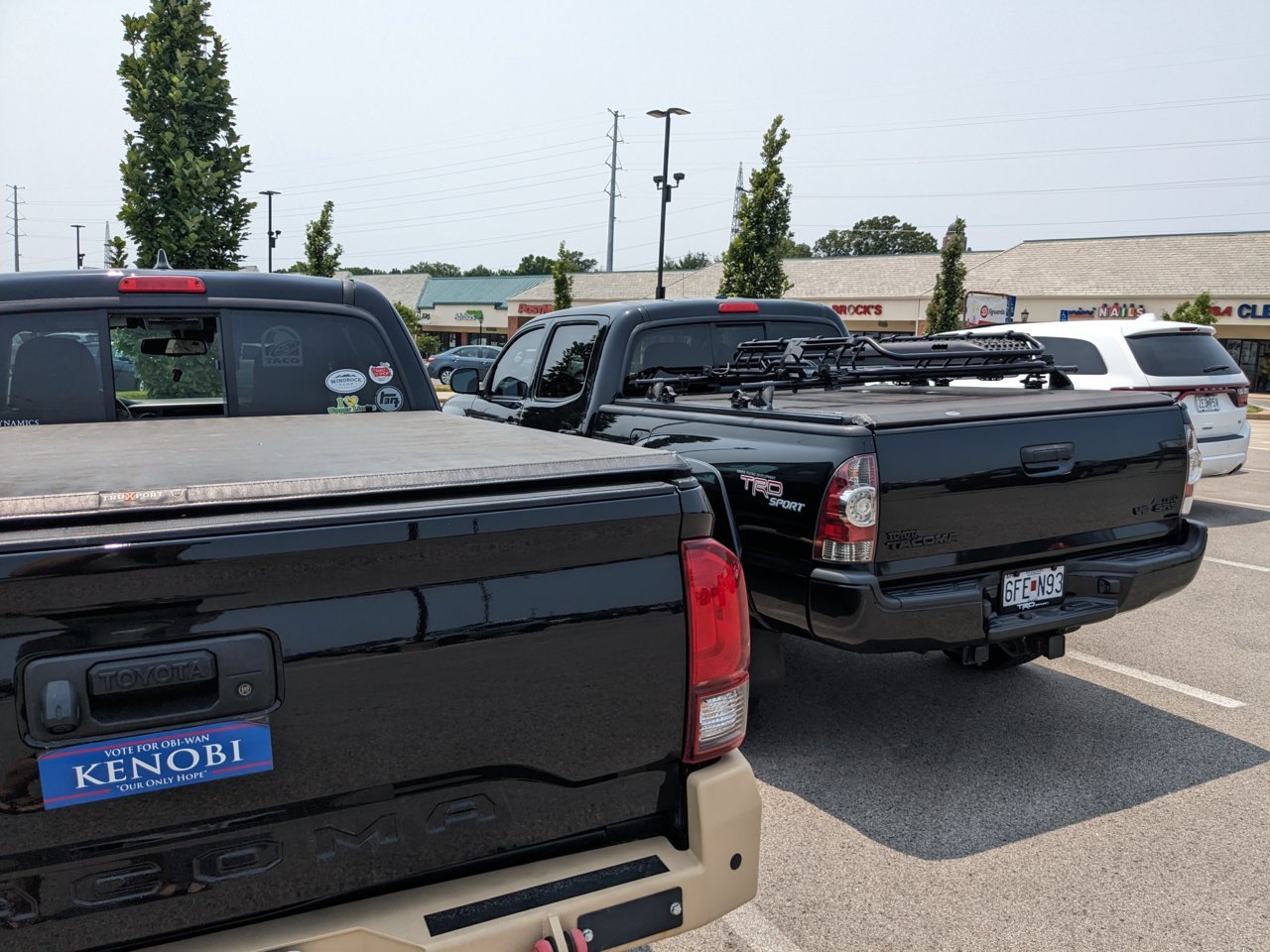

    When you run into your Taco buddies at the grocery store
