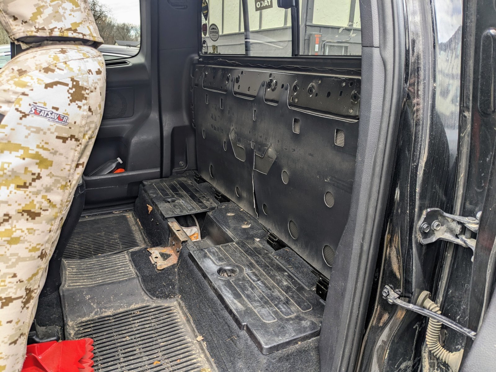

    Hasn't been this empty in a long time

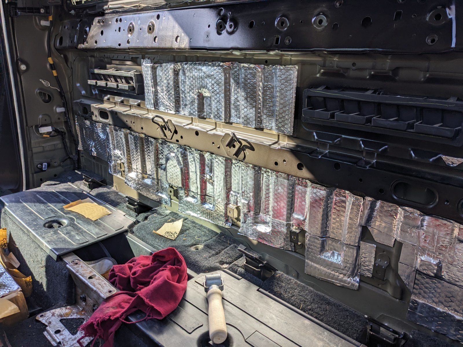

    Cutting up scraps from a other project to make it all fit.

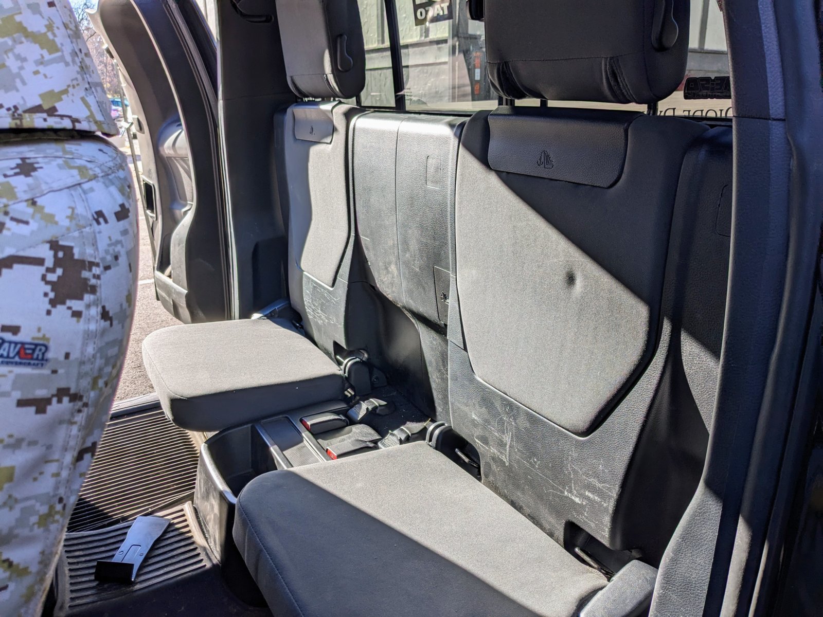

    Got the dynamite in, got the Harbor Freight floor mat in, got the original sound editing over it, and somewhere I must have covered up a clip hole because the top is not anchoring correctly. And I still need to source rear seat belts but that'll be a while because they are not cheap

    And I just found the issue I was having, I forgot there are three 10 mm bolts that hold the top of the seat back on, the bolts were still in the hole. So of course the seat was impacting them and not allowing all the clips to engage. Fixed that issue. Got everything cleaned up and I'm about to take it for a test drive to see how much all that sounds stuff helps. I have high hopes

    Not pictured: I also did the insides of the B pillars up to about where the seat belt would be installed (If I had them!)

    I’ve heard the dynamite stuff helps with these trucks.

    I put dynamat in mine. Dynamite sounds like a bad idea though
