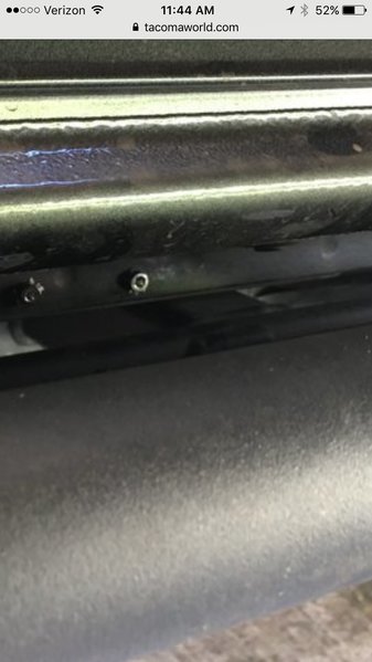

    Interesting. Doesn't the main slider basically sit right underneath the pinch weld? So your saying, no matter where I mount these along the pinch weld, the sliders won't block the lights?

    There is quite a bit of space between sliders and the pinch weld. Plus, the lights are flush with the bottom of the pinch weld, so they don't hang down. The main tube on my sliders is outside of the pinch weld and the lights will be behind the pinch weld, so the lights will be behind the main tube. You have to place them somewhat close to where instructions say to measure or the wiring will be too short. The light are not directly above any tubing on my sliders for double cab. I also ran my wire from passenger side under the truck and all the wires through the grommet under the seat. It is a bitch to fight getting anything under the carpeting and across the inside.

    Ok great- thanks for that.
    So basically, If I follow the directions, I'll have no conflict with Mobtown sliders.
    Good to go. Thanks!

    Eagle- or anyone else with Mobtown sliders-
    The 2017 instructions say to mount these puddle lights inboard- centered on the 3rd grommet from the front and rear.
    Staring at the picture posted by Eagle here, if I do that, the puddle light will be covered by the slider support bar.
    Can anyone with mobtown sliders check the location of where he support bars are in relation to the grommets underneath.
    I really don't want to drill these in the wrong place and have the sliders interfere..
    Please IM if you can help.
