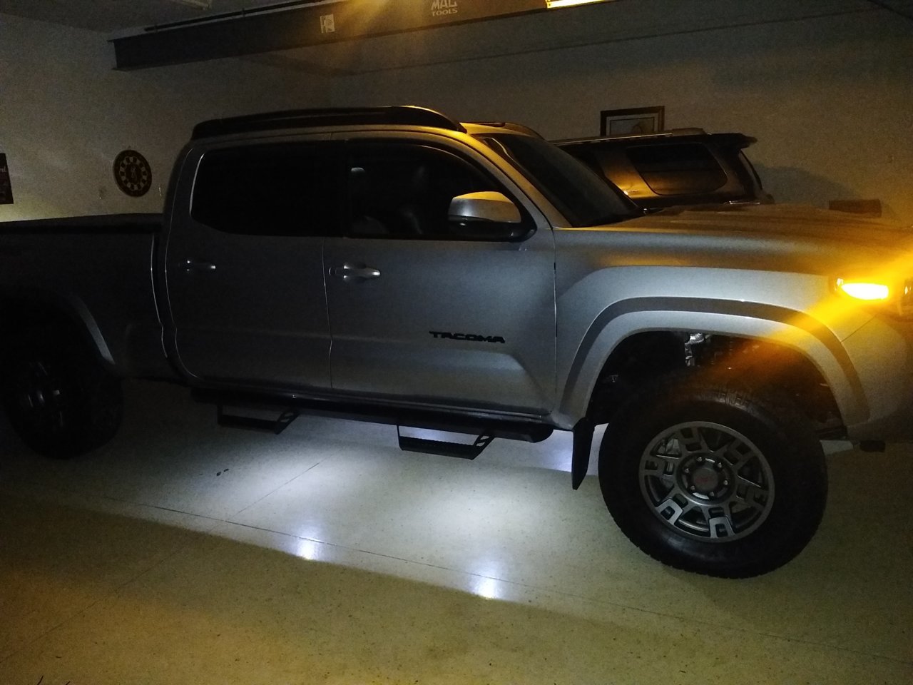

    Got my own kit today from Sparks Toyota. Let the install begin. Getting everything set up, hopefully it goes well.

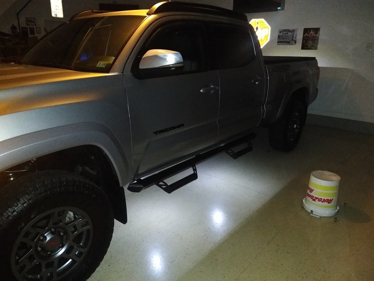

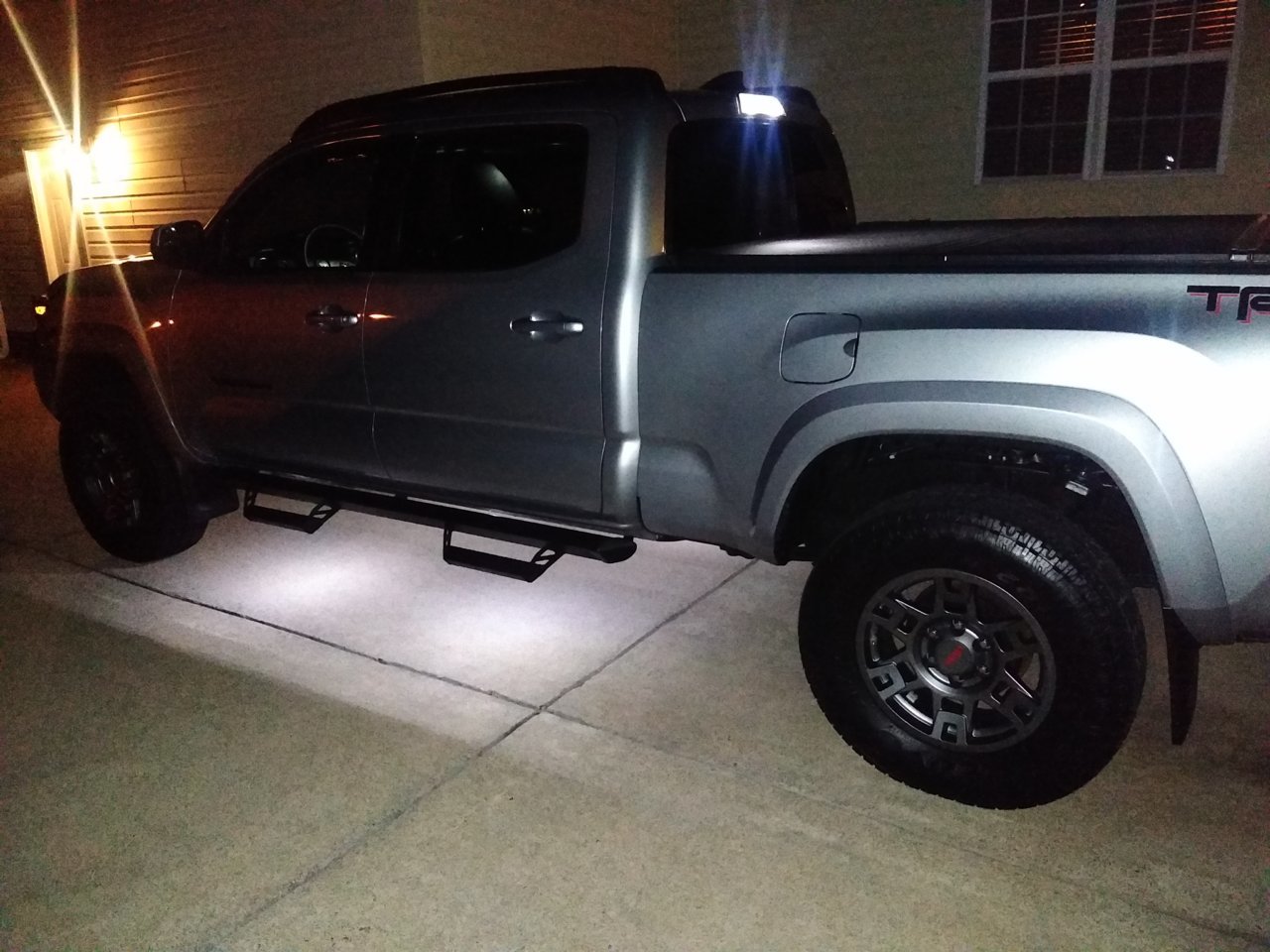

    Well it took me about 3 hours, went well. I was very particular and patient with the install. Directions were spot on and very detailed. Nice OEM looking fit and finish. Very nice mod, plus I did all new interior led light swap too. The lights are very bright, nicely placed and work great lighting up the step bars. I'm very pleased with the outcome. Get some clear silicone sealant, I didn't use the foam tape or the tape provided. I did run the wires from the pass side along the top of the carpet. Then tucked the wires doun about 6 inches. That was pretty easy as I was sweating fishing the wires through the bottom. They really give you everything you need. All In all I think it went perfect, its a lot to do but well worth the outcome and the lights give the truck a nice upgraded look.IMG_20211001_225806114.jpg IMG_20211001_223633464.jpg IMG_20211001_225806114.jpg IMG_20211001_225806114.jpg IMG_20211001_225837057.jpg IMG_20211001_223633464.jpg

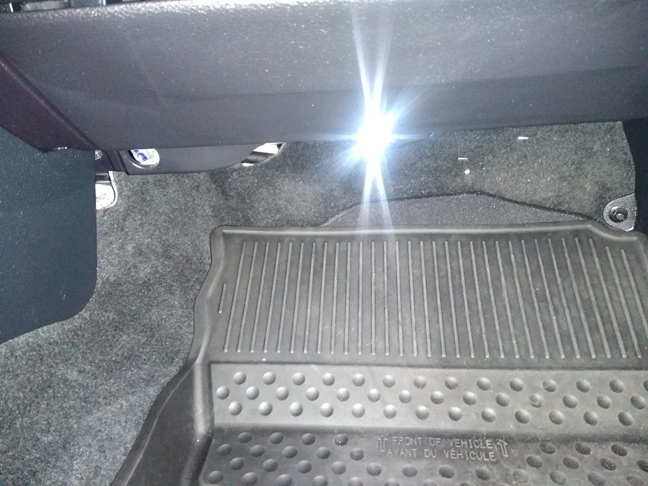

    @mds08 that's awesome! Looks great (and a little quicker than I expected). Did you happen to take any interior pictures w/o the camera flash? I was wondering how the predator steps would interfere with them but doesn't look like much.

    Thanks, I will take some pics later and will post up tomorrow. The steps do not obstruct the lights at all, in fact they somewhat light the stops up some. The lights under the dash do dim to a nice soft dimmed light. which I like. I also ran the wires from the puddle lights under the truck in a small wire loom for that oem look.
