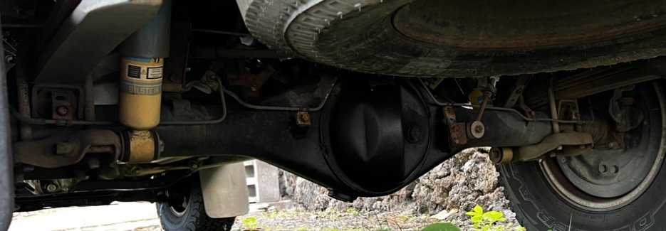

    Seems like a pretty good deal to me regardless of location. The A340F trans is usually pretty stout and dependable. It is a bit of a power hog and many of its detractors will point to that as a problem. What is actually wrong with the one in the truck? $700 is a good price for a low mileage replacement.
    Where is the (rear?) diff leaking from? Is it the pinion seal? As long as the pinion bearing is good, the seal itself is fairly simple to fix. If a bad pinion bearing has caused the seal to go, there you are looking at a diff rebuild.

    Appreciate your input. I don't actually know the exact problem with the trans in the truck. The owner noticed something with the trans, took it to a trans repair shop and diagnostics came back ok. Shifted ok, torque converter ok. Then a couple weeks later he was going up a steep hill and it would build pressure but not shift. He called the trans shop they discussed a repair/rebuild for ~$4500+. The trans shop advised it COULD be just the pump, but again this is discussion only he didn't inspect it.
    Here's a pic of the diff - I just seen leaks but I didn't inspect it closely. I just assumed needs a new one but yes that maybe it's just a seal.

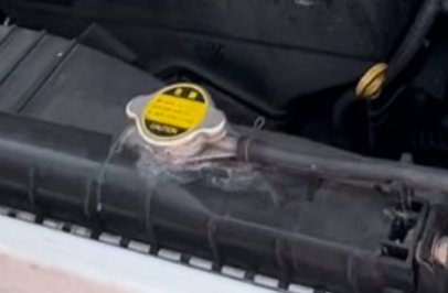

    You can certainly rebuild it if that is what you're wanting to do. Need to diag exactly what the problem is to really determine what is involved. Have you driven it? Get the trans up to operating temp and drive it - do the hill thing also. See if you notice anything.
    This is something else to look at - probably just a new cap but I'd check it.
  20. Mar 30, 2023 at 1:17 PM

    Nice catch, didn’t notice that, need to see why there’s fluid/residue there.
    Haven’t driven it yet but will do when I go this weekend, will recreate hill test.
