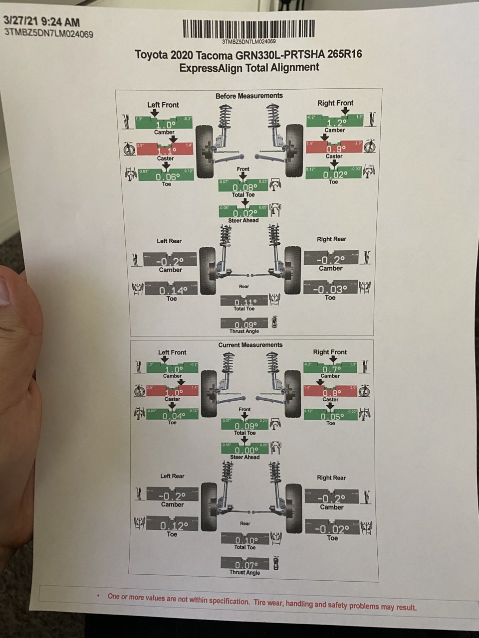

    Any chance on posting the specs you got after you had it done ?

    yeah I'll post pics gimme a few minutes!
