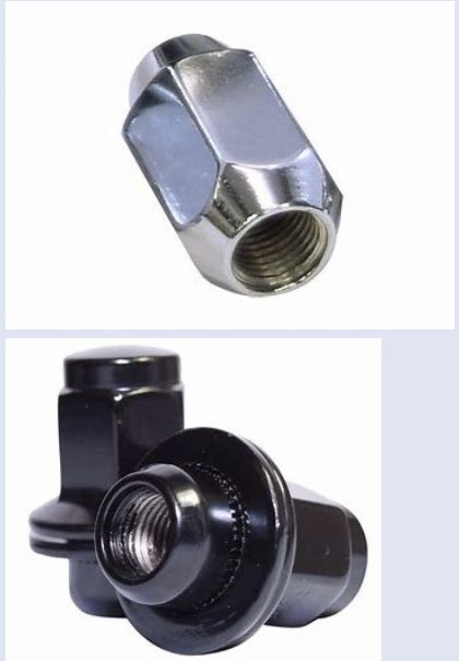

    It's because of the lug nuts, the factory nuts are designed for alloys and have a chamfer but its not suited for long term use on steel rims.
    That said lots of my customers run steel rims for winters and run the alloy lugs no issues (except swelling)

    lug nuts.....get some steel wheel ones

    Top picture is steelie ... cone is more defined than the "flat ledge" for the mags on the lower lugs.
    SUPER HELPFUL @RIX TUX has the Toyota part numbers and is willing to lord the knowledge over me. :boink:
