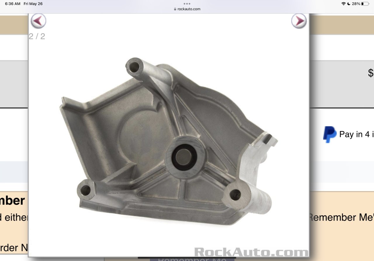

    Ok, I meant the idler pulley which essentially has a bearing part of it

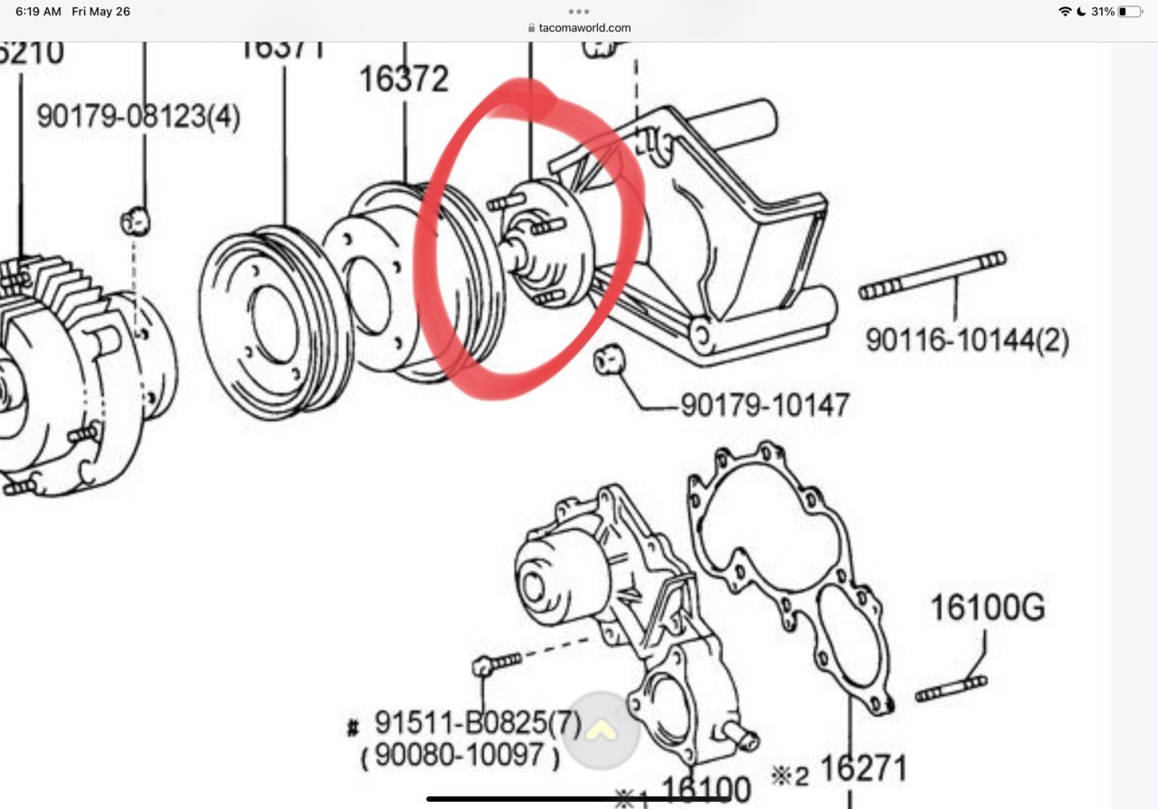

    I'm thinkin' I need to do some research & a little more stethoscoping. The left side of the pump is the oil cooler part, so I should probably take the scope to the oil cooler itself. It's possible the noise was reverberating through the alternator since it's right there. However, still need an explanation for what I see as a wobbly water pump/fan pulley. I looked at a parts diagram & don't see any bearings, although that makes no sense to me....
    The alternator belt is indeed showing signs of uneven wear....

    Fan bracket bearing?

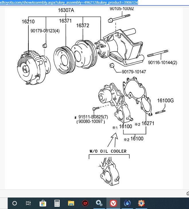

    See? The toyota diagram is lacking in anything like that.

    The fan bracket bearing is part of the whole bracket.
    You can’t buy just the bearing

    Ok. Thank you. My bad. I didn’t look further at that part. I also got a little weirded out because the 1st site I went to for the diagram was Toyota of Smithfield & the site has changed. No more diagrams. I really rely on those. & the site is one of those sort of carbon copy ones, so I can’t help wondering if it’s a Toyota decision. In other words, are others soon to follow….

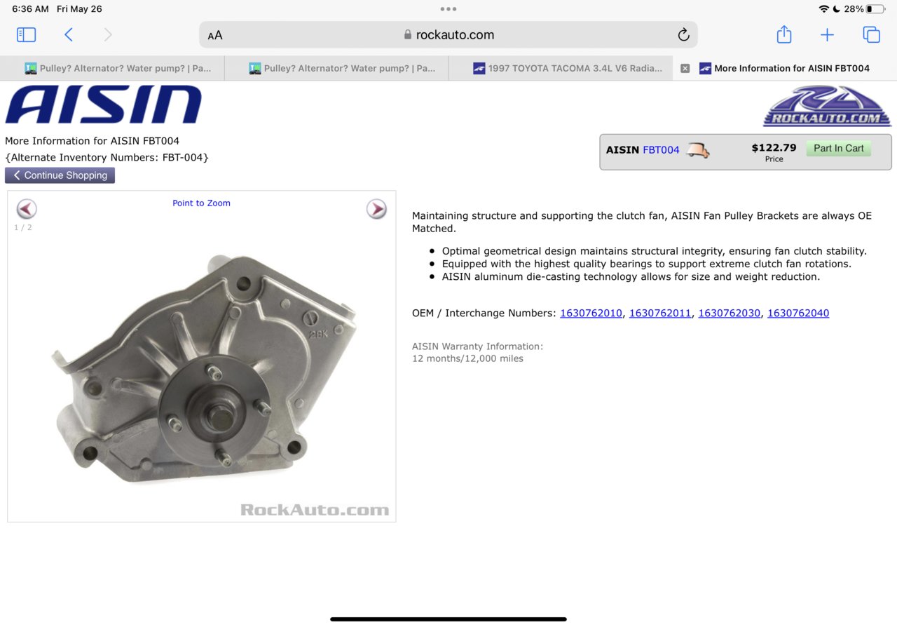

    If you have a wobbly on the pulley (I can’t see that) that goes to the fan bracket it’s probably the bearing that’s bad, Sometimes this bearing locks up and other times it just makes noise that comes and goes.
    Rock auto has the complete bracket,
    I replace this bracket whenever I do the timing belt
    https://www.rockauto.com/en/moreinfo.php?pk=1871554&cc=1279009&pt=11548&jsn=401
