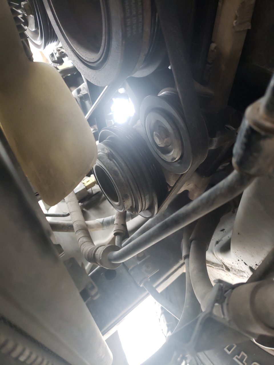

    Is that my idler pulley in the middle ? Or which one ? It is not moving when the truck is running. It also seems to move very slightly when you touch it, as if it's slightly loose . I tried to tighten the bolt but cant seem to tighten it anymore.

    That's the AC compressor clutch pulley, it only spins when the compressor is running

    So you mean when the AC is on ? I turned on my ac to see if it spun then and it did not.

    If the belt is to loose the pulley might not spin.
    If the pulley bearings seize up it will burn the belt off in a few seconds with the lovely smell of burning rubber.
    Sometimes they look like they are not spinning from lack of light and no point of reference to tell that it is spinning

    Middle pulley is the tension idler pulley. Loosen the center bolt to adjust from below 14 mm bolts if I member erectly. You can loosen and check for free spin by hand.

    Thanks guys . Anyone have a good link to tighten the belt, replace the pulley, etc ? Any information would be great ! Much appreciated

    It sounds like the bearing is out on your tensioner pulley . Dont run the truck or you will tear the belt up . Get a ratchet on the nut with a cheater and pull on it and then pull the belt off of it . Then try to spin pulley by hand . If its grinding or hard to turn or wiggles sideways then it bad . Remove nut and take it off . Real simple job just keep the belt on the rest of the pulleys .

    Video would get a more positive reponse what's going on. I'm still not sure what you're talking about.
    If you have a seized bearing, you'd have smoke pouring off and the belt will last about 3 minutes.
