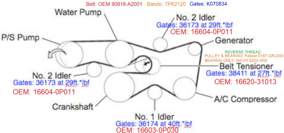

    I made up this diagram for myself (building off someone elses that had the gates #'s) a couple weeks ago while I was replacing stuff and comparing prices and reviews and stuff. You can press the NACHI bearing into the OEM tensioner pulley but if you want a new pulley you can get the Febest and replace the cheap chinese bearing with the Nachi one, both from Amazon. I ended up getting an OEM tensioner for 100 bucks and unbolted the pulley and swapped it over since it was gonna be like 65 or 70 for the febest and nachi combo anyways, and I plan on keeping the truck a long time so now I have the tensioner assembly when the time comes for an extra 30 bucks. Swapping all the idler pulleys was super easy though, just make sure you remember the tensioner one is left hand thread.

    Yeah with the mileage I think using the OEM pulley makes the most sense, a few extra bucks to have a tensioner on hand in case it ever fails. Plus that's using OEM parts.
