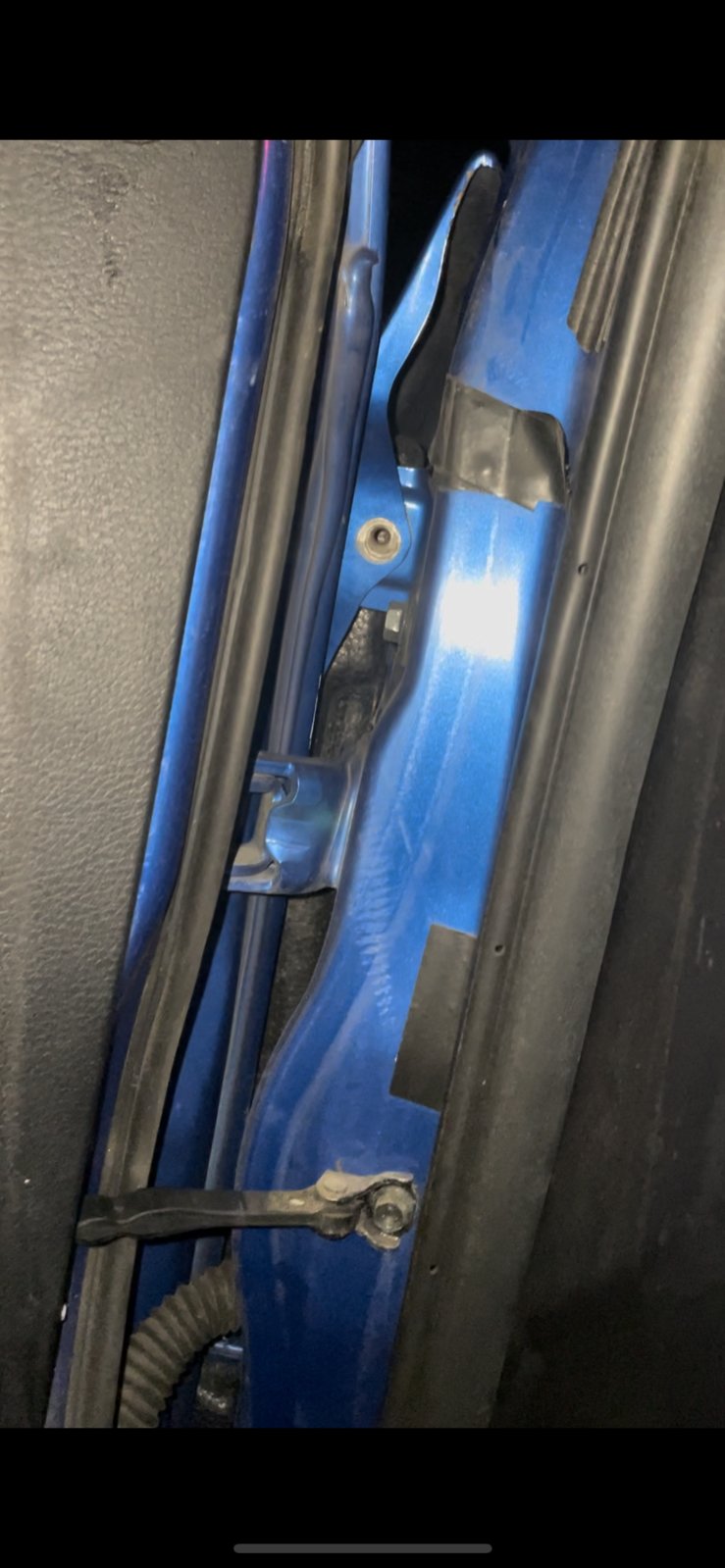

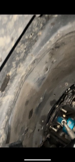

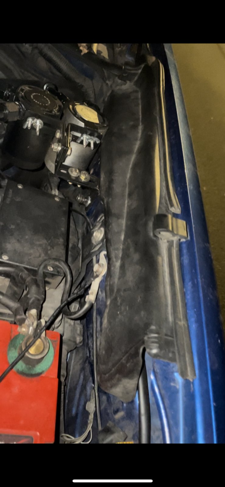

    Front right and driver side fenders are the same. 10mil bolts along the top of the fender line in the engine bay, you have to remove the little angled trim but they’re just pull tabs. One bolt at the bottom, one inside the fender accessible through the panel gap with the front doors open. You’ll also have to remove the fender liner screws. Also 10 mil. Just unbolt and tug super lightly and look for the point that isn’t freeing and you’ll find the bolt. The sheet metal is stupid thin, if it isn’t moving don’t force it or you’re gonna be in for a new fender paint matched.

    And a couple where the fender meets the bumper cover, and one attaching the fender to the headlight itself below the bumper which you can access somehow, I have up and ripped the thing off.
    and another attaching the top of the headlight

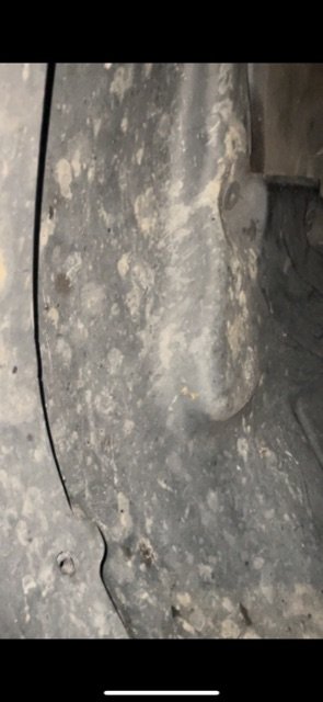

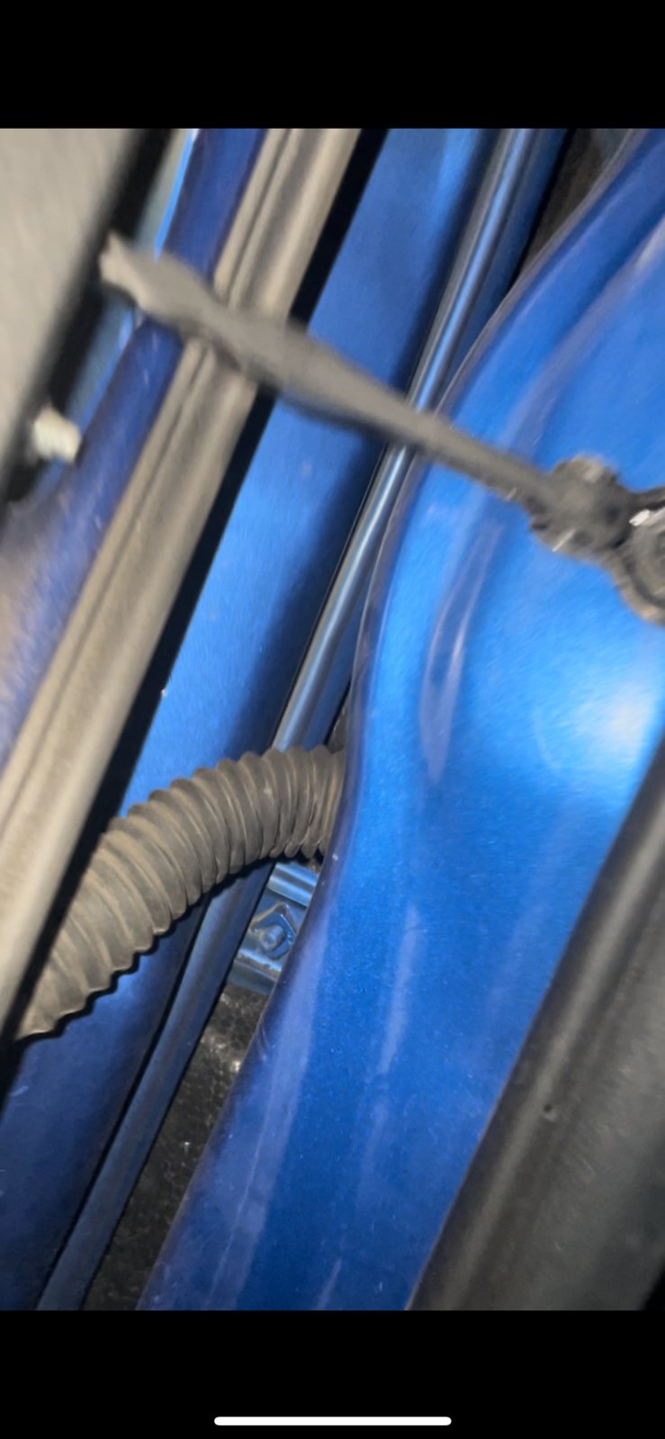

    Bumper doesn’t need to come off. When you unbolt the dust shield you can pull it down and out, then reach the bolts holding the fender to the bumper bracket made of plastic. Should be able to reach the headlight bolt through the gap
