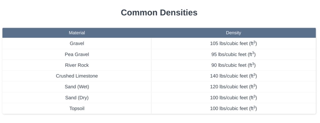

  9. Sep 29, 2024 at 6:21 PM
    RustyGreen
    Aug 12, 2020
    #337468
    14,428
    sleeping in a chair
    2017 AC 4x4 Sport 6M Inferno
    Pavement Princess
    This :thumbsup:
    Dirt, gravel and related products add up much faster than you might think.
    As an estimate, gravel around weighs 100 pounds per cubic foot.
    If you load a 5x8 trailer 12" deep that is 4000 pounds not including the weight of the trailer.
    A 4 cylinder truck rated for 3500 pounds.
