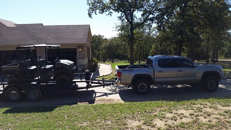

    I took my 16 off road to the ranch this weekend for opening weekend of rifle season. I have a 4010 Trans 4x4 mule that I tow on a 16x6.5 tandem axle trailer.i was very impressed at how the taco pulled the trailer. The down side is that my mpg went down around 9-10. I was considering downsizing trailers to a 12x6 single axle for towing my mule. Anybody have any experience with this? Kind of curious of the lighter trailer will make much of a difference in the mpg.

    Trucks are too new for those questions so far.... give it time.
    BTW, what's up with your garage roof shingles? Roofers used a different shade of color in areas?

    Lol Had to go look at it in person must be something in the picture, cause it doesn't look like it in person.

    The false colors in the roofing shingles is a phenomenon called "moire" and is common with digital cameras when they photograph anything with a repeating pattern, like a brick wall, or roof shingles. Basically, a digital camera has a grid of light sensitive sensors inside (measured in mega-pixels) and repeating patters of a certain size can cause false colors and other phenomena in the image. Just refocusing, or changing the angle or distance to the subject can reduce or eliminate it.
