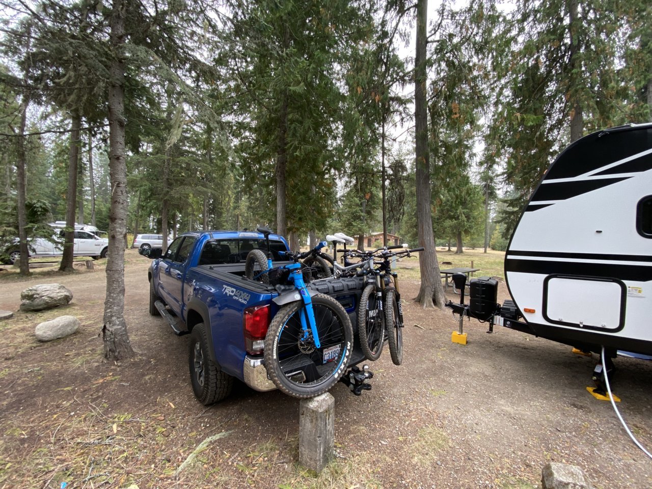

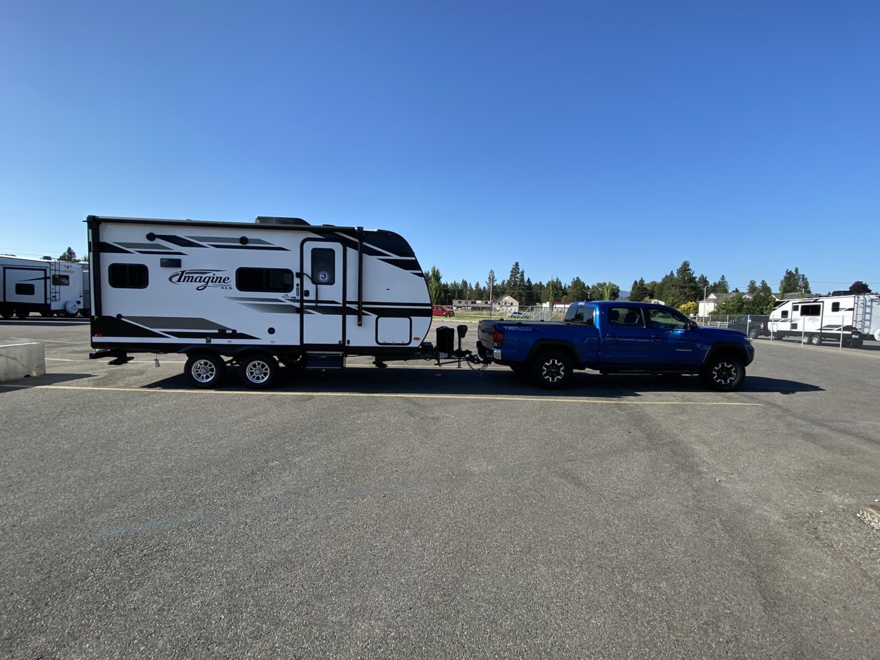

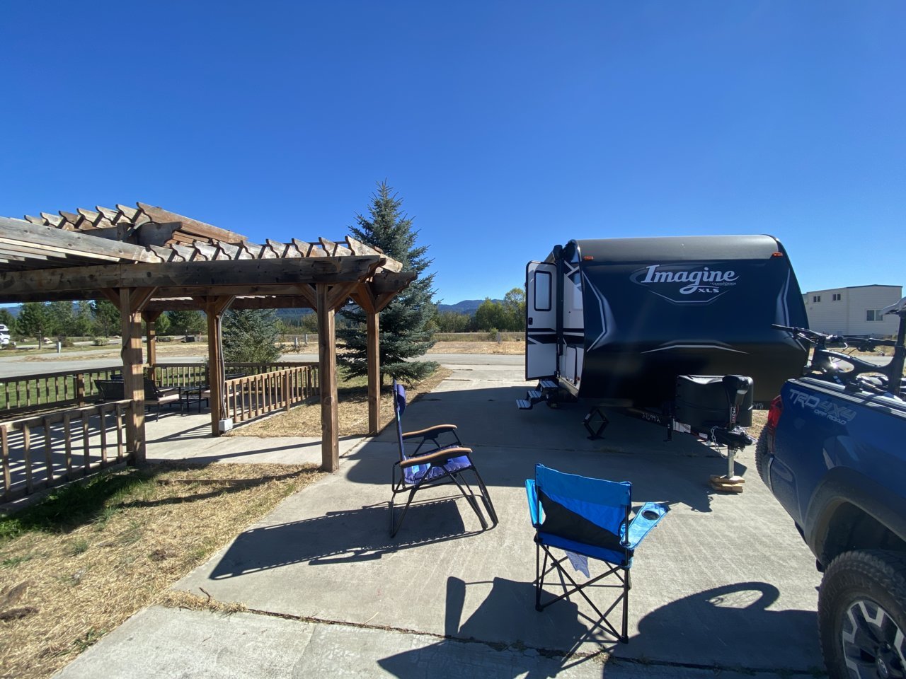

    You mean like this one. B2B5E3D6-A9BE-4F2A-9105-8B2ED33C47A3.jpgThat I bought this year. Have taken it out three times. Once over 4th of July Pass in Idaho. Not a huge pass but steep enough. Up to Priest Lake ID and other trip in NE WA.
    you can PM me for more details if you want.
    I have Roadmaster stabilizer springs. Equalizer E2 8000 lb hitch the torsion bar version. Tow in S4 max with ECT On.
    Now I have the OV tune. Regular gas basic tune so far. Huge improvement. HUGE. Like someone said it is the tune Toyota should have used.

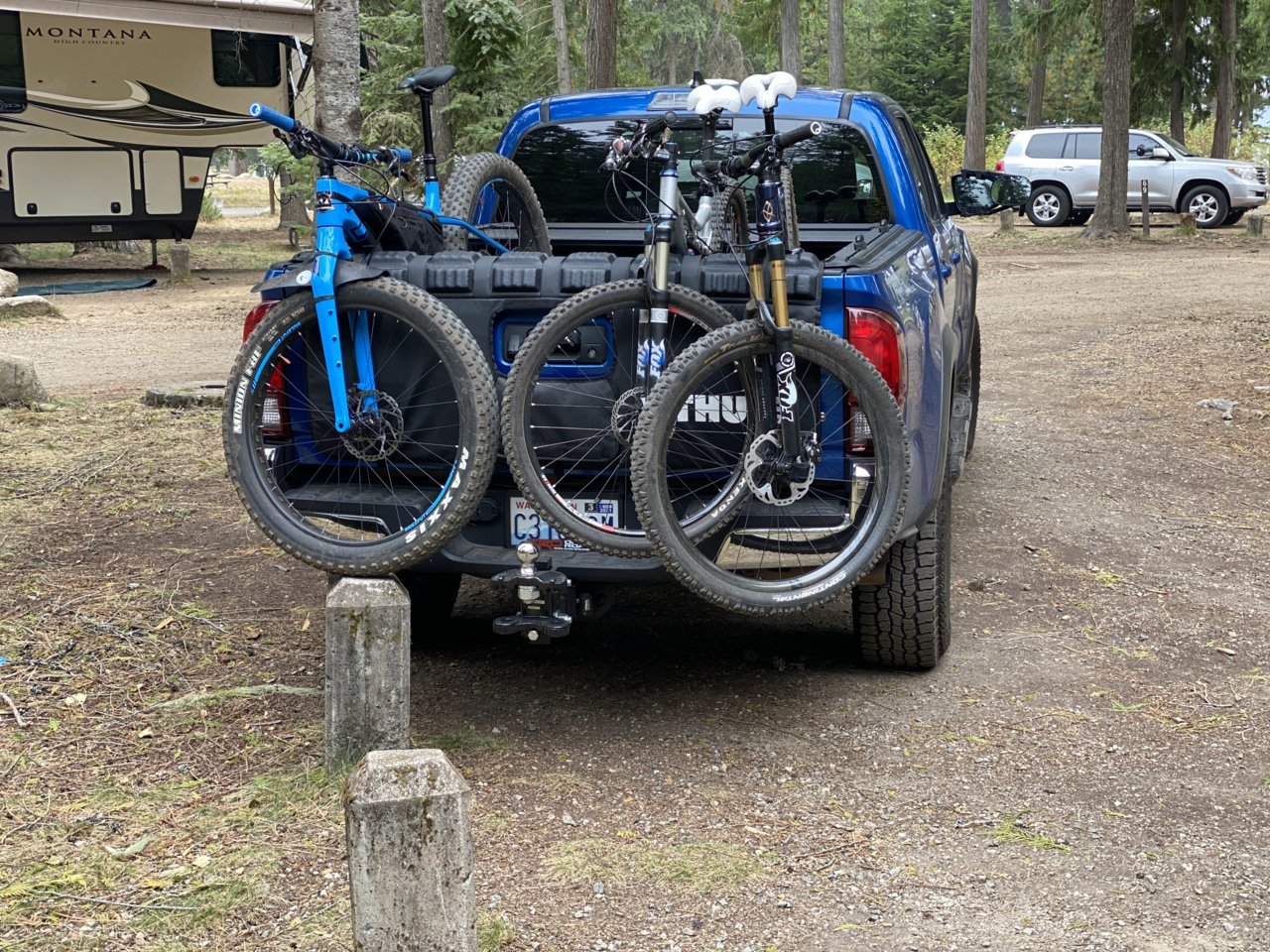

    My payload is my wife son and I. We weigh 433 lbs total. I am the largest at 6’1” and 187. 3 MTB bikes at 25 lbs max each (all carbon fiber. My wife and I used to race extensively). Empty water and waste tanks. Food couple of camp chairs. We don’t carry a lot of crap.
    have towed before the Roadmaster and the tune. Get both no questions. Truck is more stable with springs and pulls way better with the tune.
    Take your time keep it at 65 or less. Make sure tires all aired up. Common sense. Look farther down the road.
    I am totally comfortable towing it. It does take a few trips to get the feel of the combo. Going over Lookout Pass next summer and have no worries.
    PM me and I will give you my cell number if you want to know more.

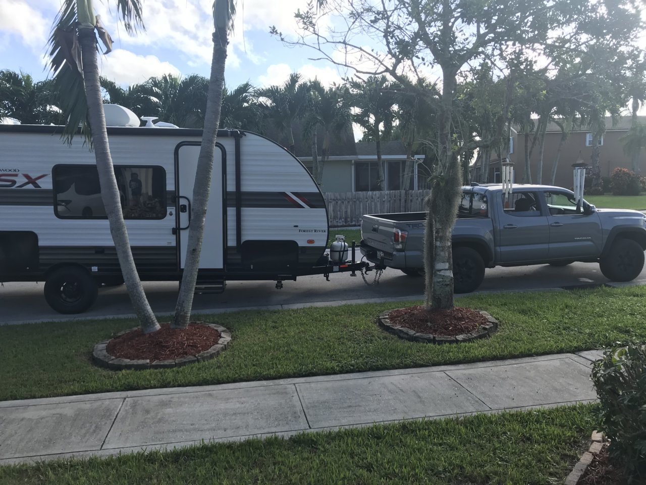

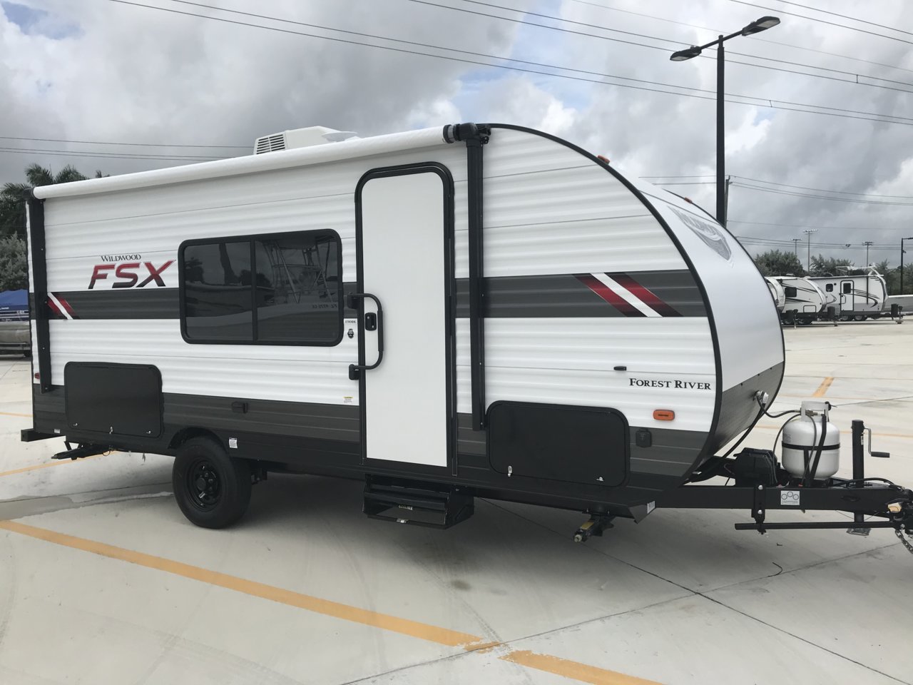

    4193632F-996A-4E03-A11D-CDF67C0C635E.jpg 9C40007D-2632-4A80-BD24-2C659E10AF70.jpg I have a 2019 Trd 4x4.Added a weight distribution bar and a brake controller. I pull a flagstaff that’s probably about 5000 pounds. I have been the mountains in N Georgia multiple times. The truck pulls great. Accelerates fine, and gets decent gas mileage 9, to 13.
