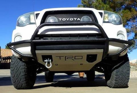

    If you absolutely want to be prepared to help a friend or family member out though, get a couple d-shackles, and a hook-less strap
    NOT THIS
    This instead...
    Hook it to a d-shackle on your truck's captive hoop up front or a hitch-receiver D-shackle

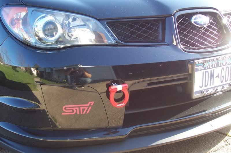

    As far as hooking to their vehicle.... good luck. Most cars don't have an accessible tow point, and you're likely to damage their suspension if you go to a control arm or strut. Only pull from established spots on a truck or SUV... stay away from even trying to do this with a car unless it has a hook exposed (like this).
    If they have a tow hook, they're likely not the ones you're going to be pulling out anyway lol.
