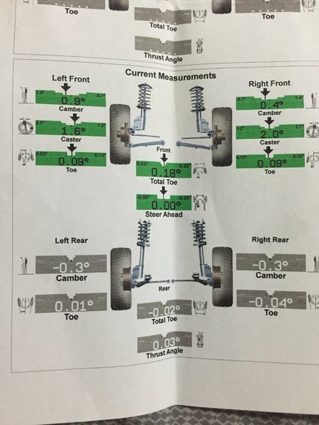

    This is what I was given when I left the first time.

    It's your camber. If you look at the top ones, while they are "green", you can see both tires would be pointed to the left, making you pull right.

    Looks like your guy put the effort in, and your numbers are pretty good. Nothing obvious to me that would make it pull right. Is it bad, or fairly subtle? Mine pulls just enough that I have to keep pressure on it with my left hand while driving.

    They can do better; bring camber down and caster up. Especially with aftermarket UCAs.

    I would try to get them to bring the left tire closer to 0.0, and the right can be left where it's at. Mine is .9 left and .8 right and I pull to the right myself. Also, ask them to adjust your caster up 1 degree. You can do that yourself if you want with the LR UCA instructions.

    Agreed. That's a sad job of properly aligning a vehicle that has every adjustment possible. Tell them to bring camber and toe closet to 0 and caster to 3.
