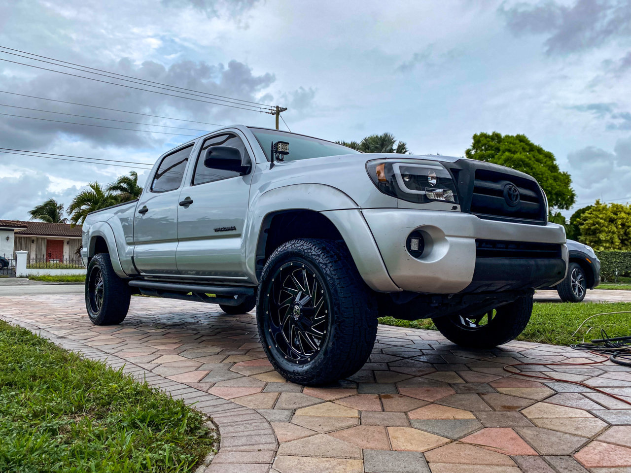

    My Tacoma gurus. I need you now more than ever. I have a 2006 Tacoma 4x4 double cab. I’m having serious issues with it pulling to the right. It starts off as a little but then gets progressively worse as I go faster. It also gets worse when I brake and the even worse the harder I brake. I also have a knocking noise whenever I back up when I’m parked. For example, when I pull out of my driveway, I’ll hear one knock from underneath the cab and that’s it. And it’s always when I reverse after being in park. Now here’s the list of things that I have done to try and fix the issue.
    - New rack and pinion
    - New cv axles (they were broken)
    - Replaced a worn steering shaft that was making a knocking noise on the inside but that’s gone now after I replaced it.
    - Countless alignments and balancing
    - New Hubs
    - a small spacer for the drive axle to help with driveline vibrations
    Now I have the truck on a 2” leveling kit with 30” tires on 20” rims. (I didn’t get to choose) I don’t drive like a lunatic and I haven’t taken this thing Offroad in years. So can someone please help me on finding the issue with my truck.
