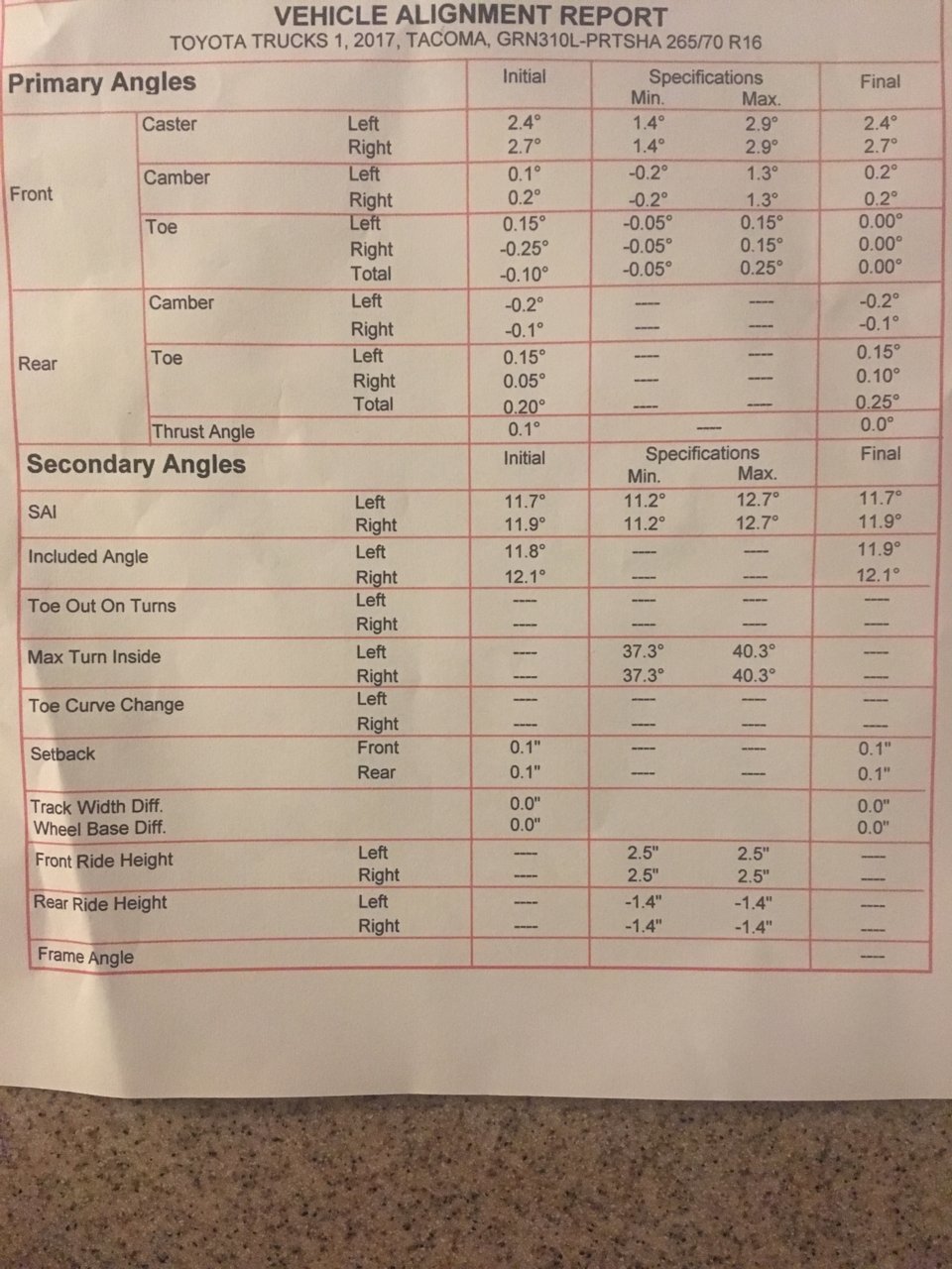

    Hey everyone. My truck keeps pulling to the right. This is more then the crown in the road. Here are the details. Help if you can! Thanks.
    - happens on 3 different sets of tires
    - rotated tires many times
    - 4 alignments and still not fixed
    - tire pressure is good
    - checked by 3 shops and they can’t find issues with shocks, tires, front end etc....
    - Turning to the left seems hard, turning to the right seems easier.

    Is your rear axle in alignment with the truck?

    Agree rear axle tracking, share a print out.
    Also have the tires only rotated front to back? or side to side?

    Posting your last alignment numbers will let some of the sharper eyes see if anything looks whack with those.

    Get the alignment shop to try more caster split

    It could be the passenger caliper is sticking and pulling to the right. Typical condition for rubbing caliper.
    Raise the front and check for rubbing noise while spinning wheel.

    Instead of positive camber, as it shows on your alignment sheet, make it a tad negative camber.
