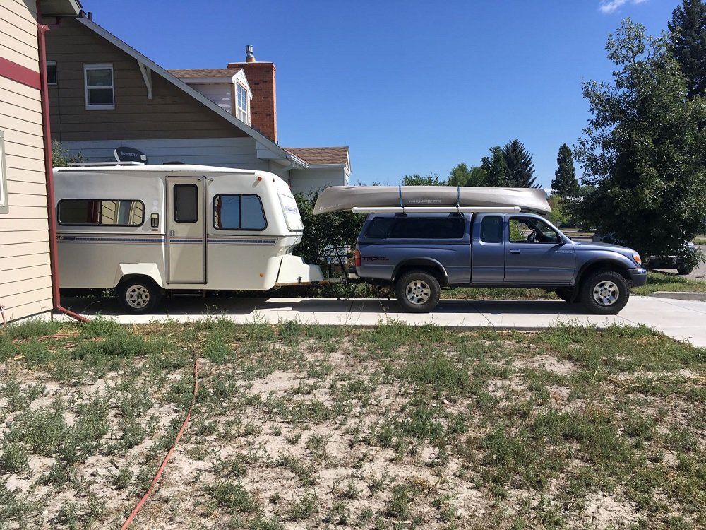

    I don't know your transmission, or how you've treated the truck, but I know with my 3.4 MT, I started pulling a 3,000lb trailer when it had 200,000 miles. Still pulling that trailer at 325,000 miles, and the tranny is holding up. In fact it's still got the original clutch. So the mileage it not necessarily an issue. But I don't know anything about ATs. I've definitely shortened the life of my truck by pulling this trailer, but it's surprisingly been up to the job.

    3. The AT in the 1st gen is pathetic. I tried a DC up a steep grade no trailer once. It was the I knew a DC was not an option for me. The 5 sp pulls a small camper great.
    4. If you love the truck and have gotten that much out of it, replace the tranny, read the towing Bible and gear crushers AT thread, and resume loving your truck.:)
    Edit: holy crap I just realized you have a 4 banger. I got confused by another posters pic.
    Get a tow truck, or a truck that can tow.
    Not sure how many HP your SC adds or if you have all the fuel pump/trims and pulley mods. But betwewn that and I heavy load or over drive or both, it is likely your AT has essentially become the equivalent of a fuse in your powertrain, especially if that model AT is matched to 4 banger output.
