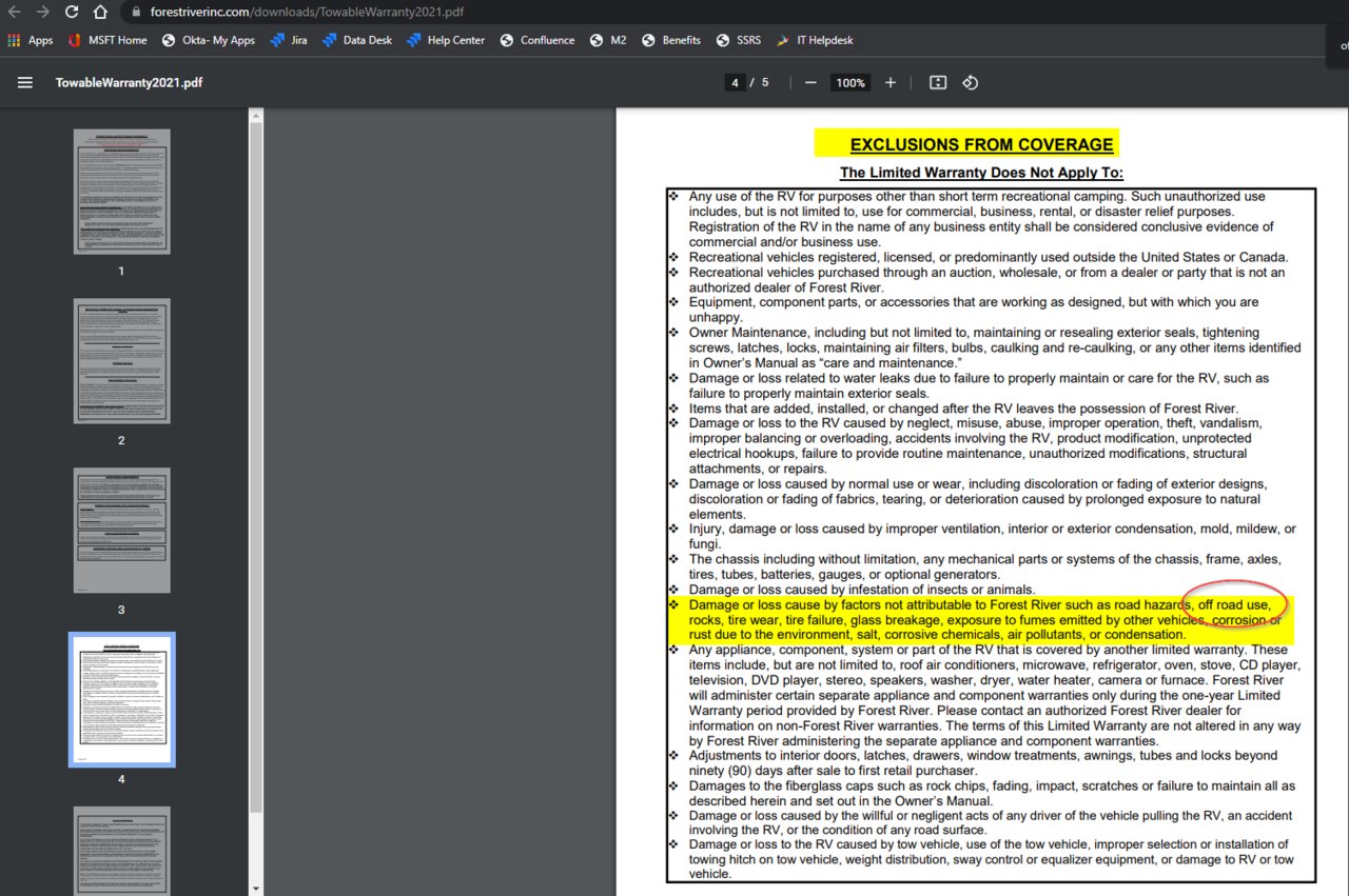

    • Be wary of the language sales people use... they'll say "Check out these off-road tires!" and "Look at this off-road themed trailer!" they are very careful with their language because some manufacturers do not warranty ANY off road related damages (even Forest River's IBEX line). This is probably not an issue for you since it doesn't sound like you will be doing anything serious (gravel road, hard pack dirt, and pavement). This isn't to poo poo Forest River or any other manufacturer - it is just something to be aware of. Sales staff in many YouTube videos call many trailers "Off Road" when they were not engineered for that purpose and are not warrantied for that use. If you want to really know what is off-road check what the manufacturer is willing to cover in their warranty documentation (again nothing against Forest River - they have a variety of models across a bunch of different segments that may be perfect for you.. just something to think about). Source document.

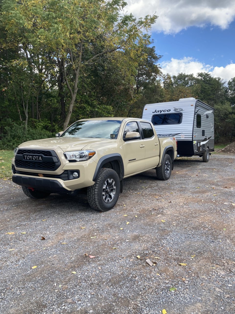

    Very happy with the Jayco 154BH. Weight is around 3000lb fully loaded. IMO I wouldn’t go any heavier.

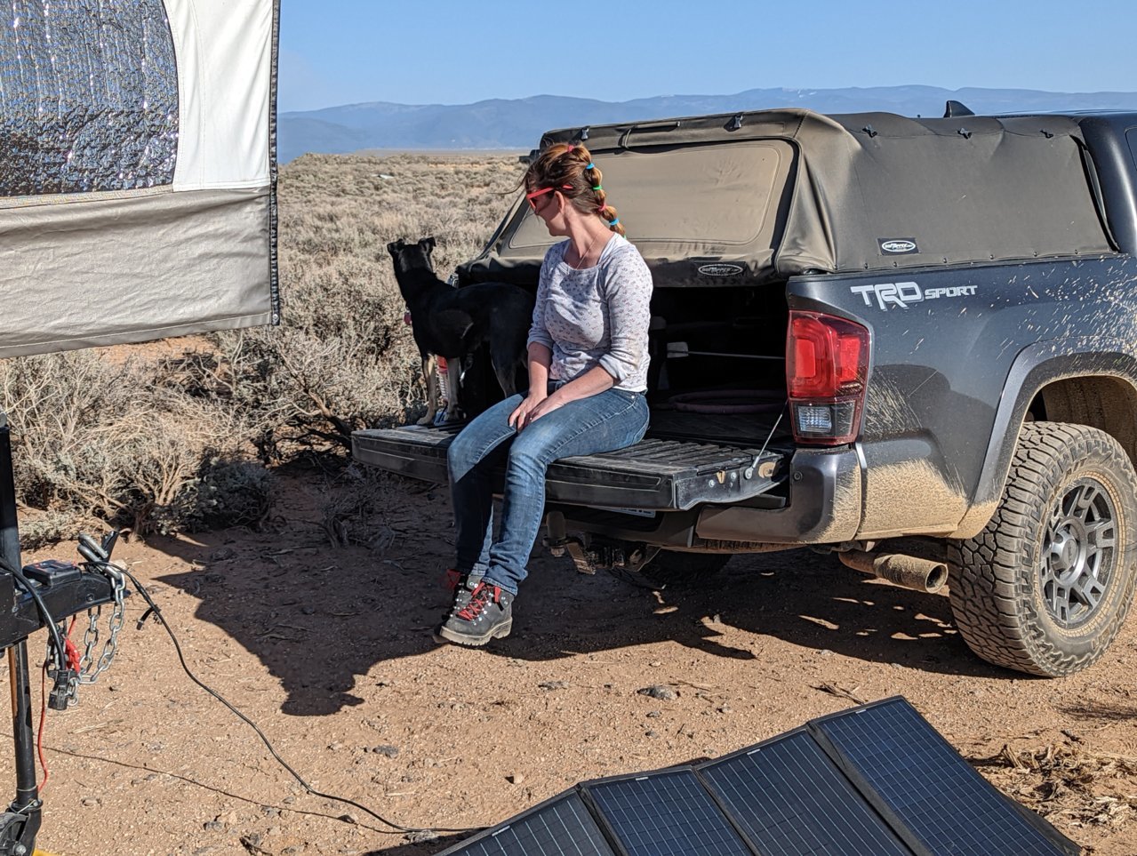

    120W Eco Worthy folding solar briefcase and controller: $170
    - I chose portable panels because I occasionally park under the trees and it's easy to run an extension cord to a sunny patch. Plus it's easier all-around to wire, clean, and store. :anonymous: A full day of 120W charging seems to replenish three days of moderate consumption. One of these days I'm going to upgrade it to a 200W panel, because they rapidly degrade under shade or cloud cover.

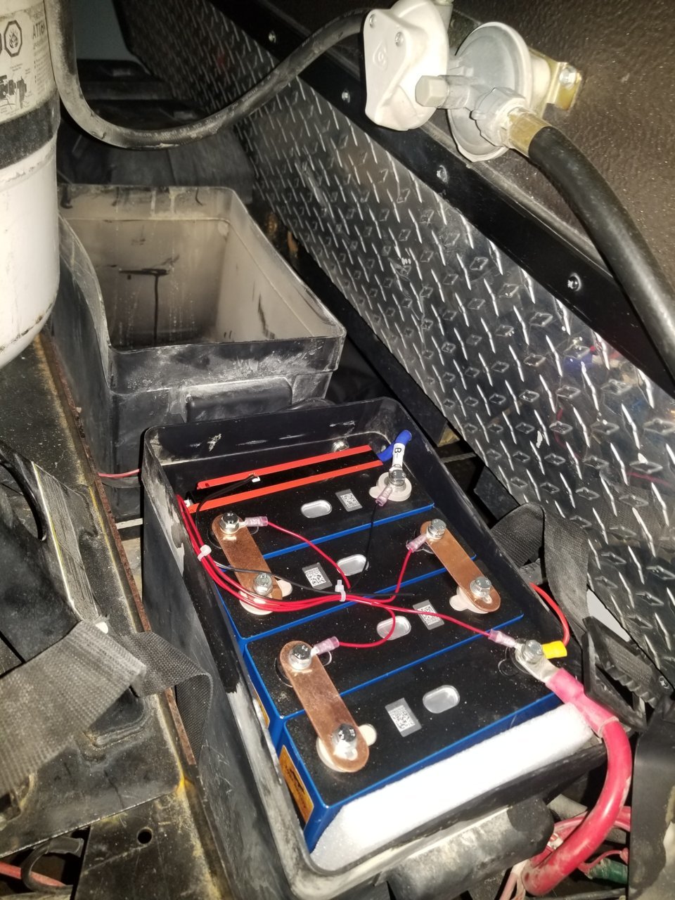

    Lynx 120Ah LiFePO4 battery with built in management: $750.
    -shockingly expensive, but considering that it reduced my tongue weight from 110 pounds of battery bank down to 20, it was so worth it.

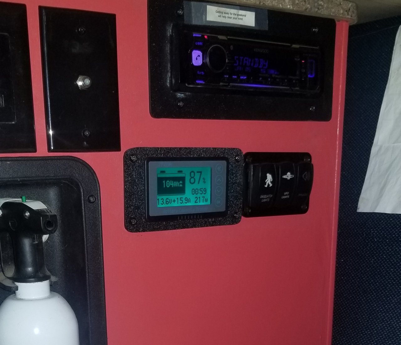

    AiLi Monitor: $70
    -I originally started with a $15 Mictuning but quickly discovered that you get what you pay for. This Renogy clone does a much better job at calculating capacity.

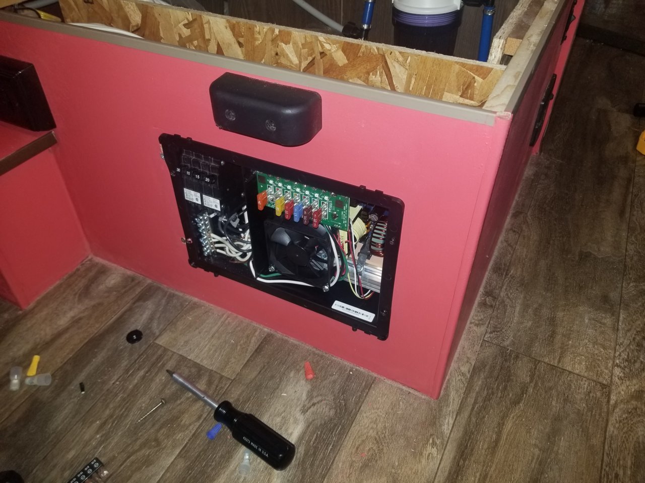

    Progressive Dynamics 30A power center: $130
    -This is optional and has nothing to do with solar, but I felt that if I was still going to occasionally hook up to AC shore power, then I wanted a volt converter/charger that was lithium friendly.

    The power center will convert shore power to DC, but will not invert battery power to AC. I could add an inverter to the system, but my only two AC appliances are the Air-con and a cheap coffeemaker. Everything else is DC. (And I prefer my stovetop percolator to my Mr. coffee anyway.)
