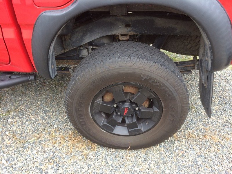

    Just went out with a tape measure and it looks pretty close.
    Drivers side.
    9959250C-A7E0-41E0-A2FC-6316BFFBD0DC_zps_6e618658ac8c7e394582aeef40ceb96de0f0cd42.jpg
    Passenger side.
    B7F6DE39-41ED-4C70-823B-A03DED698165_zps_09e6ea4f00653bbd85feac186b4fcf37541ed78e.jpg
    So there are some axle housings with more than one centering hole?
    Thanks.

    In those pics it looks like the passenger side is closer to the rear mud flap than the drivers side???? May just be the angle of the picture???

    It does look like it in the pics. I will verify it in the morning. Thanks.

    Man, I think you might be right. Just went out and did some rough measurements while it was raining only a little bit. It looks like the passenger side axle is farther back than the drivers. Wouldn't that make it pull to the right instead of the left?
    Has anyone else seen a first gen tacoma 8" rear axle with more than one centering hole on the spring perch? I'm gonna drop the axle on Friday (my soonest available time), just curious if others have seen it.
