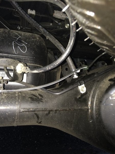

    The black hose coming from the diff is the differential breather mod. Thats where the water can get in..
    In a stock set up you would have a 1 way valve or nipple, but it can still suck water in.
