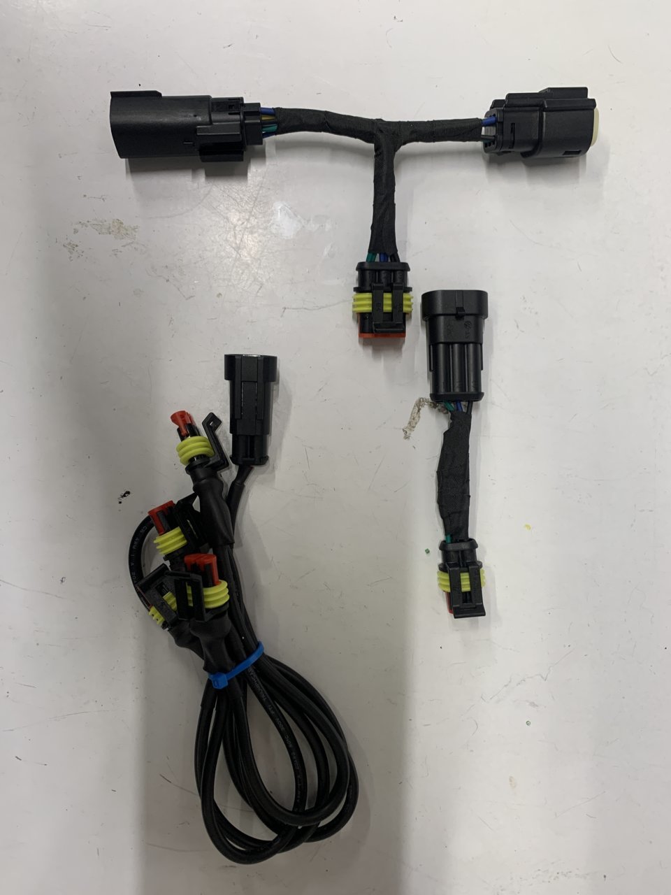

    Project #1. (Made for @mwrood who is the brave tester for this one)
    First up, I made a prototype of a raptor light tap for OEM LED headlights.
    I took kind of a modular approach here. There is the tee itself, which is a male and female Molex MX150. It will go in between the headlight and the OEM plug. It has a 3 port plug on it coming off the side. That plug has DRL, Park, and Ground. There is a also a 3M>2f little plug as well. This plug has 2 3A diodes (one on the DRL, one on the Park) and the DRL and Park are then combined after those diodes. This then allows the grille lights to be on with the DRL and the parking lights, but be able to be turned off when neither of them is on. And the final piece is just a harness for the grille lights. The nice thing about the modular approach is that I can swap the 3>2 for another module that will act the same as far as the lights being on, but they will be on full brightness with the DRL, and dimmed (the dimming is adjustable) when the parking lights are on. I can also make the headlight tap for TRD’s and TRD to OEM conversion harnesses. So there are a lot of options. I am also working on a way to do it for the SR/SR5, but it gets complex (and pricey) fast. Another nice thing about a modular approach is I hope to be able to adapt these easily to whatever @MESO has coming with his V5 mirror turn signals.
    Sorry about it being long winded. I suck at explaining things, and I kind of think as I type. But hopefully this thread will serve to let people see some new possibilities, or at least a new twist on some existing mods. Thanks for reading, and there will be more coming...

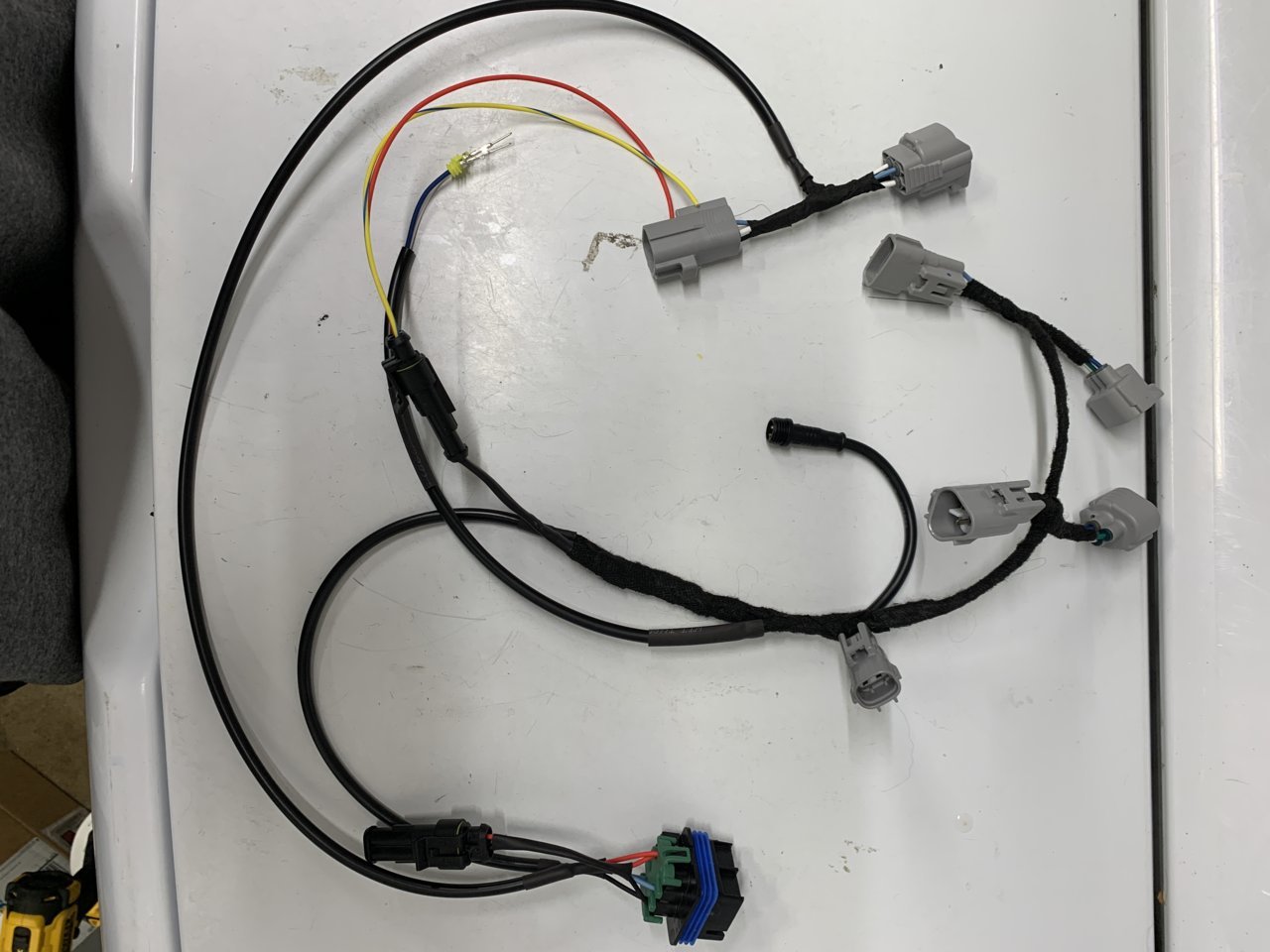

    And here was this weekends other project
    Project #2.1 (made for @5nahalf )
    calling this 2.1 as it isn’t finished, so I’ll concentrate on the back half. For this one, I started with another @MESO idea as 5nahalf has total tails already. So I began by building them from scratch. The drivers side is the most complex. 5nahalf wanted to be able to use his reverse lights as scene lights and be able to turn them on anytime. So there are diodes on the OEM supply side of those bulbs and an added tap post diode so he can wire in a switched 12v+ source to turn the bulbs on whenever he wants. He also wants to be able to use the turn signal for strobe lights, so I did the same thing there, but put diodes on both the turn signal and the strobe input so neither backfeed each other. And 5nahalf also had a brake tap he uses for a 3rd brake light, so I incorporated that as well (the blue and white wires). And while I was doing all this, I figured might as well as hook him up with a DIR and a reverse tap in case he ever wants to add a bright reverse light (and if he does, I know just the guy who will sell him one @memario1214 ). The passengers side is a little simpler. It just has the inputs for the strobe signal and the reverse light anytime switch. There will be more for the strobes on the front end, but that will wait for 2.2 as I ran out of diodes...

    That is a solid nightmare of a wire mess
