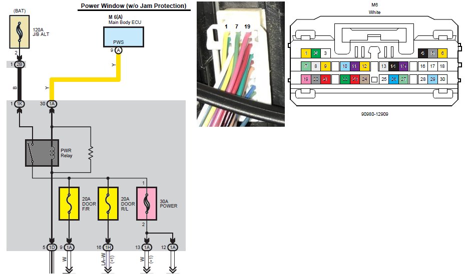

    For 3., as I am catching up on this thread, I would enjoy having power to the window switches. Ideally, any time the Taco is unlocked, but full time power would be work also as long as it wouldn't parasitically drain the battery. Am I nutz? I like the 30sec delay, but I have always wanted power windows to stay powered, just like crank windows. :D

    I wonder if you could try a DIY jumper from the back of the trailer brake controller where you already steal fused +12v to the pin where the window motors get their juice (would probably need Caribe to help identify the connector and terminal inside the driver's kick panel but you could also just start disconnecting things till something works and/or if you have OEM tailgate lock then it's probably the same connector in the kick for lock and windows? Also probably 14 or 16 gauge, larger than the signal wires.

    Doable, but :crazy:

    I don't have the TG lock, yet. I keep thinking about it.

    Lock is not the same as window up/down:burp:

    So, just jumping that relay would do it? Powering the low current side would be a parasitic drain?

    The yellow wire. The relay is soldered to the junction board attached to the Main Body ECU. And yes, you'd be adding a parasitic drain...:(

    Oh well. At least I can quite thinking about it.

    *in* the kick panel connector, *before* the connectors in the door, that's where I thought it _might_ be a common connector. Perhaps not though.

    You could still do it with something like a latching relay off the unlock pulse providing the current, then lock pulse disconnects?
