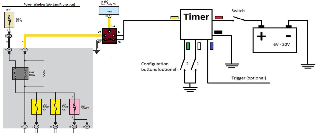

    I think that guy can take the lock/unlock pulse from the doors. Hence no need for additional UI which I think is my only sticking point.
    We'd have to get one and try to program it to see if it can be configured to extend power for 8h then shut off without needing an external normally closed relay. One assumes that should be within it's capability. So, reset with unlock pulse, 8h delayed power to windows, then just splice in motor power wherever needed, plug and play harness if we can get a connector somewhere? That's probably the hardest part, kick panel connectors are hard/impossible to source and going through the door boot for this is a little silly.

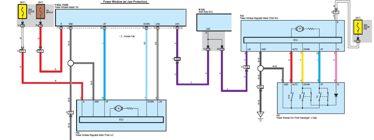

    Over-complicating David. Interrupt the yellow wire...

    If you're interested, I'd definitely pay up for the relay.

    It'd definitely be worth playing with to see what it can do. I'll throw one in my cart, no need for $ till I know what I can get it to do.

    On the Tacoma with the Anti-Jam feature the yellow wire only provides power to the rear windows.

    Anti-Jam has hot fused source to the window switches, but the anti-jam feature is handled by the Main Body ECU.
