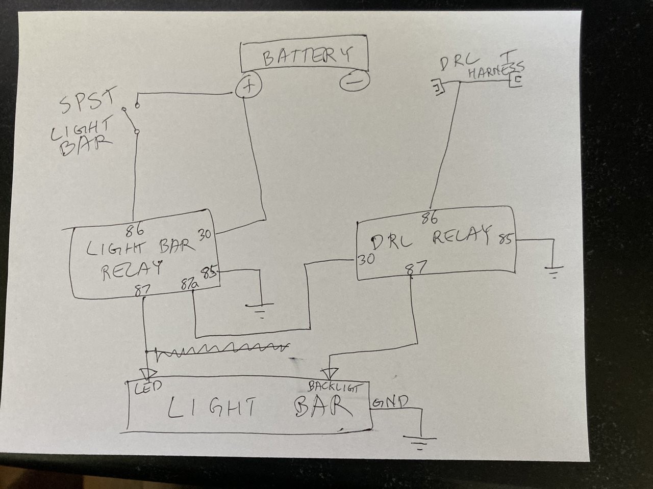

    @ljh824 has a 20" Rough Country light bar he wants to hook up to the DRL circuit to supply the backlight.
    20" Rough Country light bar doc
    @Puppypunter got any thoughts on this? He'd use a SPST switch for the light bar itself, ditch the 3 way switch, but I'm thinking we may need to employ one or two extra relays to ensure it's either DRL or light bar but not both at the same time? The 3 way switch seems to only provide one feed at any time, though I'm not sure from the diagram if it's power switched or ground switched. Looks like it already has the relays so that part is nice. Any ideas on how to simplify the final setup so he can just plug in a switch to green JAE connector and he's good to go?

    We can convert it to a SPST. That switch could turn it on anytime, and when it’s “off” the backlight would come on if the DRL is on. We would need two relays though. One NO/NC and one NO. Could fit it all in a small package with a few plug and play harnesses. Would need a 12V+ supply from a battery or fuse block though. That assumes the switching is positive. If it’s negative, I think it could still be done as well, but I’d want to sit down and sketch it out to make sure I am not missing something.

    That’s sort of where I’m at. Seems nuts to add relays to fire the relays. Maybe one relay from the light bar switch which feeds two things. One being the light bar itself and the second being the power to the backlight relay which is switched off the DRL signal. Maybe that’s what you are thinking?
    @ljh824 I think maybe just send me the wiring harness and I’ll dress it up for you with JAE connector for the switch and a DRL T harness? Let me know how long of a feed for each arm. I can test it out and send it back to you ready for action.
    Maybe I can do bullet connectors for the switch so you can fish it through the firewall easier? Fitting a green JAE connector through a rubber boot will be annoying.

    I think he wants it DRL only, not DRL or Parking Light, but that part I figure I can handle at the T tap if needed.
    I was thinking two relays.
    First relay fed from the switch, positive output.
    Feed that positive to the LED light bar as LED signal, ground light bar to frame. But then, use the 87A from that same relay to feed power to the DRL relay, switched off DRL output from the T harness.
    That way, if switch off, relay goes to normally open position which connects 87a to power, allowing the DRL relay to receive power and function but only if the DRL is on.
    Yeah? I should draw it.

    Maybe I'm confusing the two guys asking for DRL relays. But, yeah, I know that part. I can handle that with diodes as mentioned and stuff, no trouble on that aspect. The question is, can this setup be done with 2 relays? Lemme try to draw it and you can tell me how my design doesn't work :)

    C11 tap with DRL and PARK wires bridged (with diodes)?

    Nope, juice to drl is part of headlights.

    Just need to identify my poles on the relays.

    Works? Or doesn’t work?

    Works

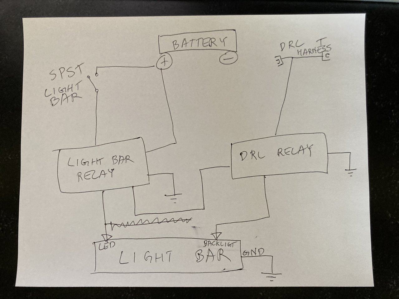

    You know.... Since we're tapping DRL anyway... Assuming we feed into the cab for the switch... We can get the illumination done too.
    I think I can build the entire harness, just don't know how the 3 wires connect into the light bar itself. This might be a fun project. I'll try to lay out out tonight.

    Yeah, this makes a ton of sense, just one wire through the firewall, very nice!
    Also I'm thinking of adding an H9 T harness and trigger the LED relay off that _or_ the switch (with diodes) so the LED's are auto-on with high beams _if_ the high beam T harness is connected (otherwise they wouldn't be). Seemed like a nice option.
    Johnny, the GEP mini relays are SPST right? And I need the 87a from the LED relay for my 2 relay setup so I can't go GEP here as I see it? Would be cool to have fuse + 2 relays in one sealed box with one mounting bolt but seems like inline fuse + 2x sealed relays works best (and would do 40amp vs only 30 for the minis?)

    You're not going to draw in the H9 connector feed to the lower relay 86 terminal w diodes?
    The sick part of this is that it'd use 4 diodes. That would be a record for me.
    Ahh, Lou says he'd prefer independent control. So the existing diagram I believe is the final final. I'm thinking simple bullet to connect the feed through the firewall and hook it up inside the cab so no need for a seal either.
